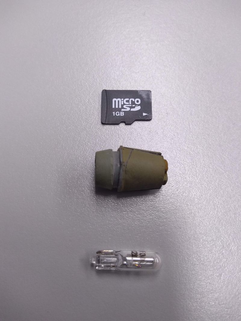

So after a little bit of trial and error I found the bulbs for the Stella speedomoter. It had T5 bulbs for lights.
I ordered these:
WLJH 6x T5 LED Wedge Bulbs
and these:
Partsam 10PCS T5 17 37 73 74 79 Wedge Instrument Panel LED Light Gauge Cluster Bulbs
Vespa P125X, Stella 2T

So here is a before picture

And here is the after

I also ordered this bulb for the always on low beam bulb:
http://www.autolumination.com/automotive-light-bulbs/gauges-instrument-panel/194_cree_xbd_5watt_1led_bulb.htm
and here is how it looks:

All in all it really brightened up the speedo and made it really easy to see.
I ordered these:
and these:
With these both being T5, what was the reason for purchasing both? Did you end up using both bulb types?
Yes. Both bulbs have a slightly different fit. The old rubber holdings are difficult to get a good fit.
The first bulbs shine in three directions, the second only shine on top. On my old rubber the three way shines were covered in the blinker signals.
