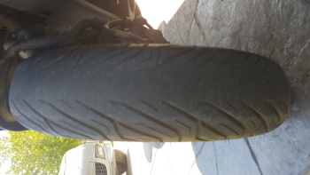

I felt my 500 driving funny and saw this.
The right tire is definitely not wearing properly, so is this indicative of an alignment/balancing issue or do I just need new tires?

Defintely looks like (very) abnormal wear, and possibly more than just an alignment issue based on looking at the top of the tire shown.
More like something is bent, and needs to be replaced before trying to have it aligned.

Do you remember hitting any big potholes, particularly on that side?
Could be a bent steering rod or a bent fork among a bunch of other suspect items.

I'd guess either a severely loose wheel bearing or a bent wheel support.
Try lifting that side by using your tiltlock with the bike leaning toward that wheel, and putting the scooter up on the centerstand.
I'm guessing you will be able to wobble the wheel in a way it shouldn't.

Check the wheel bearing Then if you have to do an alignment it is not hard to do to nor does it need any special tools.
Need a phillips screw driver, 12 mm wrench or socket, 3 mm allen wrench to remove fenders and a piece of chalk.
Oh and a jack to get the front wheels off the ground.
Jack up the front end and strap the handle bars straight as you can, doesn't have to be perfect. Take the chalk and spin the tire and get a chalk mark all the way around the center of the tire tread. Do this to both front tires.
Get something with a fine point and spin the tire and make a line in the chalk all the way around the tire as it spins.
Now the alignment just involves getting the lines on the tires so they are the same distance apart front and back of the tire using the spacers at the end of the tie rod ends. They are just thin washer you move to the inside or outside of the tie rod fitting.

I would venture a "Toe Out" misalignment. Could be due to loose bearing or bent tie-rod.

Excessive toe (either way) would affect both tyres evenly.
It's a small camber adjustment on that side that's needed, OR the wheel bearing isn't at 90° to the steering stem.

So here's my painful and expensive followup to the fixes for my MP3. I'm clueless in regards to explaining what the problem was as it sounded like Greek coming out of my mechanics mouth so I'll post the bill with all the parts required.
Total cost was $2600 with 13 hrs of labour charged. Ouch.
But that's not the end of it. When I took the bike in after waiting all of July for a part from Italy to arrive, upon picking it up my mechanic mentioned that the wobble was coming from a stone or foreign object that my wheel hub had picked up and had torn a groove into the front right tire which was new. He also indicated that I will be needing new ball joints in the near future, so more money to drop on a 12 year old bike.
So I'm driving it home and wouldn't ya know it, when at city speeds or slower, I'm still noticing a definite wobbling side to side from the front tires, so back I go, after the parts arrive, for front ball joint replacement.
Goodbye summer riding.

you mechanic did a steering tube bearing replacement on both and the center tube as well. also looks to replace 1 of the tubes as well.
check af1racing .com for parts
I think the labor was a bit high but that is probably BOOK time.
