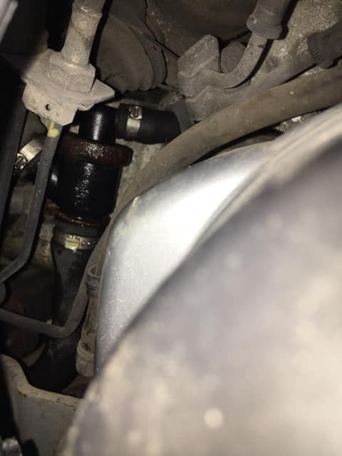

Can anyone identify this leaking plastic fitting? Left side of the engine close to the center stand.
Looks like a coolant fitting but I wasn't able to find it on the parts diagram.

Most likely its your thermostat that needs replacing

isn't the thermostat on the top of the engine under the bleed fitting? Or is this the actual thermostat?

Aha! It is the thermostat!
https://www.youtube.com/watch?v=esnwNNLe5Qo
Now to find it one the parts diagram and find a part number.

OEM Aprilia External Thermostat -#848140
