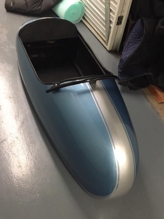

I've got a 1964 VBB which had been going through a full restoration. The company restoring it, is no longer in business, however I do have the repainted frame, head set, fender, steering column, cowl covers as well as a sidecar I wanted to add to the scoot. It looks like I will ultimately have to put the thing together on my own once I get the rebuilt motor, etc back from the storage unit it was kept.
Sidecar

Iíll second what greasy said about sidecar. Make that the last thing after youíve sorted out the bike.
That said - if you wanna post some pics of the sidecar frame - near wheel and at connection to frame - we can start to figure out if youíve got what you need and how it will be best set up.
Post them here and Iíll give you my $.02.
