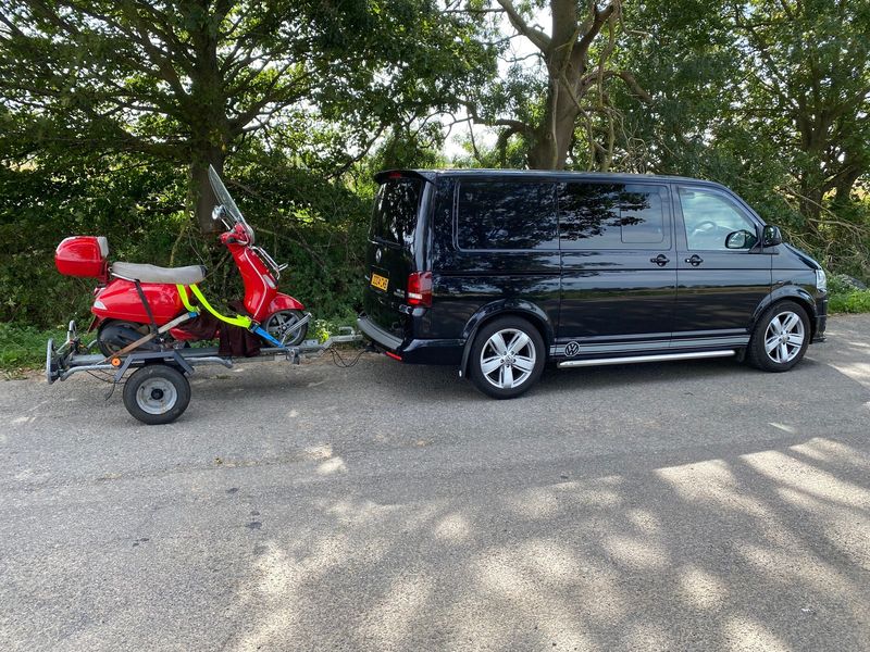

Hi All, picked up another Vespa LX project this weekend, my third Vespa since January - how addictive are these little things! It does not start and wants minor works but, all being well, I will get it going and my Son will swap it for his Kymco 50cc until he passes his driving test. I will, no doubt be asking for advice at some point, but pic below of new purchase for now.

Am jealous! i have a LX125 that is broken into bits because of the frame rotting out. Am on the hunt for a LX frame that i can transplant the engine into.

Nice project.
Advice is what we give best!
Have fun.
