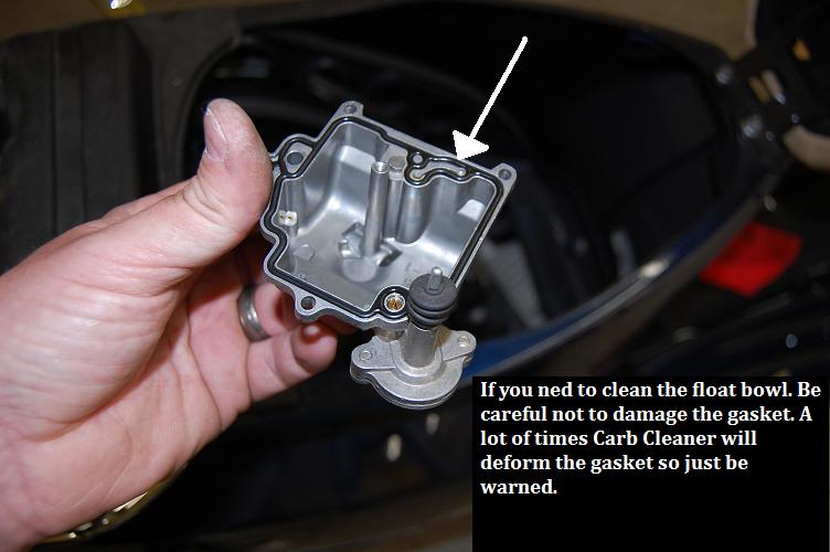

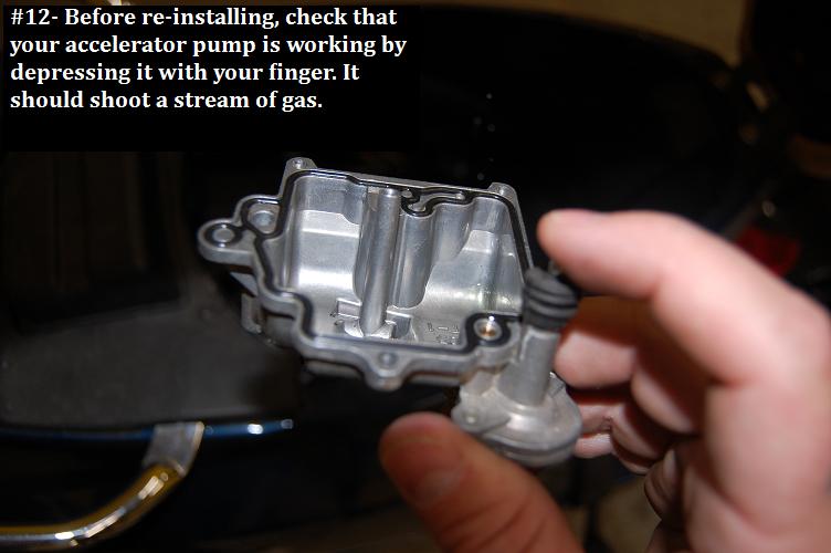

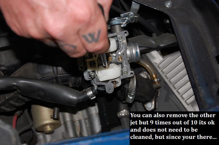

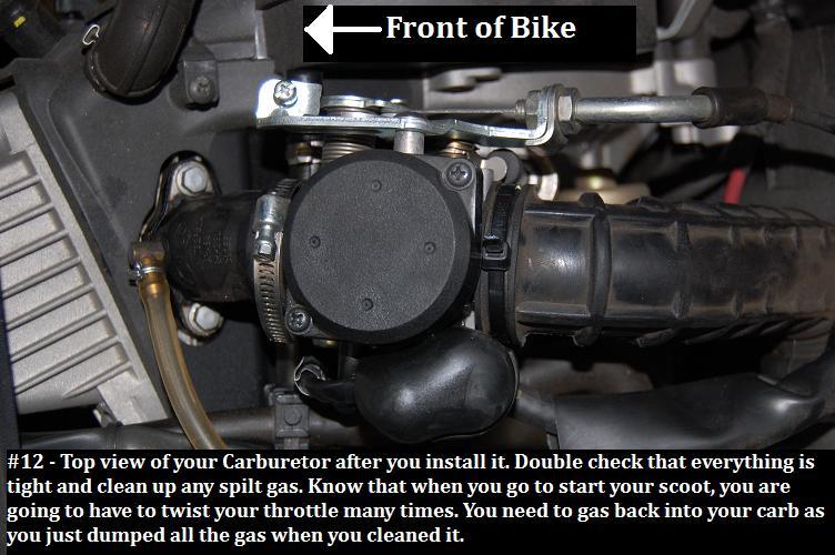

Heres a really quick way to clean your jets in the carb if you are having trouble. Know that if your scoot has been sitting for awhile ( 4 months or more) you will need fresh gas. Dont be intimidated. Here ya go!

Be aware that you will spill some gas when you remove the float bowl unless you put a rag under the carb to soak it up.

Jets
When screwing the jets back in, should they just be snug or really tight? Also, do any gaskets need to be replaced? Should battery be disconnected?
Thanks!
1948 Knucklehead Bobber, 1964 Triumph Chop, 2007 Vespa GTS, 1974 Primavera 200cc
Joined: 25 Nov 2008
Posts: 163
Location: Long Beach, CA
Mon Jun 13, 2011 12:29 am quote
When you are screwing the jets back in and it stops, just give it a secondary "make sure its tight" check. Dont try to put the gorilla paw on the jet, as it will strip. You dont need to disconect the battery and the float bowl gasket doesnt need to be replaced as long as it is not damaged.
