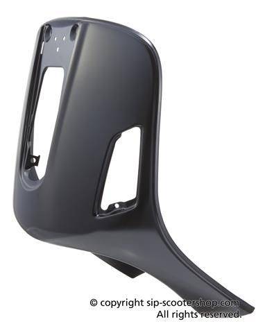

Here you go...

SaFiS wrote:
Oh wow so it has been done before. Thank you for this. My confidence level just went up.

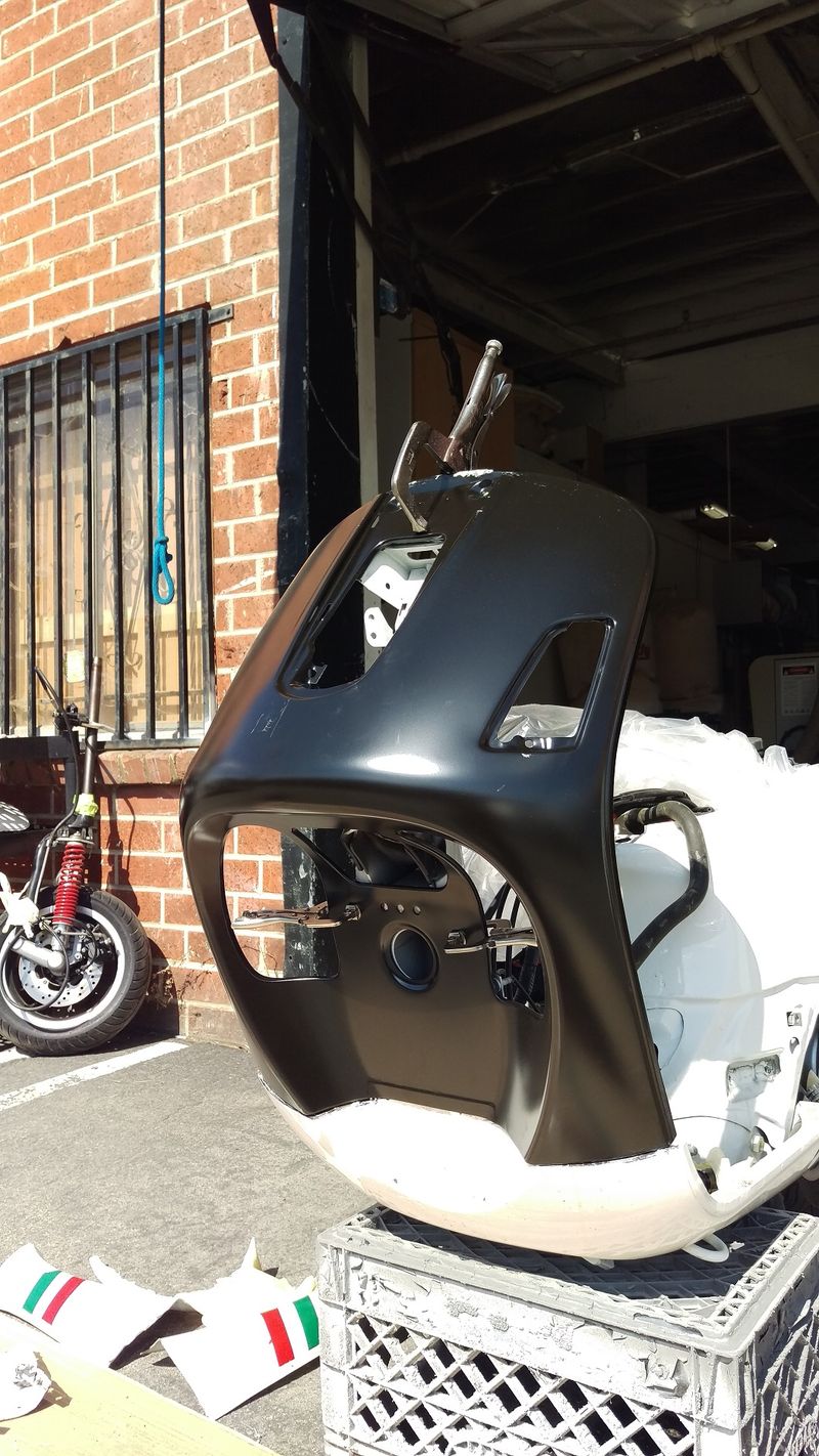

Sun Jan 26, 2020 3:56 pm quote
Here is some pictures. In the beginning i was like there is no way i can pull this off, but once I got going, there is no stopping me now. It is actually pretty fun process.

So finally got the leg-shield

Started welding
Waiting on longer tongs for the spot welder to reach deeper areas.
