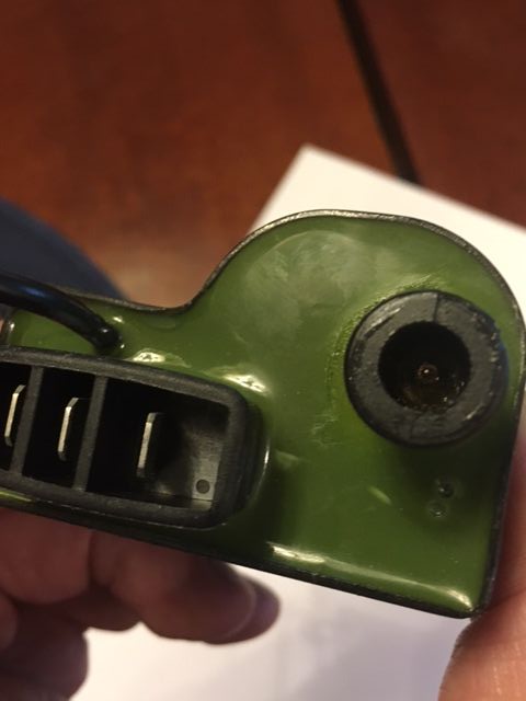

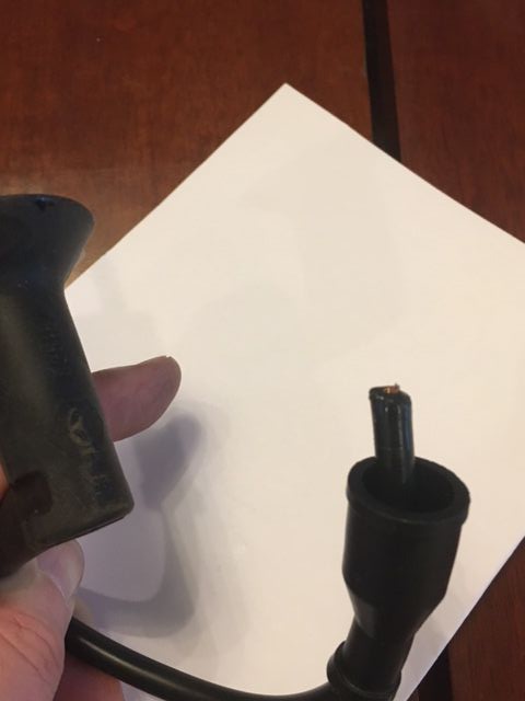

Novice here. I have this new to me 2002 Vespa ET with a no spark issue. I just ordered a CDI which I installed today, can't say that looking up the wires to the new CDI was the easiest think I've done. I tried to pull back the rubber sleeve to the wires so I could see they were going in. I took a pic of the CDI where the wires go in and the connection to the spark plug wire. I pulled the wire off the old CDI and it looks like it barely has any wire showing that is supposed to connect to the CDI box. The small rubber boot will hold it on but is this enough to make the electrical connection or am I missing something? I saw a pic online of another spark plug boot that looks like it plugs into the CDI. Is this small wire exposed sufficient to do the trick? Thanks for any advice.

Screw the HT lead in
New to the forum and my first reply. Have seen similar on classic cars. The HT lead screws into the little pin you can see which in fact is a screw. The rubber boot then pushes on. A tiny bit of silicon grease or WD40 helps. Hope I have understood the question.

Thanks for the reply. I guess I can screw the HT wire in. It seems to bit a bit. I had to yank the wire out of the old CDI and just surprised that I look at the spark plug wire and see only a little exposed wire. I'll screw it on as tight as possible and put the rubber plug over it and hope it connects. I hope I go the other plugs to the CDI in sufficiently. It was very tight quarters to try to pull the boot back and line up the 3 wires while they were kind of flimsy. Thanks for the tip! Trying to clean the carb at the same time, all kinds of fun.

If there enough length on the HT coil wire, trim off a little bit where it used to screw into the CDI. You yanking it out certainly doesnt help. With the new rubber and hopefully the copper core, screw that into the new CDI.
If you still dont get a spark after the CDI swap, disconnect the white plastic harness/stator plug under the floorboards. Kickstart the scooter and see if you get spark. If you do, you have a short somewhere in the green wire. If you dont, gotta check your stator/ pickup.
