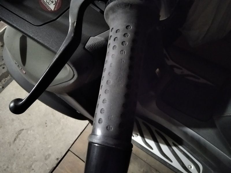

Hello friends. The rubber surface of steering handles is worn out. Handles OEM are equipped with heating system. The heating system is ok and works correctly. Is it possibly to buy only rubber part of the handles somewhere? Any ideas....

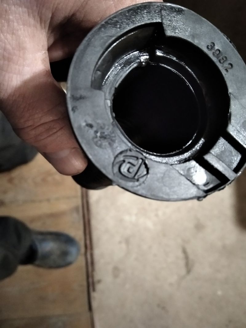

ТО Maksor: Thanks but no. I only want to replace the rubber parts. Heating system is functioning correctly. China-made grips don't appeal to me.
TO Sbaert: The rubber is not integrated with the heating element (photo). I only want to replace the rubber. Thanks but no.

I am very surprised at how quickly the grips wear out. The mileage is 16000 km. Probably they are now made from shit and sticks)). I have the standard grips. They are 7/8 "or 22mm in size. Right grip - 24mm. Heating system grips are 26mm on both sides. Length 125mm. Thank you all very much.

Excessive wearing could be coused by using od hand cream or some mineral oils and riding without gloves.

I don't use hand cream. I use gloves to drive the scooter. These handles are very soft. This is problem! I solve this problem .....

Grips Ariete 02624 \ LN have a diameter of 26mm. Length 125mm. OK. Price $ 25. (Foto1)
https://www.ebay.com/itm/ARIETE-02624-LN-Grip-Pair-BMW-Open-D-26-For-Multi-Controller-Navigator-/143674727768?_ul=BY
Before installing the grips, you need to make slots for the wires. (Foto2) Grips are much stiffer than OEM grips. Before installing, you need to apply a secret Russian lubricant. (foto3)
Now install the left grip. (Foto 4). Here is the result (Foto 5-6). The problem has been resolved. P.S. According to the old Russian custom, you need to drink the lubricant. Everything. No residue. Then the grips will last happily ever after.
