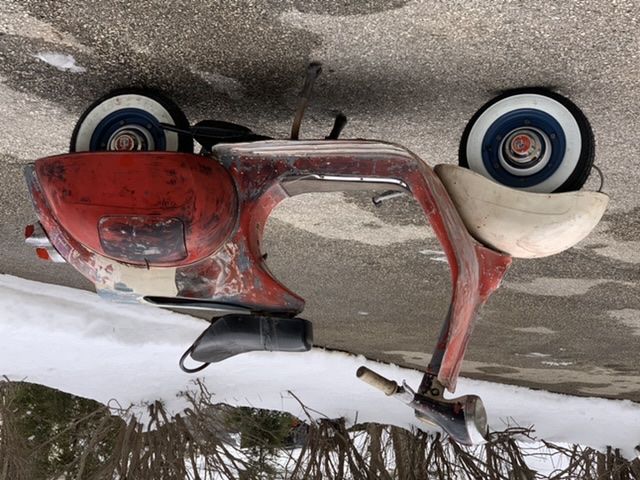

Hi I used the search and didn’t find anything about accessing the bulbs in my headset. I bought this bike in January. Didn’t think it had working electrics. I would like to understand the switch protocol too. I just discovered last night a very faint city? Bulb and bottom taillight bulb glowing when the switch position was all the way to the left. In the other 2 position I get no lights at all. I think both main headlight and brake light may be blown. Anyway how do I access the bulbs in the headlight assembly?
Thanks!
The bike is a ‘65 VBB 2T.

The chrome rim is held on by a screw at the bottom and fits into slots at the top of the headset.
Remove the screw, take off the rim, and the headlight assembly should come out.

Thank you both for the reply
Sorry for the the upside down pics
This new pic shows the underside of my headlight assembly.
I believe I see a city bulb and another centered bulb. Regarding the bottom; Is it turned and off center and unable to show where the screw heads are or is something else up with it? What do I have to remove to get the trim ring off? Thanks again.

Yeah it’s on cockeyed. Someone probably jammed it on. If it’s the original (with a “Siem” mark) be extra gentle. Replacements are available but they don’t make em quite like they used to.
