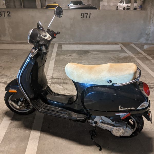

New to the forum and new to Vespa. Looks like there is a lot of good information and people in here. Just picked up a 2006 LX 150 with 419 miles on it. Drained the fuel, ordered a new battery, started cleaning the carb, removed the air filters (gooey mess). I hope to get it running again the coming days.
Any tips or tricks on getting a neglected scooter running again would be appreciated.

The date code shows the tires are from 2006, so I will definitely be getting new tires. I am considering 130/70R10 as replacements. Any thoughts on sticking with the stock tire size as opposed to the slightly bigger tires?
I dismantled and cleaned the carb really good (twice) and got the motor running. I can even get the idle down pretty low, but on the initial test drive the scooter maxed out around 40 mph and I think the belt is burning up.
I ordered a new belt, rollers, etc. to overhaul the transmission now as well.
Getting there slowly but surely.

Replaced all of the fuel and vacuum hoses, new belt and rollers, removed the extra gas overflow stuff and changed fluids. She was barely making it to 40 mph. I had to re-clean the carb one last time- this time I removed the black top, removed the main needle, cleaned the slide and diaphragm real well and made sure the lip was seated in the groove before buttoning it back up.
Good news, she is accelerating quicklynow and I got over 60mph before I backed off the throttle. With 425 miles on her now, I will be 'breaking in' this old 2006 now.
