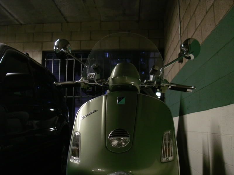

Enjoy!

That Looks Really Nice!!
Vespa should sell them that way!

OK Rex,
You got me. How do you like it? I've been wanting to replace mine. Looks really nice.

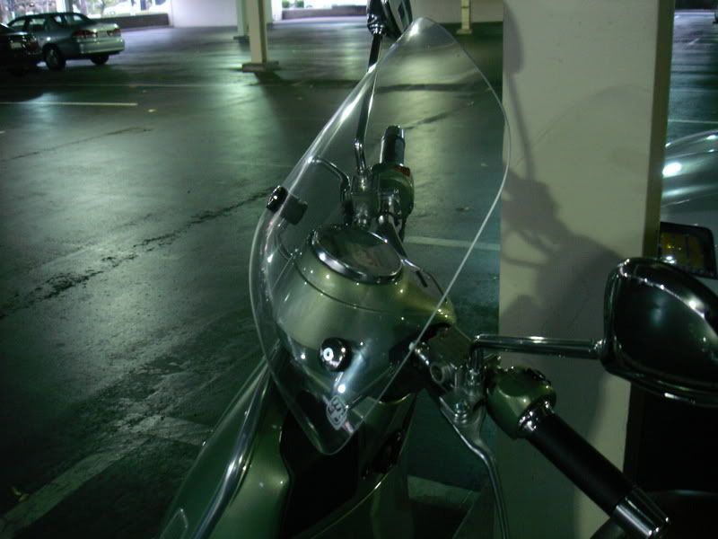

Yeah, it looks cool!
Okay, review. The original shield that comes with the GTV/GT60 is slightly thicker than this one. The rubber washer thingy that holds the shield isn't really made for this new screen (see illustration). Because of the height of this new screen and also because there's only two points that hold up this new screen in place, there's a little bit of rocking back and forth when riding at freeway speeds (which is usually noticeable beginning 50mph and above). You get used to it after a while. That's not a big issue for me. With this screen on, I don't have to fight against the wind. Do I like it? Yes. Do I recommend it? Yes!

It's a one piece and it shaped like um...a reel from a film projector.
Disclaimer. In real life, there isn't a gap unlike my illustration. My illustration is exagerated to show that new screen is slightly thinner than the original, which consequently has a lot of room in the rubber thingy to move around. and I'm not really a doctor, but I play one on TV.

doesnt that wobble like crazy at high speed?
i'd suggest something to brace against the screen to stop it snapping over time, especially if your a highway kinda guy
looks awesome compared to the cuppini one with a big black bit on it.
good job!

It wobbles, but not crazy enough to regret my purchase. It took me a few days to get used to it. I like the extra brace from the Cuppini brand (but I don't particularly like the shape and style of the Cuppini shield itself. To each his own. Thanks.

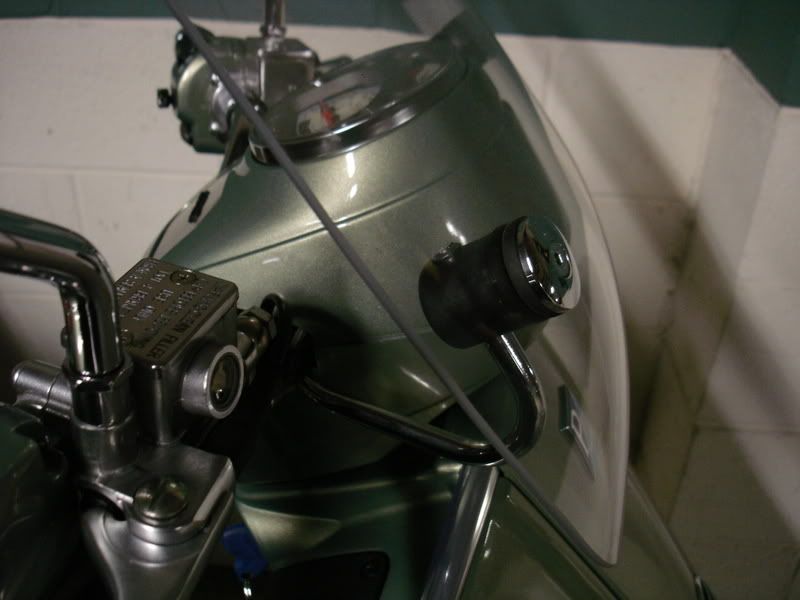

I'm still learning about posting photos, so sorry for the size and graininess.
I put a thin galvanized fender washer between the rubber and the outer chrome disc to stop the bobbing of the flyscreen at speed. I just happened to have a couple the right size. Seems to work well.

That windshield looks perfect on your GT60 Woodenhead. That is what the GT60/GTV should have come with in the first place.

I agree!!! +1 A+
