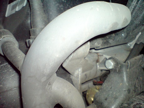

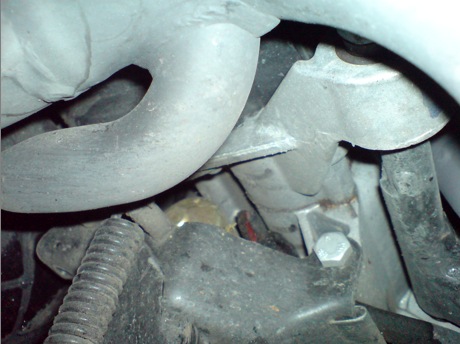

Derestricted my vespa S-50/LXS-50 (they call it LXS50 in Sweden).
It's a twostroke.
Regular stuff. Variator and i went from a 37 to a 44 jet. (Piaggio recommends 44 or 46 on derestricted bikes)
Does 60 om upslopes and downhill it flats out at around 72.
(No mods to the variator weights).
But there's no "Wall" the way i've experienced with other bikes.
Think my 2008 can do better before cutting the CDI.
The carb is already pretty big. It's a 17.5mm for a 50cc.
In my case i'm sure it's the exhaust. There's are differences in the exhaust system of the S-50 but none visable apart from that the shop claims there is no restriction plug in the exhaust. (Can anyone verify that?)
I have on the other hand found a big blind pipe from the exhaust
This i'm told by ten scooterguys to be a classic restriction thing. Showed them pics.
Spoke to an old friend who's an engineer and builds big bikes with what ever engien he can find, a turbos from a car or what ever is fun.. builds them from the ground up. Nothing is standard.
Didn't show him the bike or the picture but he told me that there was a big chance the pipe was a "selfresonation" pipe designed to attain more power and torque at low and midrange rpms.
I was on my way with the cutter and a blowtorch to get rid of the damn pipe 'til he told me that.
Regardless.. The shop derestriction left me with a bike that does 0.2L/km (2liters for 10km) 62 on flat ground and somewhere between 70 and 75 on a long slope and smells like an old petrolstation.
My guess is that it's the exhaust and i'm very sorry to say i've been looking and there are no performence exhausts on the market and no "welding stuff together" workaround.
But on the upside - with the new jet and fuel economy worse than a Ford Truck - it runs much cooler. Before i did de derestriction it you could stop and use it for grilling hotdogs on top of the exhaust. Would be extra crispy guaranteed and I was told that's the way it's supposed to be.
Well.. might take a while I will fool them back in the end.
Funny how Piaggio owns all the italian brands and you can make them go 120 without anything more than a screwdriver. With Vespas it's like a big conspiracy.
If there's a restriction in the pipe, the shop lied to me cause they sayed that was the big difference between the LX and the S model. Same pipe but they did the restriction some other way.. (ehm??)
Can't see why they would lie since they have no reason and very low social scills. If there is a restriction in the pipe where is it? The classic spot?
Anyone have a sollusion for a bigger exhaust taking us from 60 to 100 with just a carb change and some new weights?

In the EU 45 version of the twostroke there's a "plug" in the exhaust.
One that does 70 de-restricted can't have that issue, but the pipes all look the same on the LX and LXS/Vespa-S (basically the same bike but the Vespa S doesn't have a plug).
There's a "blindpipe" (sorry for my homemade translations) on my exhaust and those are on the LX125 too here in sweden. The LX125 is restricted to 11kw and it can produce a lot more than that.
There's another explanition where the pipe is not to cause turbulence and resistens but "egensvängning".. not sure of the english word for it.
It's a good thing since such a pipe brings more hp and torque at low and mid rpms.
Every hotrod teenager i've chatted with here in sweden and sent the photo has responded:
"Cut it of and weld the exhaust closed, then go for the catalysator and fuelreturn system.. those two should bring you atleast 10km/h and a lot more horsepowers"
I have some photos of the bottom of my bike but they were shot in the dark with just the flash so i couldn't aim properly so they're terrible.
I believe they have around four ways of slowing them down and the 45km/h limit is the most restricted.
Only way to find out is a trial by error..
Gentlemen - Bring out your cameras.
This is a the EU 45 regulation exhaust for the LX (Ok, it's my LXS but i've checked and it's the same on the outside.. need to start somewhere and carburators, jets and variators are the easy part with Vespa)
Would be great to see a completely no restriction "original" Italy och Greece sold LX exhaust.. but those guys aren't likely to read a thread called "de restrict".
This looks a bit comic but it's the same pipe from another angle.
The pipe. Between the cylinderport and the fuel return
