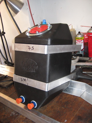

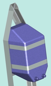

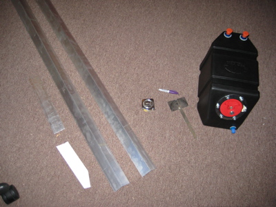

The materials have arrived and it's time to start making the mounting brackets for my 3 gallon fuel cell. It's going to sit vertically on the floorboards of the SYM HD200.
rendered tank and mounts
tank, pattern, and tools

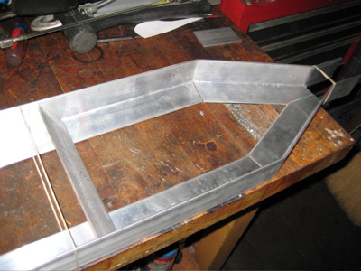

Got some of the bits cut and bent today. The first strap was a little two narrow after bending but the second fits perfect.
Hey VP1, what pump are you running? I'm going to try a diaphragm pump running off a vacuum line first. If that fails I'll go electric.

Almost ready to have it welded up. two more bits to cut for the top and bottom mount points.

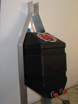

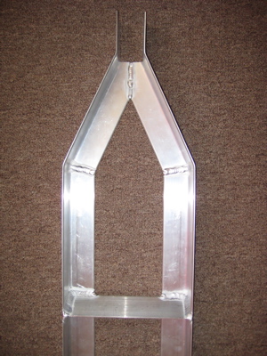

The frame for the fuel cell is all welded up. Next step is fitting it to the mounting brackets.

What, I cut the thing out with a hacksaw, bend it on the edge of my workbench, shape it with a hand file, and you don't think I can weld it with matches?
ok, had Weiss Welding (Folsom St between 8th and 9th st.) do it. Their work is incredible but they are a bit spendy.

Got the frame trimmed to fit and all the brackets cut and marked. Tomorrow I'll take it down to get the rest of the welding done.

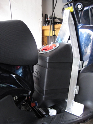

Here's the frame mostly finished and in position on the scoot. I need to trim the lower mount points a bit and drill the holes for the lower mounts still. Also need to finish the straps that go around the tank and will bolt to the tabs sticking out from the back of the frame.

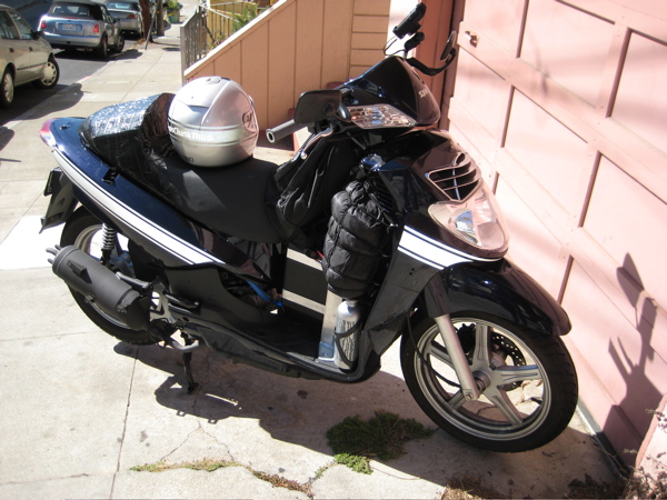

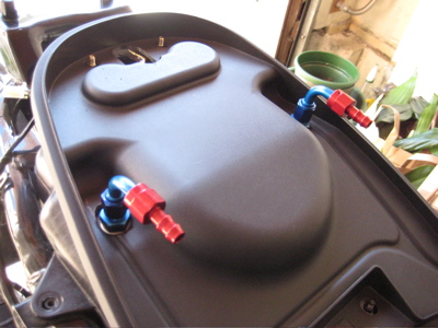

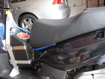

Done
Finished plumbing the tank this weekend. Tested it out with a gallon of fuel in the front tank. Only took a few minutes to pump it to the stock tank.

So how many gallons will that hold now?
The front tank holds 3 gallons, the stock holds 2, for 5 total. Maximum range 340 miles.

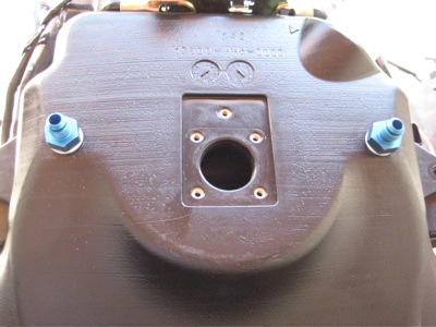

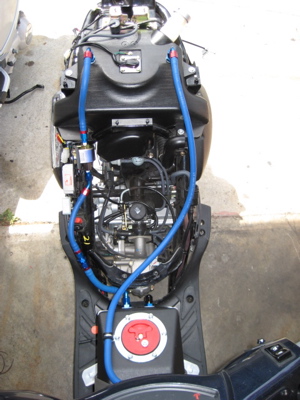

I just finished the mount for my Plan B gas tank, but don't have it plumbed yet. Going from AN-6 to 1/4" hose is harder than you'd think.
Jess, do you have any photos of your install yet?
Back to top
GTS250 GTS300
Joined: 11 Oct 2005
Posts: 22959
Reply with quote
Tue Aug 19, 2008 4:38 pm
2007GTS wrote:
jess wrote:
Nice work, Patrick.
A couple, although they're low-quality and badly compressed.
http://www.modernjess.com/cannonball/

Tue Aug 19, 2008 5:57 pm
Is that first image from SolidWorks?
Back to top
Sponsor
8:2
Joined: 11 Jan 2007
Posts: 4123
Reply with quote
Tue Aug 19, 2008 7:32 pm
It was done in Ashlar Argon
It was in my budget for the unstealth and I keep using it for just about everything.

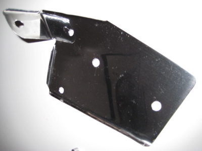

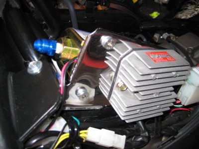

Sat Aug 23, 2008 3:17 pm
Here's the fuel pump bracket I made. Desided to use an electric fuel pump and only turn it on as needed to move fuel from the lower tank to the top tank.
