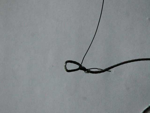

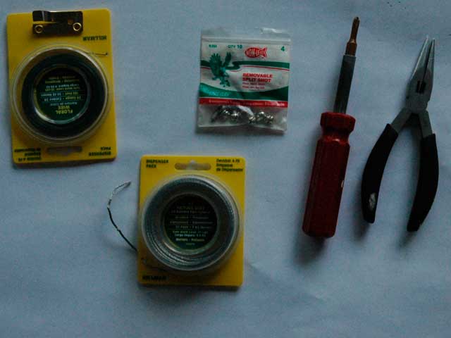

You’ll see all the things you need in picture one.
Screwdriver
Needle nose pliers
12# picture wire (not 21# as in the picture too big)
Small gauge wire
Fishing weights

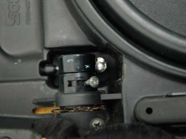

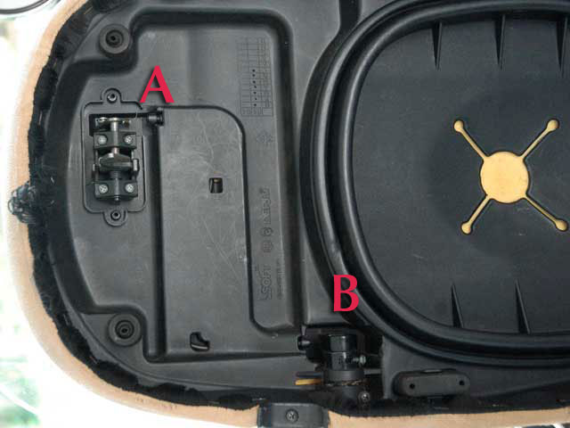

You can go that this from the top or bottom. But I found it easer to put the fishing weight on first and then run the wire up.

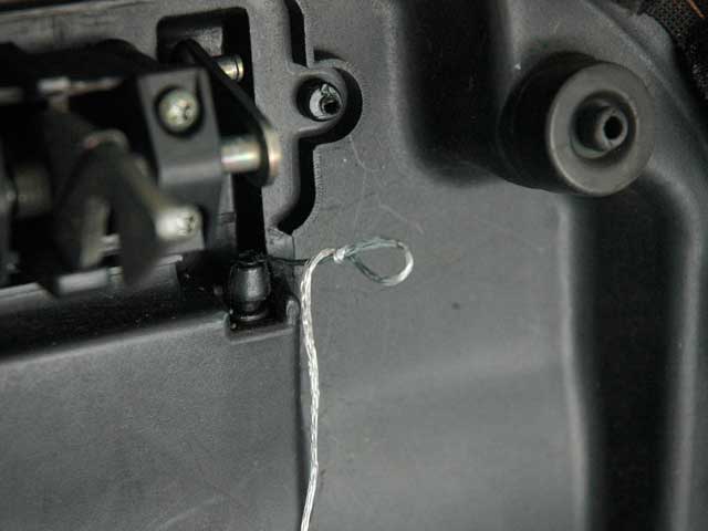

If you look at picture #2 you’ll see two points marked A and B. The wire runs thru a tube between those two. Remove the screw from B (the key hole) and remove the inner L shape piece that holds the end – the old wire will follow.
Cut a piece of the 12# picture wire cramp the fishing weigh and rethread it though until it comes the top of A.

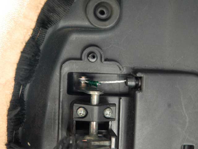

Replace the L shape piece and remember that the screw doesn’t go all the way down.

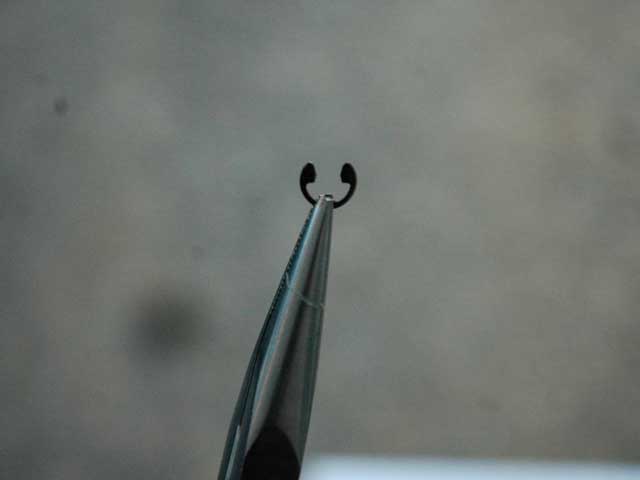

Next if you look at point A you’ll see what looks like a washer, it’s a circlip take the needle nose pliers and remove it. Now put this someplace safe (picture number 5).

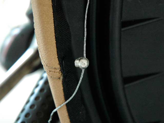

Remove the end of your old line and pull the wire tight and then loop over the pin sticking out. Next being careful not to undo your loop pull to the side and wrap with the small gauge wire around the 12# picture wire to make a secure end (clamp).*
Note if you look carefully you’ll see that there is a very small area of travel from the end of the “clamp” of the wire on the pin to the opening of the hole for the wire. So you don’t want to make your wrap to long or use to large of a metal clamp.
(But if you can find a metal clamp that will work let me know. I looked and could not.)
Now test the lock to make sure that everything is working a couple of times before closing and you’re done.
*I like to leave a good bit hanging on one side then wrap it around the left side of the loop of the 12# wire then the right side of the 12# wire and then holding the hang over close to the 12# wire wrapping it down about a quarter of an inch. Then take the needle nose pliers wrap the two pieces of the fine gauge together and cut as close as possible,

points A and B
fishing weight
screw
circlip
loop
wire tie
A very small area of travel from the end of the “clamp” of the wire on the pin to the opening of the hole for the wire.

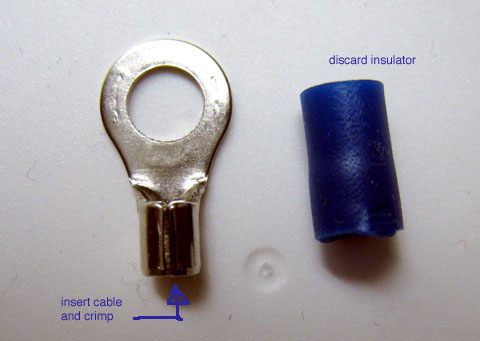

I used a bicycle brake cable for this job. It has a lead end that is already attached and the cable is stiff enough to feed through the cable housing (turning it as you feed makes it go through easily).
I also used a solderless electrical connector instead of making a wire loop. As it turned out it's the perfect size. Cut the cable longer than needed, insert it through the housing and trim it to the proper length including the connector. Insert the end into the connector and crimp it.
The cable cost $3 and I had a connector lying around.

Hoping this isn't too late but you don't need to break into your seat!
My local garage gave the same advice as you were given. Thankfully I had already read these forums so kindly declined the offer. Next I tried a dealer but the lady who answered the phone was far from helpful and refused help, saying they were completely busy and I'd need to book it in later in the week (that was yesterday). But Metropolis in Vauxhall were brilliant! I was told to bring my scooter down and when i arrived one of the mechanics stopped his work and sorted me out, took about 10mins - and without busting it open! (the lock was then totally removed so I could get it home).
Today I bought some electric eyelits (as suggested by jtblam above) from Maplins (£1.19) and then some security fence wire from B&Q (98p) - which has a load factor of 40kg so hopefully won't snap. Then this evening, in the damp and dark (the instructions were that easy to follow!) I managed to install the wire thanks to Messycolorings very kind instructions above - thank you! My only alteration would be that threading the wire B to A is much easier than A to B. I've also used the electric eyelits at both ends, the A end it acts like the fish weight originally explained. So touch wood a £2.17 DIY job has saved me the £100+ of a new seat every place suggested was the only cure.
Cheers Messycoloring and jtblam!
