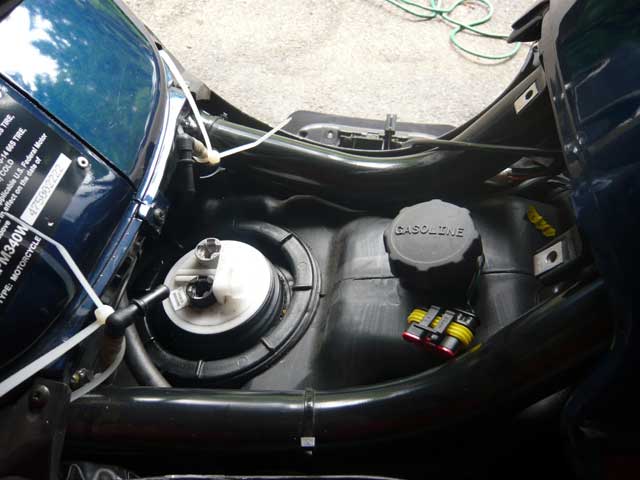

Step 1

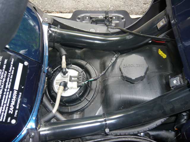

Set scooter on level ground up on its lift stand. Open fuel door. Unscrew fuel tank cap. Remove rubber shield around fuel tank mouth. Now remove four screws. Two are inside the fuel door the other two are at the extreme front top corners of the black plastic saddle framework around the fuel filler door. Lift the fuel door end of the “saddle” and then urge the saddle out from under the lip at the rear of the saddle. Then tip the rear end up and over and off to the left (as looking forward). Screw the fuel cap back on to keep crud out of the tank. Things should now look as in the picture at Fig 1.
Step 2
You can see there are two hoses that are connected at right angles into the fuel tank. Where each hose connects, there is a small collar ring. Press downwards on the ring while simultaneously pulling upwards on the respective hose. It should come loose. It will likely leak some fuel when it disconnects. Have a rag ready! I used a tie wrap on each one to hold them up and out of the way. Now disconnect the cable. I tucked it under the fuel cap. Things should now look like Figure 2.
Step 3

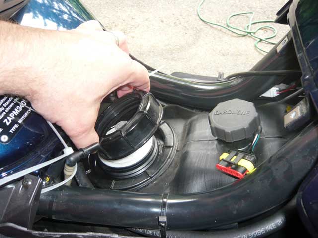

There is a screw collar around the fuel tank sender assembly. Use a standard blade screwdriver placed against the ribs on the collar and tap lightly with a hammer. Unscrew the collar. Things should now look like Figure 3.
Step 4
Rock the fuel tank sender assembly back and forth while pulling upwards. I assure you, it will break free and start to come up and out. Once it comes up, you should be careful while lifting it up so as not to damage the tank float (the thing that figures out how much fuel you have for display on the fuel gauge).
There is no need to pull the entire assembly up and out, I would just hold it up with a string or weak bungee cord attached to the handlebars while working on it.

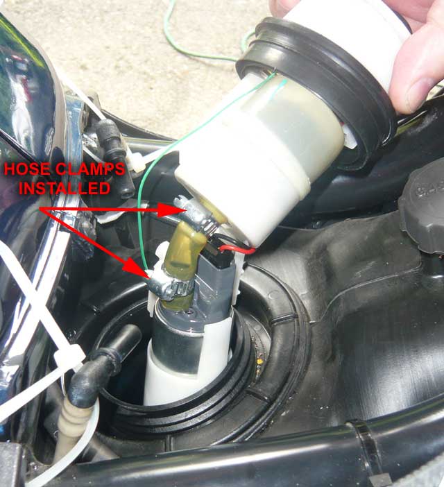

Look at the hose below the white lid. There should be two hose clamps on this hose like in the picture below. If they are not there, YOUR SCOOTER IS DEFECTIVE…..so install some! Buy metal hose clamps for a ˝” (12mm) hose. Unscrew them completely and wrap them around the hoses. They should be quite secure, but be careful about over-tightening them. You are wrapping around plastic fittings. Your fuel tank sender assembly should look like Figure 4.
Reassembly:
It is basically the reverse of the disassembly. Things to be careful about... The rubber ring that is around the white cap, tends to get folded over while reinserting the tank sender assembly. Be real careful that it slides in straight as you push it back down. Line it up in-line with the front/rear of the scooter and rescrew the collar. The two hoses just snap back in place. Reconnect the cable. Unscrew the tank cap, and replace the saddle cover. While installing the saddle cover, take care about the routing of the cable release for the fuel filler door. Install the four screws, the rubber seal around the tank filler collar, and the tank cap. You're done. GO RIDE!

BV 500:Fuel line replaced and hose clamps applied - success!
pdxscoot:
Thanks for this excellent post. I applied the fix today and also replaced the fuel line to be sure. Your instructions are great and Bev started right up after re-assemply; no more rough or cutting-out idle!
Below are a couple of photos of the end result. Looking good!

Its interesting to note the fuel gauge float sensor is mounted directly to the fuel pump assembly on the BV500 whereas the Scarabeo 500ie has a separately mounted fuel float in the forward part of the tank.
Vernon

scootaluca,
Thanks for these additional pics.
Question: Didn't it really stink to pull the entire assembly out like that? Why did you feel the need to pull it all the way out? Don't you think you could have replaced the hose in-situ?
Nonetheless, it makes for great pictures. Thanks.
