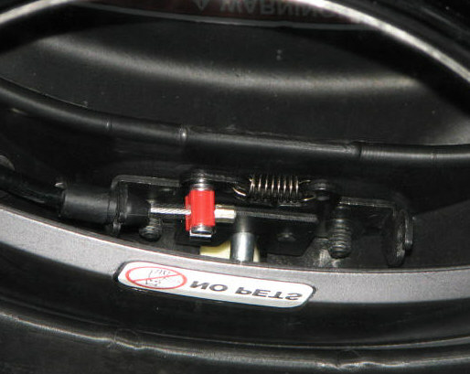

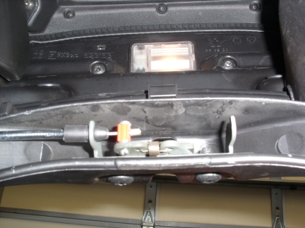

Open the back hatch.
Get a mirror to look at the saddle latch..
It looks like the picture below.
Pull the latch wire...Viola
stickyfrog's photo
My seat latch photo
