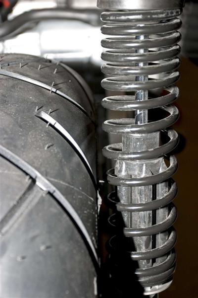

Sun Mar 22, 2009 2:41 pm quote
manfetti wrote:
I don't believe that you can. There is not enough clearance on the sides to accomodate a 160 from what i can tell. I think a 150 will barely fit but I haven't tried it yet. Maybe at the next tire change....
Matt C.
Wrong!
Michelin 160/70/14
Joined: 28 Feb 2009
Posts: 17
Location: Lisbon
Sun Mar 22, 2009 2:44 pm quote

Sun Mar 22, 2009 3:19 pm quote
Thanks for the close-up, JM!
Beautiful! That's a Michelin Pilot Sport SC 160/60H-14 radial tire, am I right? Have you noticed any change in your top-speed, or error in speedometer reading? How's the performance, in general?
Such tight fit! Very nice! Yet have you noticed any marks on the coil spring (of the rear suspension) and the widest part (both sides) of the tire? For example, see below (not a MP3 500, but you get the idea):

Sun Mar 22, 2009 3:42 pm quote
Looks like a tight fit. Any rubbing on the shocks?

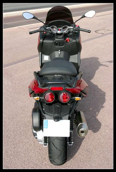

Thu Apr 02, 2009 3:55 pm quote
Just returned from a 758-miles scooter rally/sorry 4 delay
Here is the Diablo.
You like?

Thu Apr 02, 2009 5:55 pm quote
sushiman007
The Diablo is a good tire IMO. I have had several on my 250 and got 3200 mi or so out of them. I have only changed the tire on the 400 once and went with the Gold Standard thats what it came with. I want to try the wider tires on both scoots and see how that goes. Let us know what you thing of the wider tire on your 500.

Fri Apr 03, 2009 6:31 am quote
wow, that is a pretty tire (is it strange to think a tire is pretty?)
i already ordered the gold standard in 150/70-14...but i just might get a diablo when i run through this new one (about a year)....
let us know how it rides and, later, how many miles it lasts...
