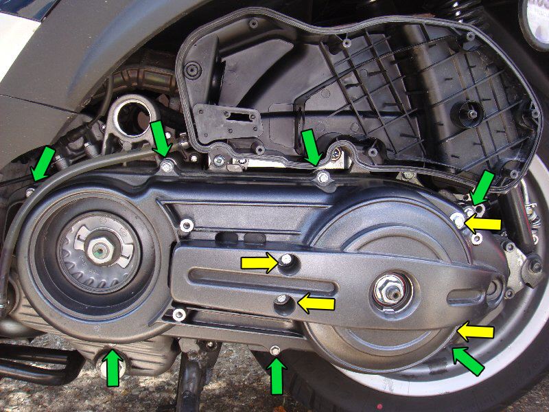

Start with taking 4 black screws which hold transmission plastic cover out..
You gonna have to remove air filter cover for the transmission plastic cover to come off.. It should be 9 screws
Take the plastic round cover off using screw driver...
Finally the plastic cover is coming off..

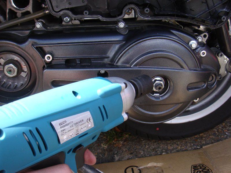

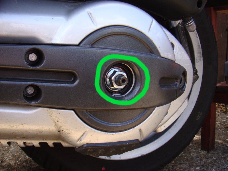

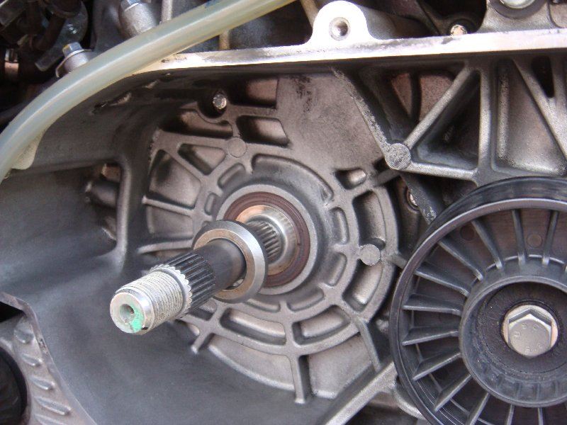

Undo the driven pulley nut using either impact wrench or any other wrench.
21mm 6 sided socket - I used 1/2'' drive and it worked great.

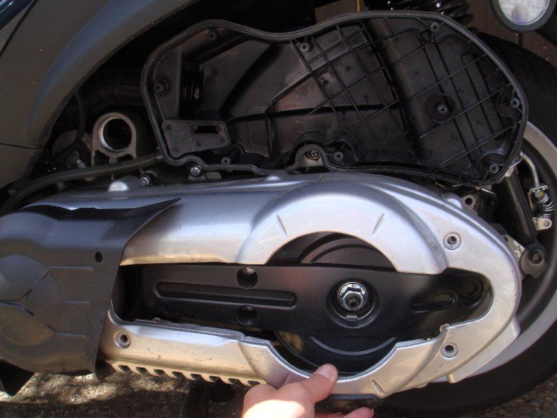

Now the aluminum transmission cover screws, 7 smaller ones and 4 bigger ones..
Transmission cover off..

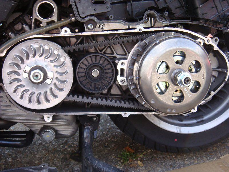

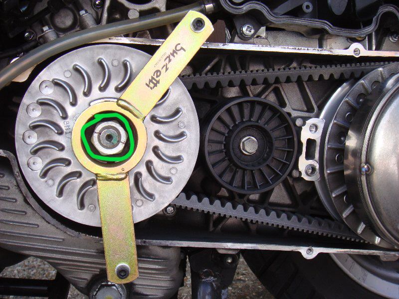

Attach variator holding tool. This one is from company called Buzzetti. More info here http://www.modernvespa.com/forum/topic47278
Undo drive pulley nut. Best for this is an impact wrench as it is very tight. 27mm 6 sided socket - I used 1/2'' drive and it worked great.
Remember which washer goes where. The bigger one no. 1 first than smaller no.2
Behind outer variator pulley you will find another washer..

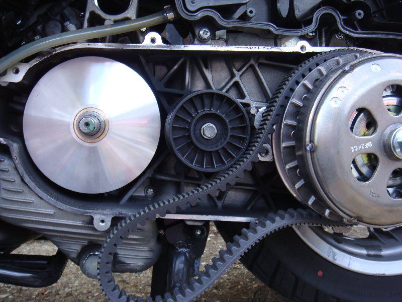

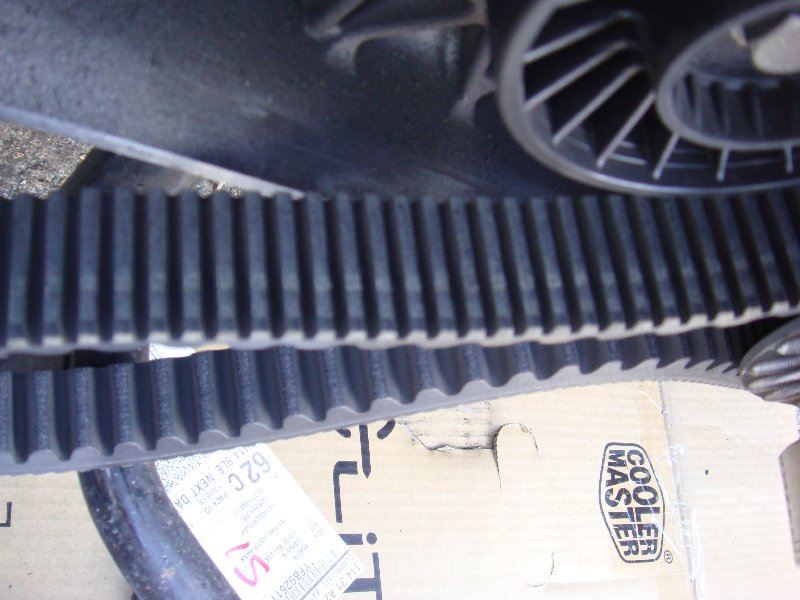

Check the driving belt... this one looks OK after 3333 km :)

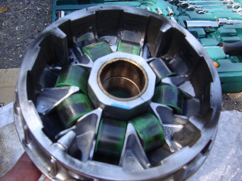

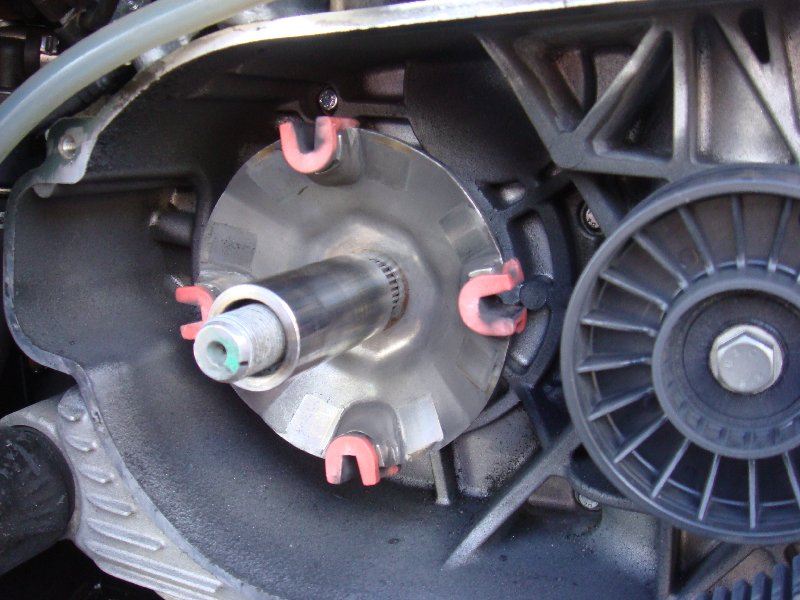

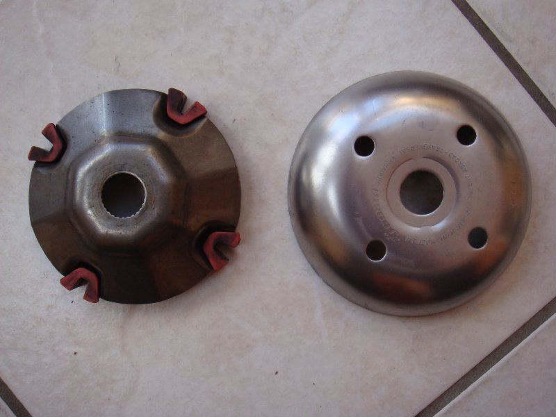

Variator with OEM rollers
Bushing and the variator housing with "shoes"
OEM variator and J COSTA
Housings
OEM variator
J COSTA
Notice that behind the variator is "another" washer. Just leave that on..
Its ON!

Put it all back on in reverse order BE VERY CAREFUL WITH ORDER OF WASHERS !!!! Torque the drive pulley nut - torque 160 - 175 Nm.
Make sure that the drive belt is down in between the clutch pulley halves (It is not like that in the picture!) otherwise you
Put no.1 washer on, then the aluminum transmission cover and then washer 2 and 3. Just to confirm no. 1 washer goes UNDER transmission cover!
Torque the Driven pulley nut - torque 92 - 100 Nm. You need to lock the rear wheel.I used the handle of the big axe + holding the rear brake + parking brake

Good write up, but can I add a couple of points.
When undoing the clutch nut use an offset ring spanner on the nut. The shaft has an hexagon on it to allow the use of a socket and wrench to hold the shaft still.
For tightening the clutch nut I found with the weight of the bike on the back wheel and parking brake applied that was enough to be able to torque the nut up with a torque wrench.
When tightening the variator nut, make sure that the drive belt is down in between the clutch pulley halves (doesn't look like it is in the picture) otherwise you risk tightening the outer pulley half against the belt. Then when the belt moves up the ramps the nut is not as tight as you thought. Resulting in the variator nut then working loose.
Very good point!
I've put your note under that picture.

I used these instructions to install the J Costa Variator on my MP3 500 today. It made the installation smoother than the variator itself.
Thank you!
One note.....I only had one washer on the exterior of the aluminum housing (rear nut) instead of two like you show on the 400.

Joe Bulva - I was wondering if you might be able to answer a couple of questions concerning the OEM rollers.
1. I notice they sell on-line different sizes for roller weights: 15x2, 16x3, 17x12, etc. Do you know the actual size of the OEM rollers use on the Mp3 400? I like to get the same OEM rollers to replace mine old ones.
2. Where can I purchase these OEm rollers? I can't seem to find them on-line anywhere. The rollers I found are for MP3 250 or MP3 500.
Great illustrations by the way. Thanks for the step-by-step instructions.
You can only get OEM parts from a dealer, try here for OEM parts.

* The M6 screws on the transmission case had 8mm heads; the M8 screws, 10mm. The hex shaft on the clutch side is also 10mm.
* I couldn't find a 20mm offset ("misaligned" as they call it in the manual) wrench for the transmission case (clutch) nut, but 13/16" worked perfectly.
* The variator nut is 27mm, which I also didn't have, but a 1-1/16" six-point socket was a very good fit.
I always wondered why they made oddball SAE sizes like 15/16" and 1-1/16". When would either be better than a 1"? Maybe they did it on purpose to approximate metric sizes? I suspect that metric socket and combination sets typically skip over 20mm because of the wide availability of 13/16". Likewise 19mm being relatively hard to find (here in the U.S., anyway) because it's a match for 3/4".
* Page ENG-3 of the MP3-400 service manual says "Remove the six M6 screws" from the transmission case. That is an error; there are seven screws, just as it says on page ENG-18.
