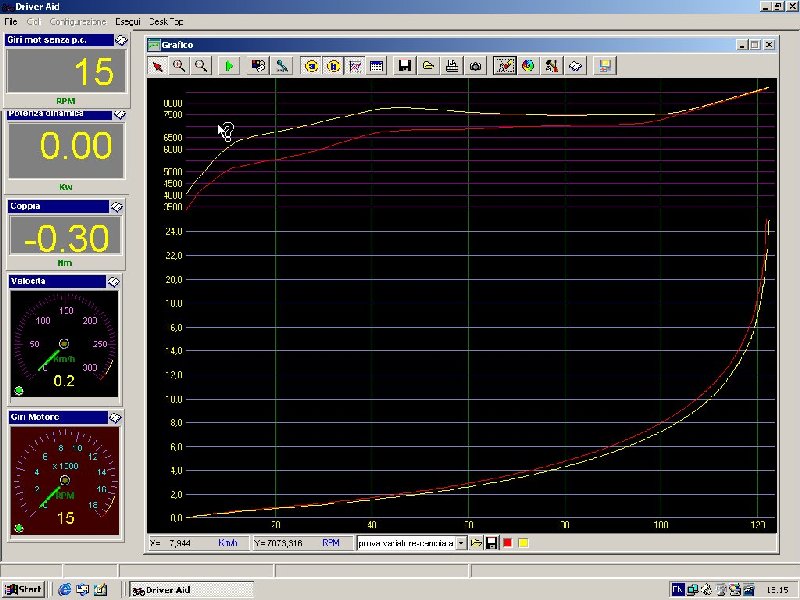

Mon Jan 25, 2010 3:49 am quote
Polini sent me this graph of the Polini and the 300, showing more "intant" rev.

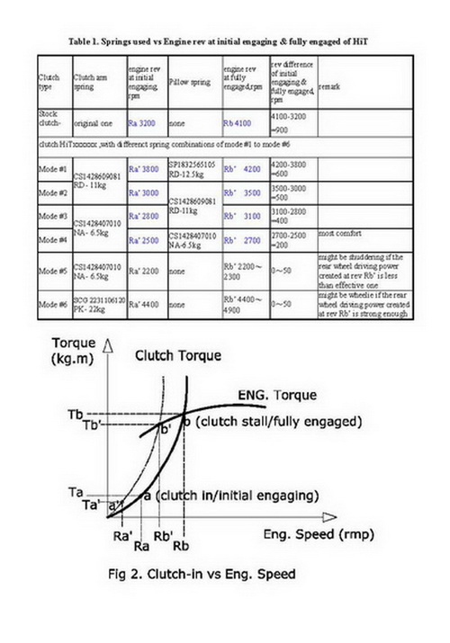

Hi,
As i know the original roller in Vespa GTS300 is 2117 in 13.8 gram,normally the SR is about 0.5 to 3 gm lighter than stock roller but the best weight for the SR 2117 may be various for different rider's requirement.
As for HiT201203 ( ie. for Piaggio group's 4t,125 to 300cc ),since its engagement is very solid,so clutch slippage is much less, you'll find its throttle response becomes very instant that is necessary and helpful to get excellent acceleration in whole speed range such as initial take-off , hillclimbing,overtaking or even the maneuverability at slow speed.
Normally the retail price is about USD300.00--350.00/set for HiT201203,45.00--50.00/set for SR2117 and DHL shipping 60.00.
I'd like to know is there someone who would pay 280.00 ( including DHL shipping to USA ) to get one HiT201203, 3 sets SR2117 in any weight but he should promise to post the REAL test result in this forum.

Joined: 27 Jan 2009
Posts: 102
Location: Taiwan
Tue Feb 02, 2010 6:01 am quote
bagel wrote:
Paul, why are you asking me what I think? Your company designed and manufactures this product, I would expect that you would be the one to provide a thorough and definitive answer about its usage. I only have a basic idea of the physics involved in variator design, so I don't know how a small change in the size of a slider will affect the performance. Maybe a larger slider would make the belt ride higher; or maybe not, perhaps the lateral force exerted against the belt depends only on the weight of the slider. For that matter, I don't have any idea how the shape of the sliders differ between one size and another. For all I know, the angle of one face might be slightly different and that could have a more pronounced impact on overall performance than the length would.
I've already invested a great deal of time, money and labor in trying to figure out which of your products is the right one to use, but I can't seem to get a straight answer from anyone, including you. It certainly doesn't help that the vendors you sell to in the USA (e.g. scootertrap.com, ScooterWorks), are selling the wrong size for the GTS (20x17). Before I completely abandon your product out of complete and utter frustration, please tell me what the optimal weight would be for the following applications:
Vespa GTS 300 (stock): 20x17 13g is too light; what weight should be used for a 21x17 slider instead? 12g? 13g? 13.5g? 14g?
Vespa GTS 250 (stock): 20x17 10g is too light; what weight should be used for a 21x17 slider instead? 10g? 11g?
Hi,
I wish i could definitely tell which weight is the best one but it's really pretty hard.
Normally the scooter makers designing a fixed size ( ie. OD x height ) of weight roller for their CVT system such as variator to get a fixed Low Gear/High Gear value ( see the attached Fig. Curve of Full Load Acceleration), a fixed weight for their weight roller to get the best performance such as riding comfort, fuel milage, air pollution requirement etc.
So it's better to use the roller or SR in the same size.
If the roller size is changed then one or all original designed parameters such as Gear Ratio Value , the Shift Range and the slope of line b_c, line c_d or line d_e will be changed too.Then you need to do tuning to get the best performance for you.
As for the weight, people always use weaker contra spring for lighter roller used but some people still use the stock contra spring to get different results. The same, for heavier roller people always use hard contra spring but stock spring is also used to get different performance .
In Taiwan, the SR2117 used in BV250 normally is 10.5 gram with stock contra spring but some riders use 13 gram with harder spring.
We don't have GTS300 here but riders use SR2117 in 14 gram for
MP3 300 ( installed with HiT201203 ) with harder contra spring.
I do hope you could understand my explanation.
