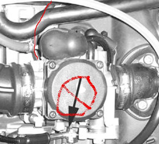

What is this hose that comes off the left rear bottom of my carb? (Not where the arrow and "no" sign is. The one with the narrow red line following it.) It appears to just go through a clamp inside the cowl and is open on the end. Did I accidentally disconnect it from somewhere, or is it supposed to be like that?
I was going to put in a 38 idle jet, but was having trouble getting the screws out of the carb. I chickened out and put everything back together, but wasn't sure about this hose.
Could someone put my mind at ease, please.

Is that the battery box drain line?

This looks to me like it's your carburetor overflow line. It should be connected to the bottom of the bowl on the carburetor and goes from there to the left side of the motor then turns down towards the ground and is open at the end. This line provides a way for fuel to safely overflow from the carburetor in case your float needle sticks open. It carries the fuel around the hot cylinder and lets it dump on the ground rather then letting it drip directly on the hot parts (fire hazard).
Here is a photo of how this line is routed around the cylinder (follow the red line).

Thanks. But, no it comes from the carb.
That makes sense. Yes, it does come from the bowl area of the carburetor. Thanks for putting my mind at ease.
