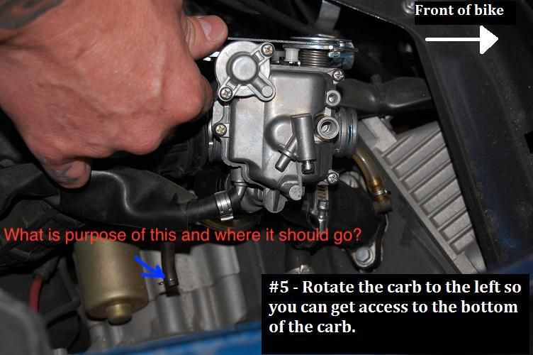

On the LX150 there is also a very tiny black tube that runs off of the bottom of the carb which will come off as you lift the carb. It can be hard to see if you don't have direct light into the engine area. If you don't reattach this tube, you can expect a small puddle of gas under the carb.

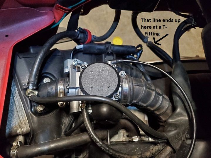

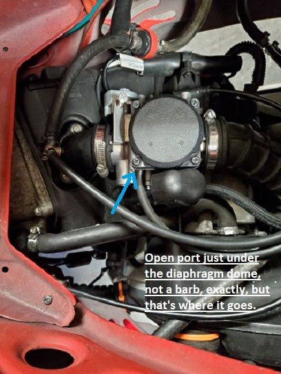

other end of the hose??
cleaned the jets on my et4, went well. Boy were they dirty. The bowl gasket was stuck to the carb body and I had to ease it off with my finger nail tool. Wound up stretched and wouldn't fit back in the groves on the bowl side. just kept working in and holding and compressing and it finally stayed long enough to index it back to the carb body.
In the process the hose on the bottom of the bowl came off, at the other end, and I can't find out where it goes. There is a nipple some where that needs a hose that I can't see. No real help in any of the drawings in any manual I have. Help. |
quote
Is it an orange hose? If so, it mine runs down the side of my engine case and is not attached to anything.
I'll take a picture and post. |
quote
There is another Post that addresses that hose, it's a vent/overflow hose, explained in this Post...
What is this hose? (LX150) Hope this is what you needed. |
