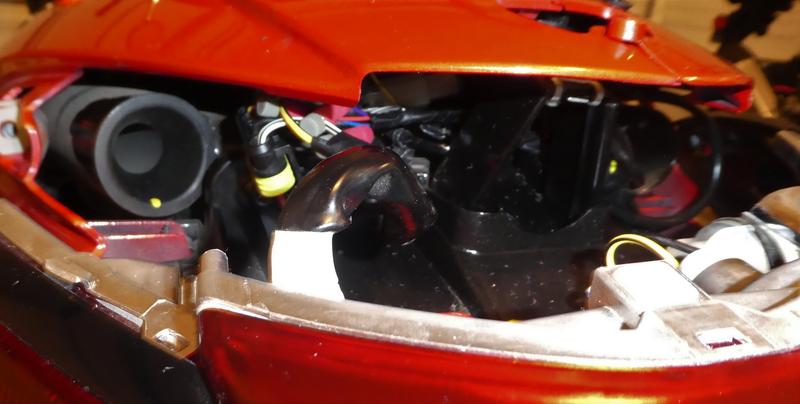

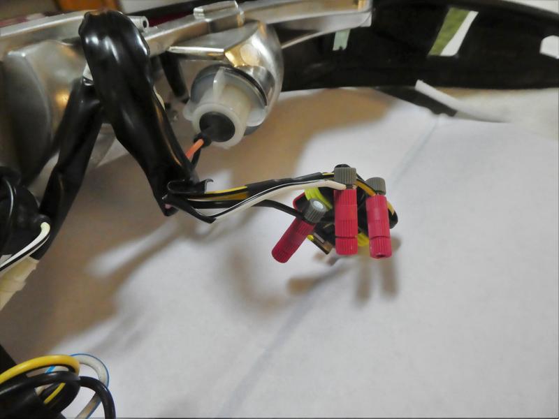

Used 3 posi-taps to operate the running light and brake light. (the PT's slots were too narrow for this Piaggio's thicker wires - but I made them work - do not need the light bar's turn signal feature - did not wire for it)

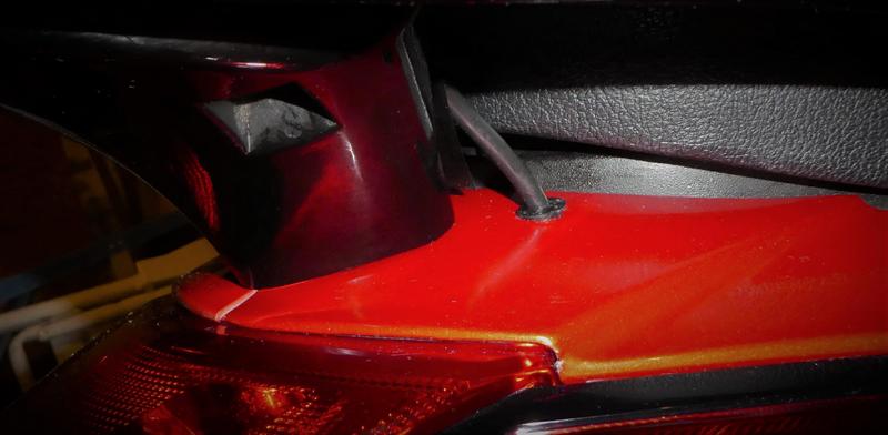

Drilled hole in right body panel, added rubber grommet and fished light bar wire through - attached 3 wires with posi-taps to taillight assembly:
BAR >> LIBERTY
black>>>>> black
red & blue>>>> yellow/black
purple >>>> white/black

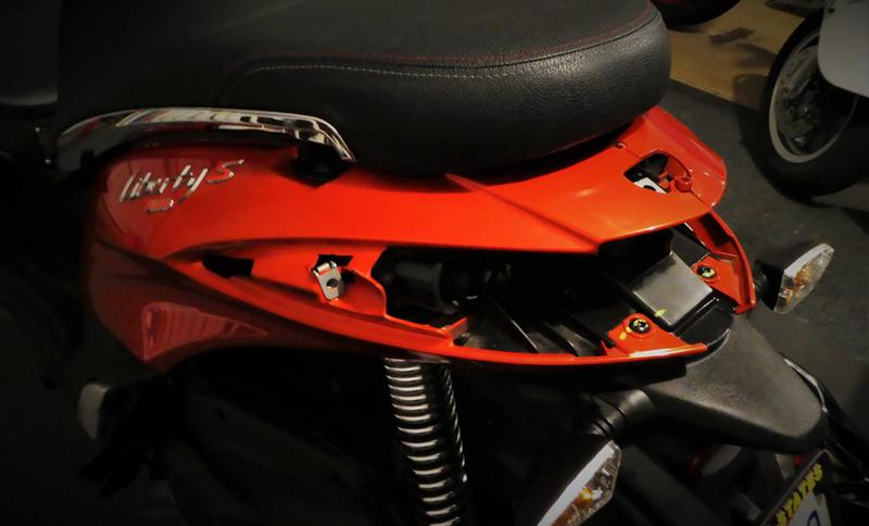

Reinstall the big plug back into scooter's socket - and slide taillight assembly back into scooter.
With all scooter fasteners installed - install rear rack, top case mount plate and top case.

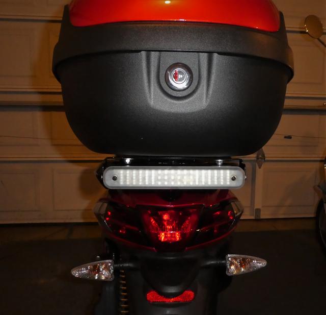

I did not drill case to mount light bar - but used rear-most two screws & nuts to mount the light bar bracket.

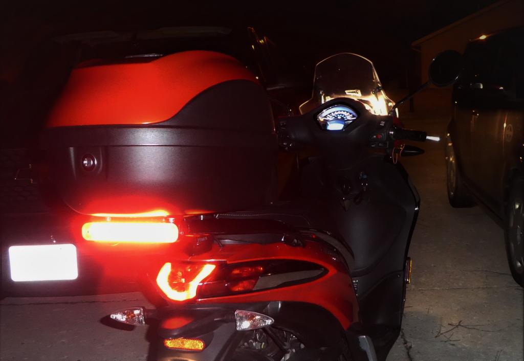

Running light looks like this (scoot's taillight has a pair of mini-LED's
All set for spring!
