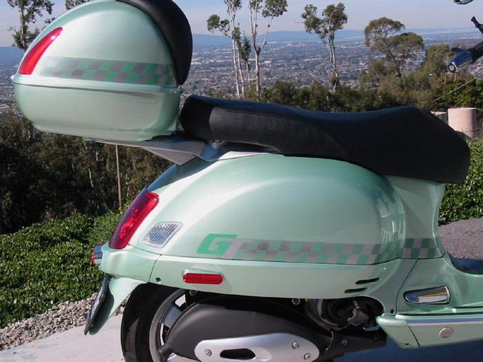

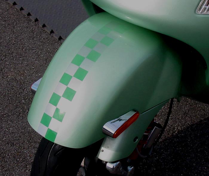

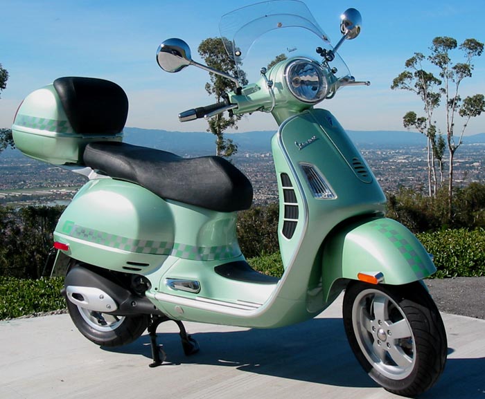

After not getting too far with my pinstriping skills, I decided to try something else to personalise my scoot. I wanted to do something subtle and elegant to add to rather than detract from the scooter's already clean and refined look, so I decided to airbrush a "ghost" pattern using colors that blend in with the Vintage green of the scoot. I used One Shot Enamel which I had bought for my pinstiping practise, a green, just slightly darker than the bike's color and silver. I added clear enamel to these in order to fade the colors out towards the rear of each checkered ribbon. Finally, I added a GT logo at the rear of each cowl. As always with all my projects, I'm not entirely happy with the result, but the general effect I was hoping for is there. In fact, the result is so subtle that it was difficult to photograph!

I think it looks pretty cool, good work. Did you use tape to define all the edges and just slowly progress... or some other process?

Andrew, 90% of the time was spent masking out with tape and newspaper, 10% painting!

I kind of dig that. There fade away is cool.

That looks absolutely awesome! I like the subtle checkers so much more than the black & white ones. Great work!

I always wish I would have picked up an airbrush when I see work like that. Great job on the checkers and more importantly how you incorporated the GT logo into the design. Very clean.

Great job on that Bob! The colors you chose look very nice on the Vintage Green. It is not an easy color to work with, IMO. I would never have the courage to tackle that, Beale.

Now tell me about your flyscreen, you added a part at the top of the screen, why, how, and what is the improvement from adding it?

Benny, the "lip" on my flyscreen is actually the cut off top portion from a Burgman 650 I used to own. It improves the airflow in the cooler weather, but is easily removed when the weather warms up. This is not a new idea. BMW used it on their early sport bikes and of course there's the Laminer Lip, a commercially available option. Jess also fabricated one.

Firstly, it extends the height of the original windscreen, without having to buy a complete taller 'screen and can easily be removed and stowed in warmer weather. Secondly, the airflow that hits the windscreen is deflected higher than it would be without the "lip". There is a technical explanation for this, but I'll leave that to someone else to explain, all I know is that it works!
