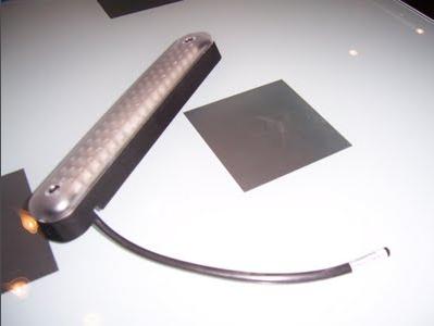

Admore Mini Light Bar

2. All the wire you’ll need for the installation comes with the Admore unit. What you need to do is separate the wire in two parts, use the electrician’s pliers or wire cutter to cut the wire about 6 or 7 inches from the Admore unit. On my unit there was a label on the wire. Assuming that the labels are in the same place on all units, cut the wire just on the far side of the label, as you see in the photo below.

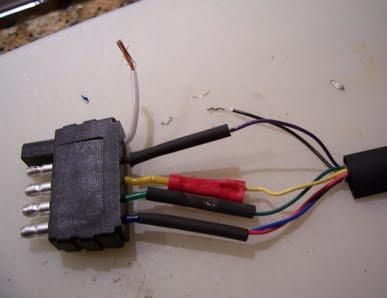

This is where I made the first mistake.
I forgot to slip heat shrink wrap onto the yellow wire before soldering it. I unsoldered it, but the solder on the two ends of the wire prevented me from making a new solder joint. So I shifted gears and used a solder-less butt joint crimp connector on the yellow wire. Problem solved. Hopefully by putting the heat shrink on all the wires before you start soldering, you’ll avoid my mistake.

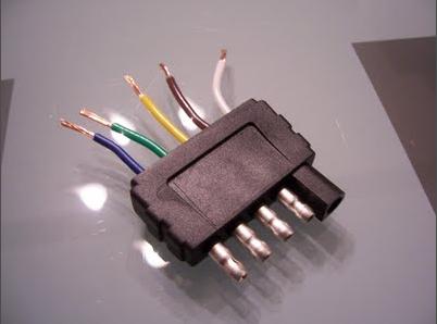

8. Notice that the two trailer plugs are not identical. They are mirror images of one another. One has five female connectors and one male connector, and other has the reverse. On the assumption that one day you’ll want to travel without the topcase, select the plug that has the five female connectors as the one to solder to the long wire.

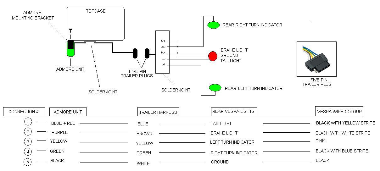

9. Solder the wires to the trailer plug, matching the colors shown in the following diagram:
You should probably also print the diagram out now, because you’ll be needing it later at the Vespa end of things.
Take care not heat the shrink wrap when you're soldering the wires. In my case, I did cause a small bit of the shrink wrap to contract. I used the box cutter (in my case, my scalpel [don’t ask, I’m a lawyer, not a doctor]) to cut away that small bit to allow the tubing to slide over the joint.
10. Slide the heat shrink tubing over each solder joint so that each joint is insulated.
11. Use the heat gun to shrink the tubing.

21. Solder the wires to the trailer plug, matching the colors shown in the diagram above. Take care not heat the shrink wrap. In my case, unbelievably, I made exactly the same mistake with the yellow wire. There must be something in my brain with yellow.

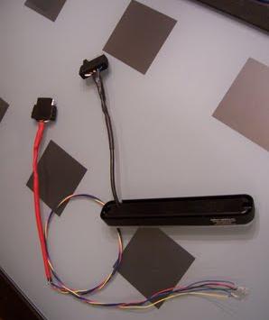

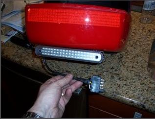

26. Finally, all the lab tinkering is done. What you now have is the Admore unit, terminating at the five-pin male trailer plug, and the other half of the wiring harness, terminating at the five-pin female trailer plug.

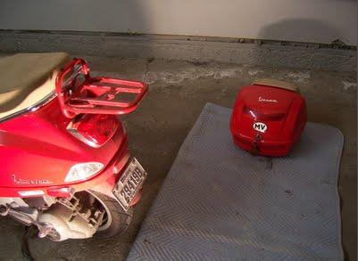

27. Park the scooter in the center of your work space. Set up some good task lighting. If, like me, you’re working in a cold garage, lay a blanket down at the back of the scooter.

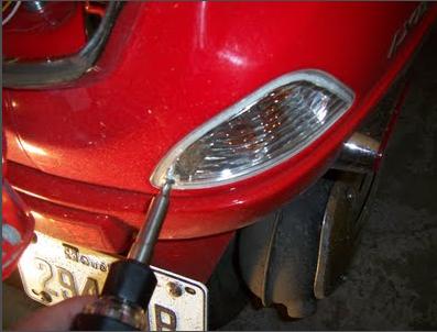

32. Next, still using the same screw driver, remove the single screw holding in each turn indicator light, pull the housing out, and let the housings dangle from their wires.

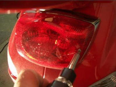

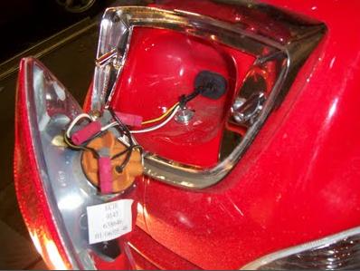

33. Remove the two screws that hold the tail light in place, and remove the tail light, letting it dangle from its wires as well.
34. Get the five Posi-Tap wire tapping gizmos out of the Admore unit parts bag, and install them onto the wires leading from the Vespa light housings following the wiring diagram above.
35. Take the wiring harness terminating at the five-pin female trailer plug you completed in step 25, separate out the yellow and green wires.

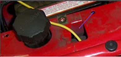

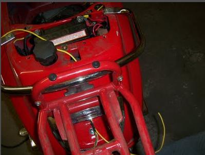

38. Now, looking down at the scooter from above, you’ll see that between the battery compartment and the back of the scooter body, there is an opening. You’ll be feeding the three wires headed to the tail lamp through that hole. On the opposite side of that hole, you’ll see an unused screw hole that leads into the battery compartment. Thread the green and yellow wires from the hole at the back of the scooter, over the lip of the battery compartment, through the screw hole, and into the battery compartment. Sounds confusing, but with the help of the photo, and seeing your Vespa, you’ll see what I mean. Easy-peezy.
39. Thread the yellow wire from the battery compartment, through the chassis hole nearest to the shock absorber screw, and down and through the left turn indicator opening.
40. Do the same with the green wire, down and through the right turn indicator housing. You’ll see that the inside of the scooter is pretty exposed and messy with road dirt and grime, and that’s why you added the extra insulation.

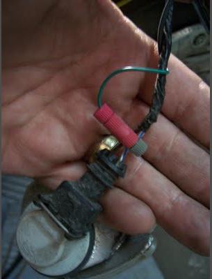

41. Mount each of those wires to the Posi-Tap connectors that you installed at the turn indicator light housings in step 33.

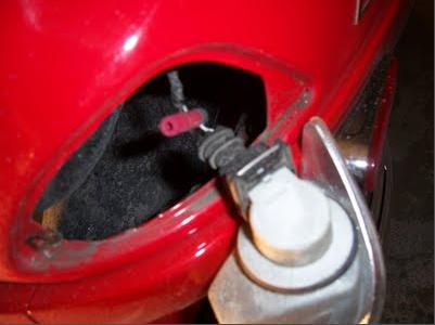

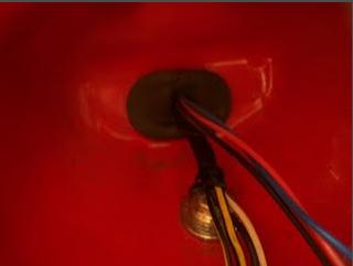

43. Turn your attention to the place where the tail light attaches to the scooter. You’ll see that the wires come through a black rubber grommet.
Use your fingers or a pair of needle-nose pliers to pull the grommet out. Slide the grommet back to the tail light housing that’s dangling free. Now you can clearly see the rectangular hole into the scooter body.

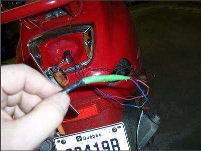

44. Get a three or four foot length of fairly stiff wire. I used 12 gauge automotive wire, and it did the trick nicely. Beginning at the opening at the top of the scooter, thread the wire into the opening and down towards where the tail light assembly is. It takes a wee bit of trial and error, but eventually, you’ll catch a glimpse of the wire through the rectangular hole at the tail light end. In the picture below, you can see the yellow 12 gauge wire going into the opening, and then coming out at the tail light end.
45. Using the needle-nose pliers, grab the wire and pull it through. Now, the toughest part of this project is done.
46. Moving back to the opening at the top of the scooter, using electrical tape, tape the four remaining wires from the Admore unit wiring harness you made (the purple, black, blue and red wires) to the 12 gauge wire. Moving to the tail light opening, gently pull the 12 gauge wire out through the rectangular opening until the Admore unit wires have been pulled through. Here's a picture of the harness wires once they were pulled through the tail light hole, still taped to the 12 gauge wire.
47. You can now remove the excess length of the Admore unit wires. Cut the four wires so that you have enough to make the connections to the Posi-Tap connectors that you installed earlier at the tail light housing.
48. Feed the four Admore wires through the rubber grommet, then push the rubber grommet back into place to seal the rectangular hole.
49. Twist the red and blue Admore unit wires together, and then connect them to the Posi-Tap connector connected the Vespa wire with the black and yellow stripe.
50. Similarly, connect the black Admore Unit wire to the black Vespa wire, and the remaining purple Admore unit wire to the Vespa wire with the black and white stripe.

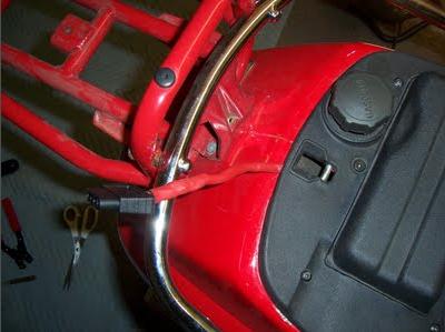

51. We’re almost done with the Vespa-side wiring. Here's a photo of the new wiring harness with the battery compartment housing re-installed.

53. You won’t re-install the underseat compartment parts just yet. Let’s move on to the topcase end of things.
54. In the comfort of your kitchen or workshop, turn the topcase upside down. Take the Admore unit mounting bracket and figure out where you want to place it.

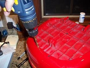

Here’s where I made another mistake. I judged the location of the holes from the outside of the topcase. Inside the topcase you’ll see that there’s a kind of trough that runs around the perimeter. I ended drilling the holes a little too close to the edge of the trough. I couldn’t get the supplied Admore mounting screws to sit flat as a result. What I did was to mount the screws from below, with the nuts inside the topcase, and there was barely enough room. I was lucky. Make sure that the holes you drill as well within the “trough” so that there’s room to let the screw heads or nuts lie flat, whichever you prefer.
55. On the outside of the topcase, use the permanent marker to mark the two mounting holes.
56. Using the point of your sharp knife, make a small dimple in the topcase in the center of the mark, to give your drill a place to “bite”.
57. Using your electric drill and your smallest drill bit (I used a 1/15 bit), drill pilot holes. The topcase material drills nicely, I found that a low speed worked best.
58. Switch to a 9/32 bit, and drill out the two holes.

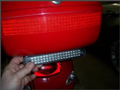

64. Take a moment to congratulate yourself, admire the wonderful light show at the back end of your Vespa, show off your handiwork to your significant other, and then go for a ride.
Pheww... that was more work than actually doing the project. I hope you will find the project report useful.
