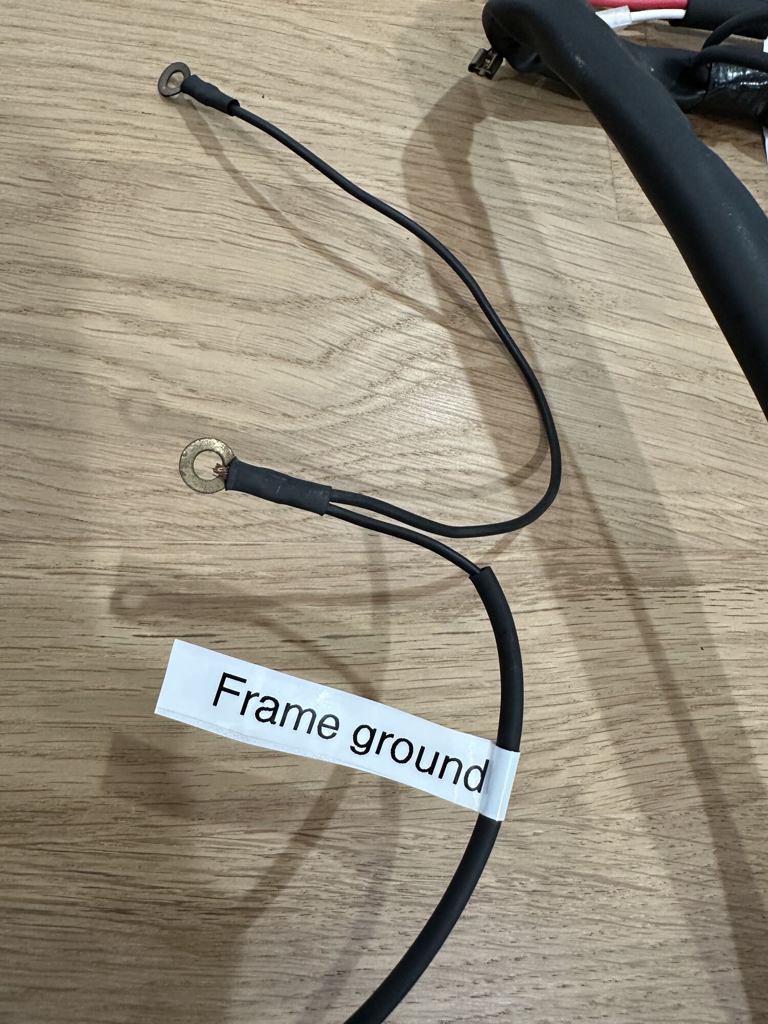

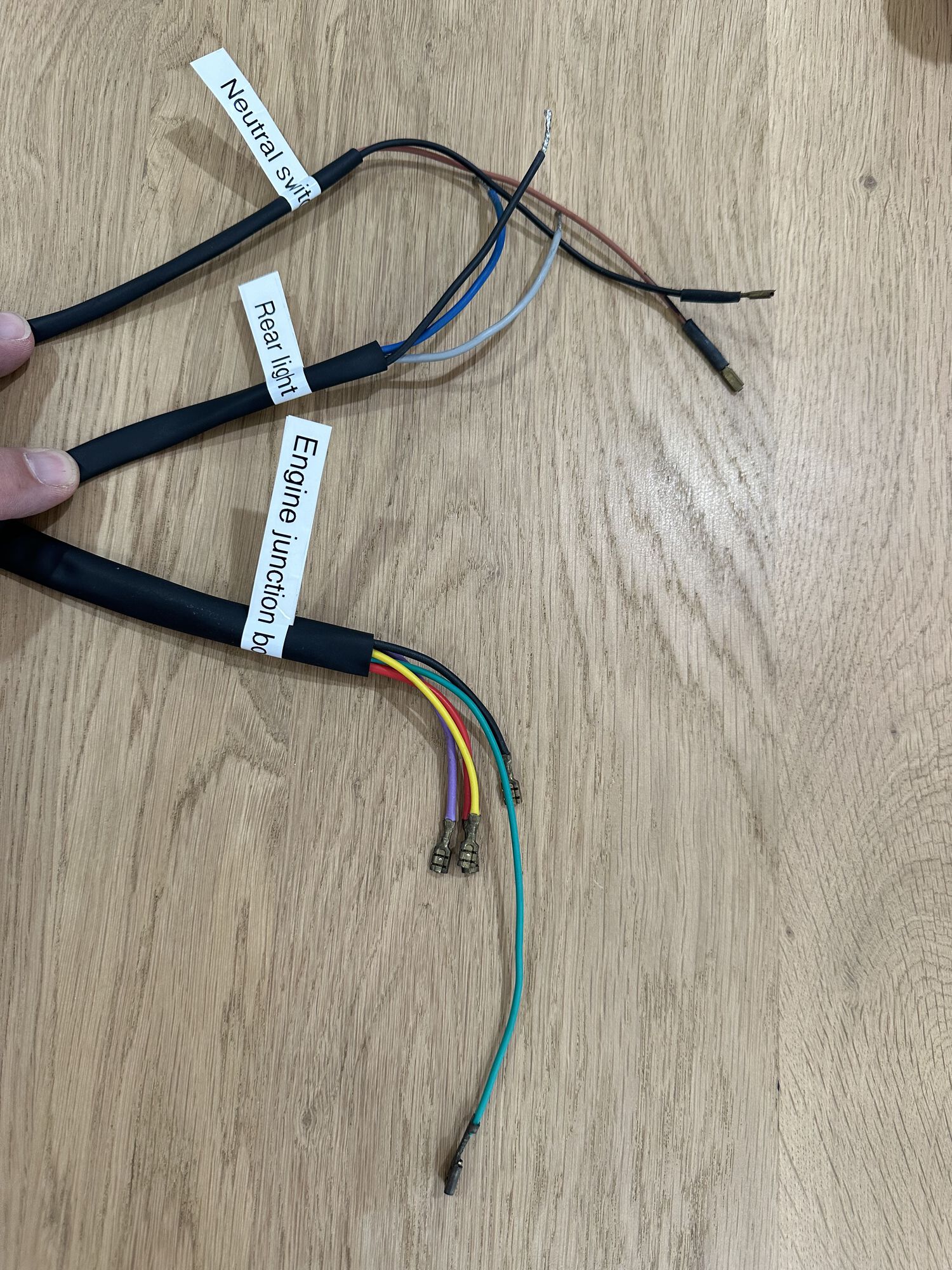

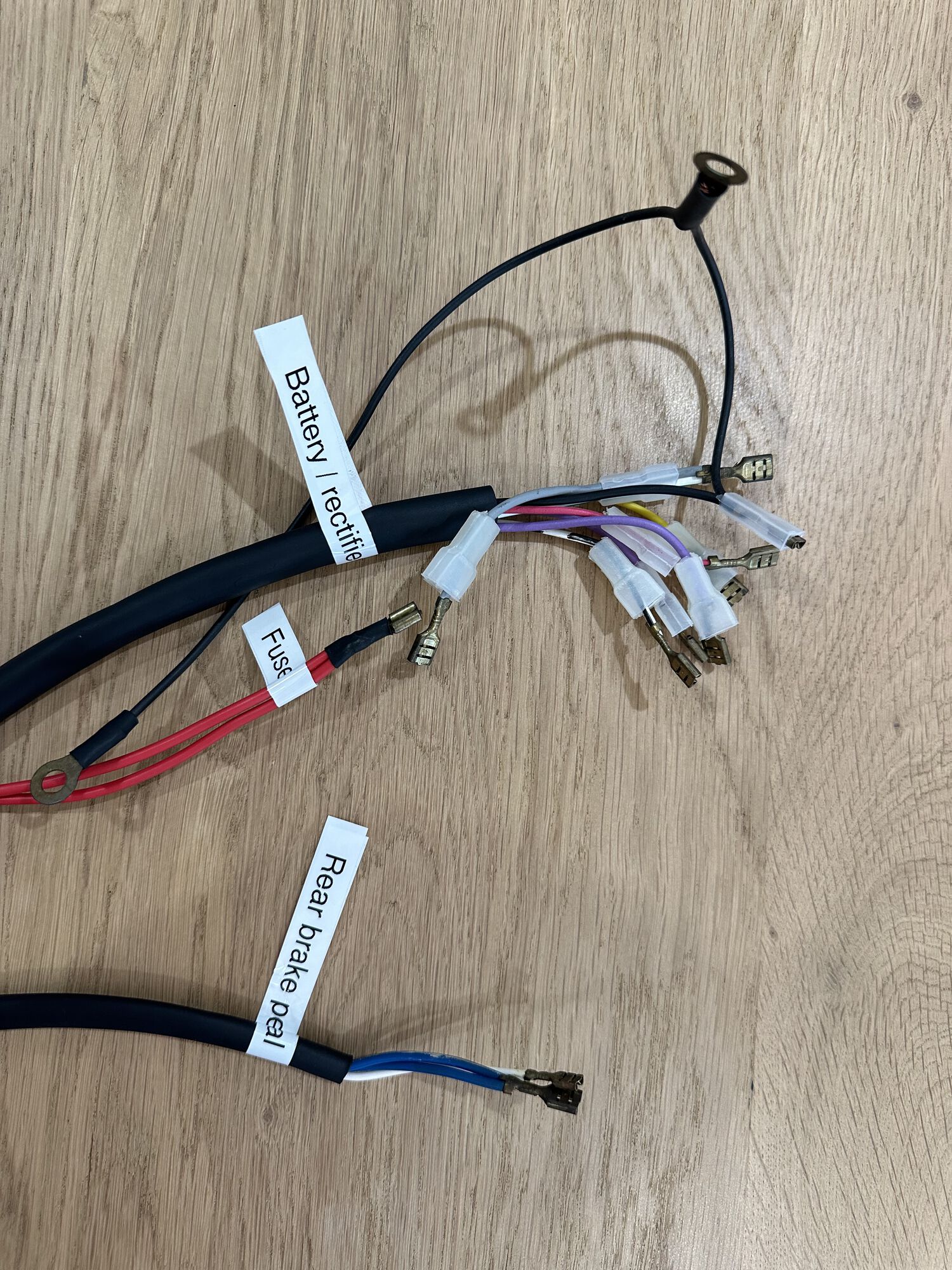

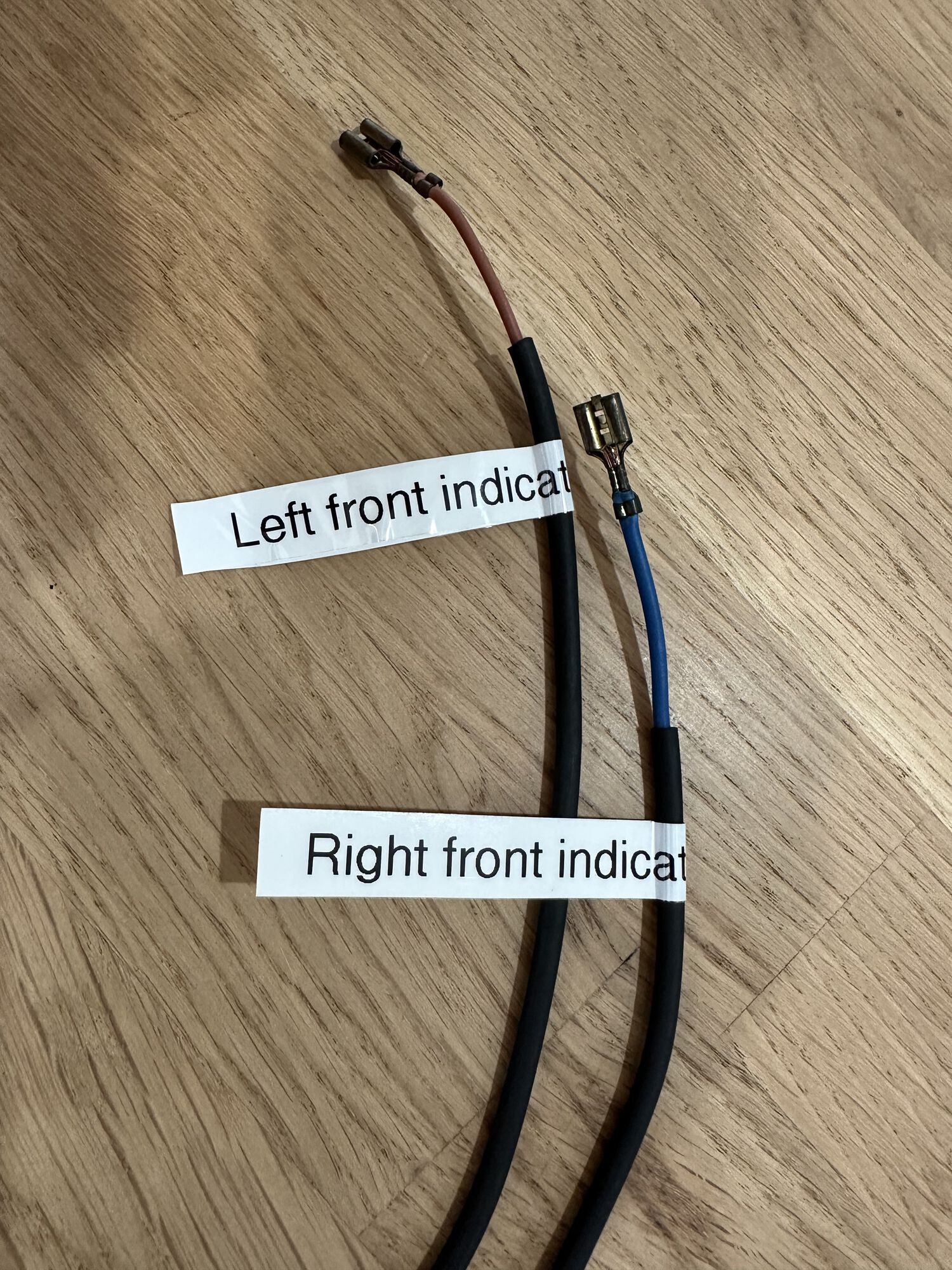

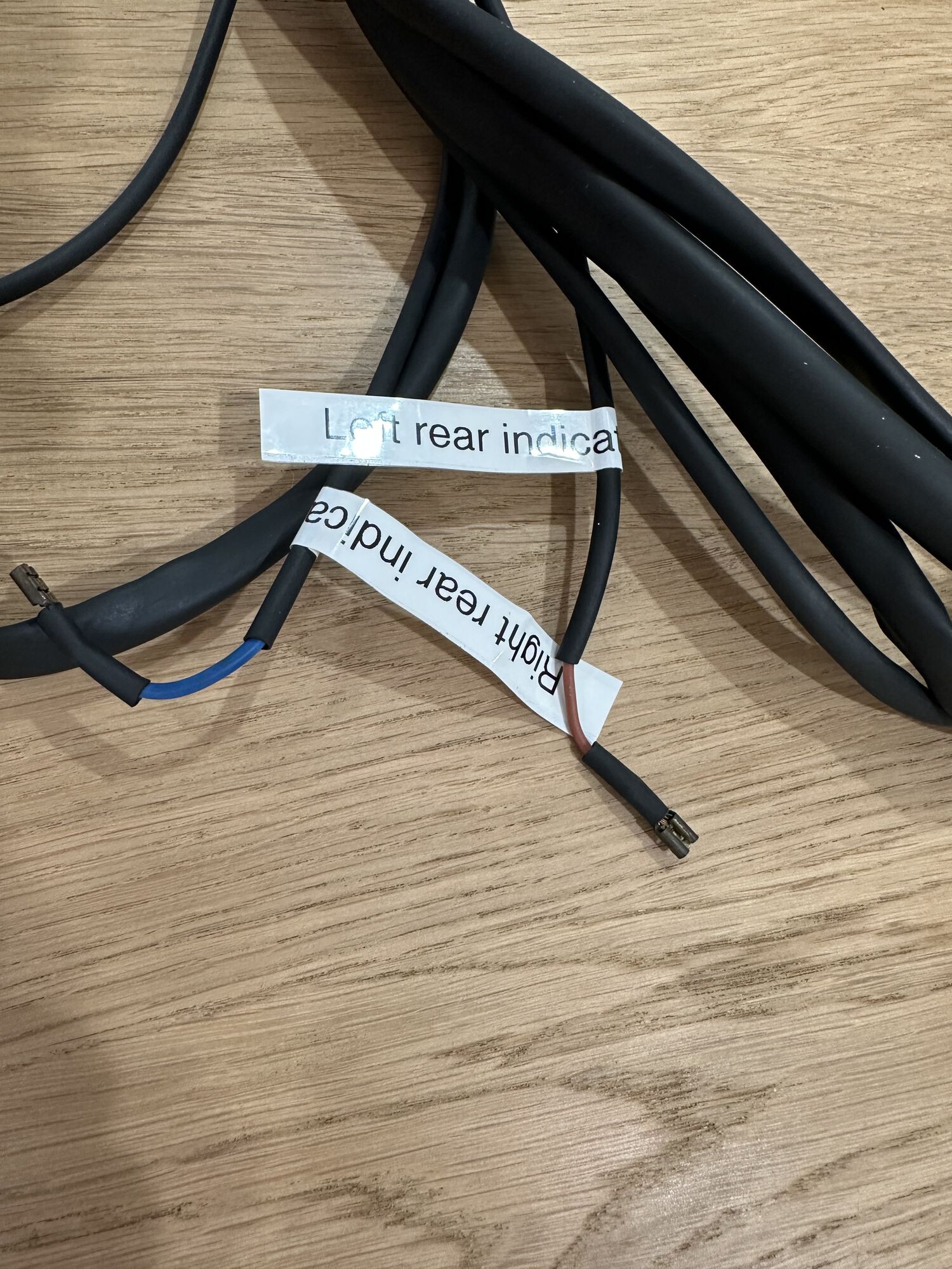

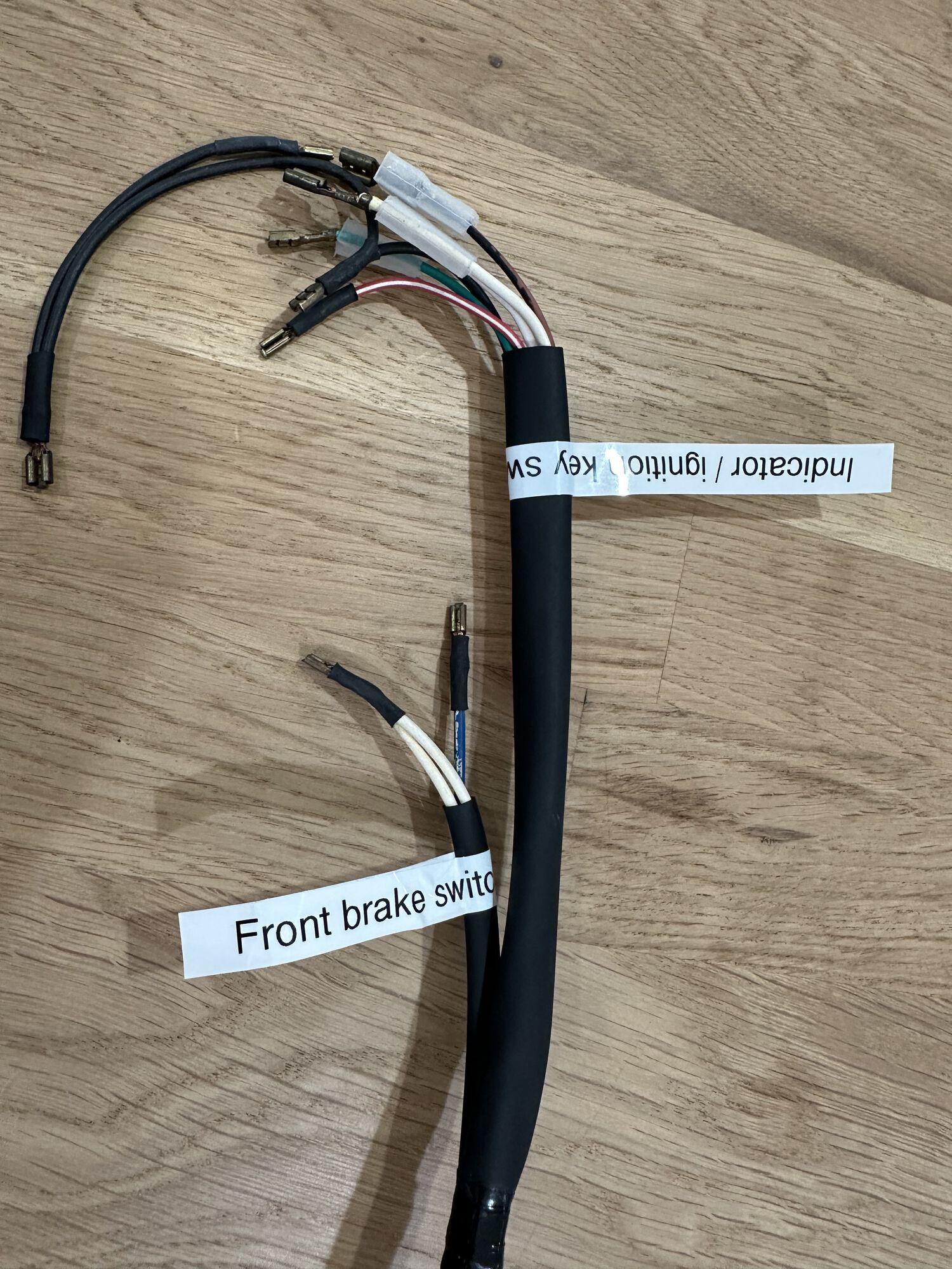

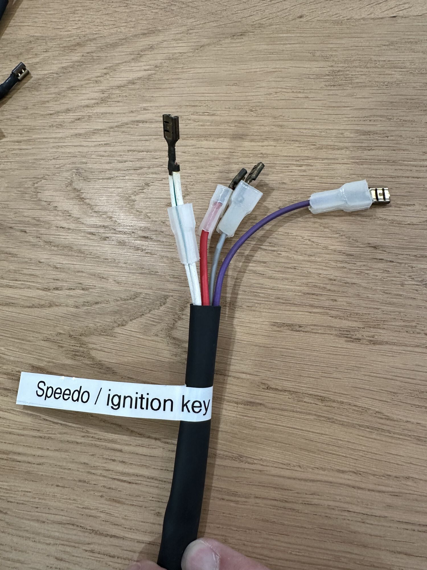

When installing a new wiring harness, it's helpful to label it so that you know what goes where without constantly comparing the harness to the wiring diagram as you're doing the job!
"Single Yellow Wire" Late P200E
US-spec P200E (VSX1T), with key & battery, after 1979. Serial numbers from 34627. Harness part number 182309.

Labeling
Speedo light / ignition key switch

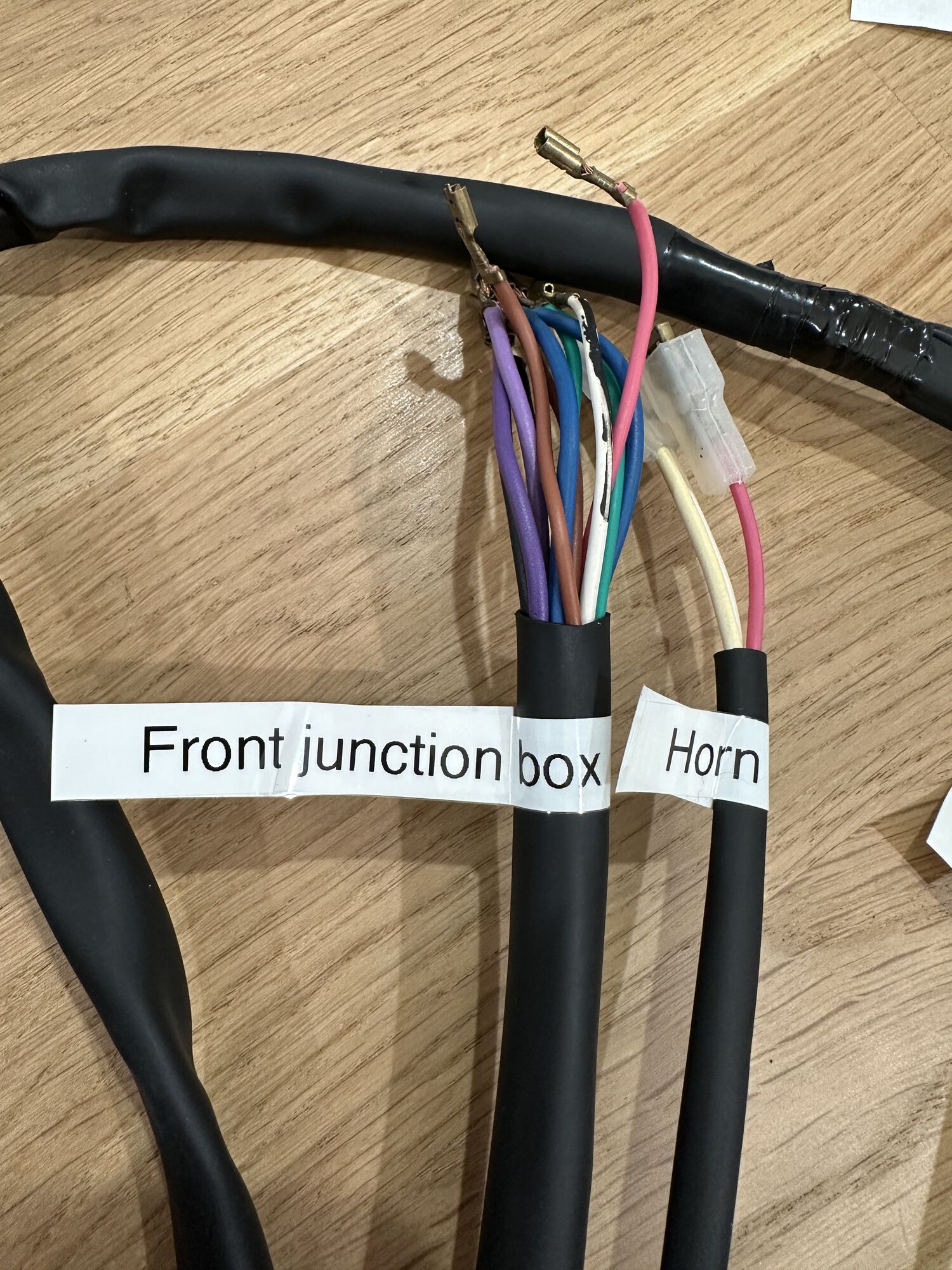

Front junction box, horn
Front brake switch, indicator bulb / ignition key switch
Front indicators
Rear indicators
Rear indicator grounds (inside frame)
Battery / rectifier, fuse, rear brake pedal
Neutral switch, rear light, engine junction box
