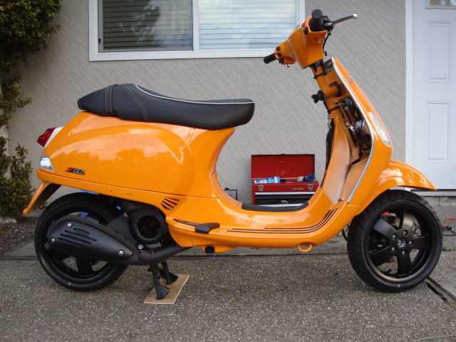

cool .. let me post some pics to help inspire you. i love the idea!
i have the rims being painted black, going to get them back friday. also have a performance pipe on it. love the look.
i tinted the blinkers i love the look, kinda hard to tell with the flash but it looks sharp. also have the euro light kit in.
this is a hole closure i can paint in the orange if you would like one for your scoot, the ones from scooterwest don't fit the S so you would need a different size. drop me a line and i can send some out to you.
Yeah, that's the idea.
I'm taking it a bit further and filling the the holes with plastic. Will post details when done.

Update: modified GT axle, cut and welded. Only piece of the project that's not "parts bin."
GT vs LX/S bearings = different size but similar specs -- longevity shouldn't be an issue.

Update: partially assembled pics. A long way from running yet, but this is what it's gonna look like.
Really looks stuffed in there at the back, fender will definitely require modification.

Update: it runs.
No big brake up front yet, but able to get a feel for the handling. Rear axle position is approx 2" rearward and 0.5" lower than stock -- combined with heavier wheel/tire/hub assys seems to slow things down a bit. Turn-in not as twitchy and a bit more stable at speed, feels like a bigger bike. Pretty much as expected.
Rear disc not significantly more powerful, but hydraulic modulation is huge improvement.
Rear fender cut and moved approx 0.75" rearward and angled 15 deg.
Issues:
1) rear master won't fit the bar cover without modification -- interference with signal switch. Fix is countersunk screw on bar clamp.
2) centerstand is short -- works but rear wheel touches ground. Fix -- GT stand or weld additional length.
3) rear wheel is offset approx 0.25" to right -- had to add spacer washers at exhaust bracket for clearance. Think this may be due to difference in wheel offset as front appears same.
