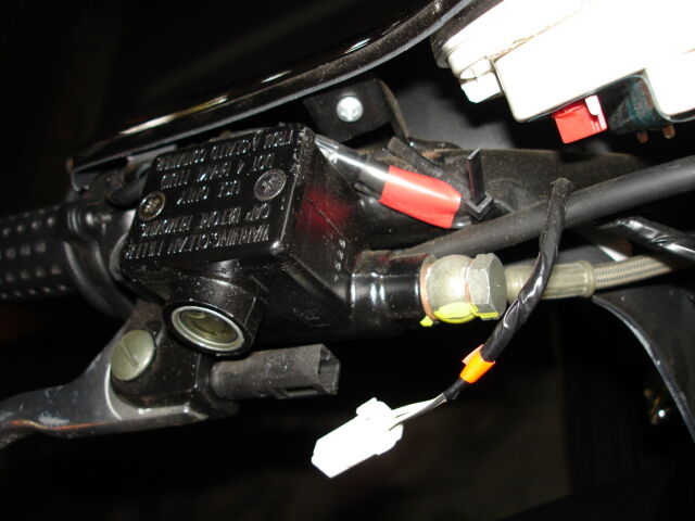

Uploading pictures, courtesy of TB.

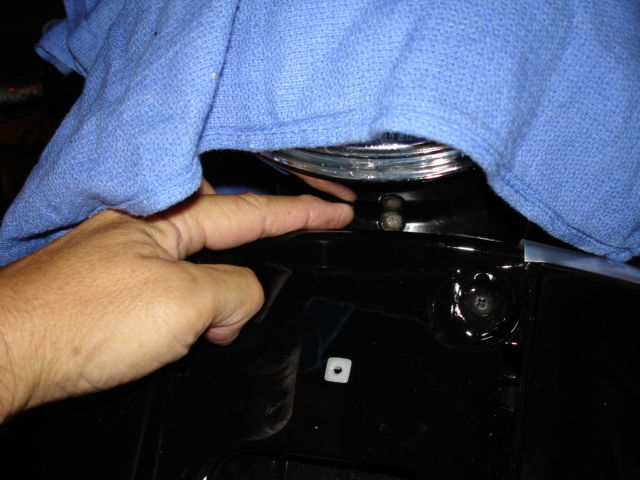

Uploading more pics, these ones cover the removal of the headset.
