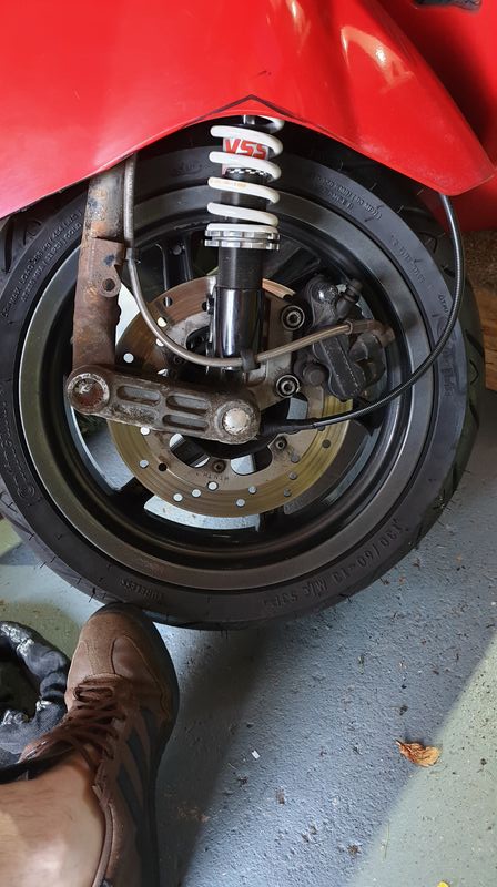

Hello All,
There is a very simple brake update for the GTS, if running 13" wheels, which cost about £170 (EUR190/$215) depending on taxes, etc.
This will give you a 250mm front disc, standard caliper and use sintered pads.
not full Brembo, but cost effective for servicing and not overkill.
Parts have been available for a while:
BRAKING adapter bracket - POW44
MALOSSI (Galfer) brake disc - 6217150
The parts were designed by different suppliers to put bigger brakes on the Gilera Runner earlier performance 50, 125/180 models, but will fit the GTS.
Based on Oops previous calculations the increased disc diameter, combined with better pads and the LX master cylinder may give a real OEM+ brake upgrade, even with a 240mm disc.
I have the bracket and a machines late Piaggio MP3 front disc (258mm machines to 250mm) for the OEM+ look and I'm awaiting a quote from a reputable brake system manufacturer for some 250mm discs, other than the Malossi ones.
Additionally, I'm looking at getting a similar bracket CNC'd for a 240mm disc on the GTS for general fitment on 12 or 13" wheels.
In theory, the proposed bracket would allow the use of the normal 240mm MP3 disc on the GTS front, but also allow the Late 300-500 MP3 258mm disc to be used on the Gilera Runner ST models (which currently runs a 240mm disc.

Sorry for the delay, been travelling for work and had to get some time in the garage.
So the front, the caliper bracket needed a little dressing as the disc bolts were fouling slightly on the back of the bracket (where the disc bolt heads pass) needed dressing as the material is quite thick.
But the brakes fit nice under the 13" rims and I just need to bleed the brake up (as used a recon'd caliper).
I haven't fitted the LX master yet a will see ho this feels first.

lennymbsc wrote:
Not sure whats happened with the forum, but I cant submit multiple pictuires and cant submit on my mobile phone, get Invalid errors ?
Do you know the part number of the rotor, or which bike it came from?

Sun, 28 Jul 2019 09:07:06 +0000 quote
The inital set up was done with an MP3 258mm rotor, which I had machines down to 250mm for the set up. There is a Malossi disc which will go straight on (and save grinding the bracket to cleat the disc bolts, as has counter sunk screws)
I need to follow up with EBC who were drawing up and quoting on some 250mm VR discs.
Are you concerned with the outer hole's distance to the edge of the rotor? It looks to be very close.
I hope someday a company will make a bracket to use the 258mm rotor and OEM caliper. It seems like it would offer the best low-cost but OEM quality braking improvements.

Hello,
The issue with is contact between the rotor mounting screws (the Malossi rotor has counter sunk ones) and the Braking bracket (as the material is quite thick.
I have dressed the back of the bracket and edges which contact the brake pad ( to ensure pad movement and zero contact with the rotor screw heads.
I also have a set of 250mm VR discs in manufacture at EBC, which work out at £45 each. I will need to purchase the MOQ (minimum order quantity) of 10 parts and they will become a purchasable part.
If anyone fancies a 250mm disc, let me know. I can also get the brackets for about £40.
