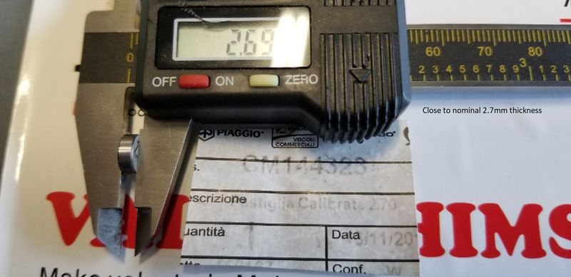

Greetings:
I received valve calibrated tablets from an Asian country with a Large population. The shims measured out pretty much the same as the Piaggio units for 47x the price. They were actually a little closer than the Piaggio parts on thickness though a little shy on diameter. It is possible they came from the same factory, based upon superficial appearances. Lacking the ability to conduct destructive testing, I will use the AF1 replacement parts by first choice, but confident that if I need to use thinner than the 2.55 I ordered from AF1, I should be fine with the AHL units.
A bit less than Nominal, but .01mm seems acceptable.
AHL measured true to nominal
Correct diameter howeve
O.E. Piaggio shims actually a bit shy of nominal
