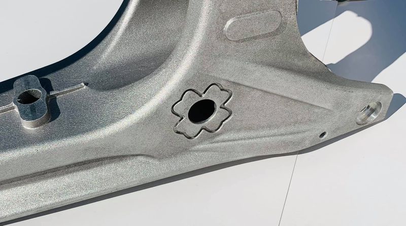

A new alloy racing frame by Crimaz. SF & LF motors can be mounted. Don't know the price but I want one...

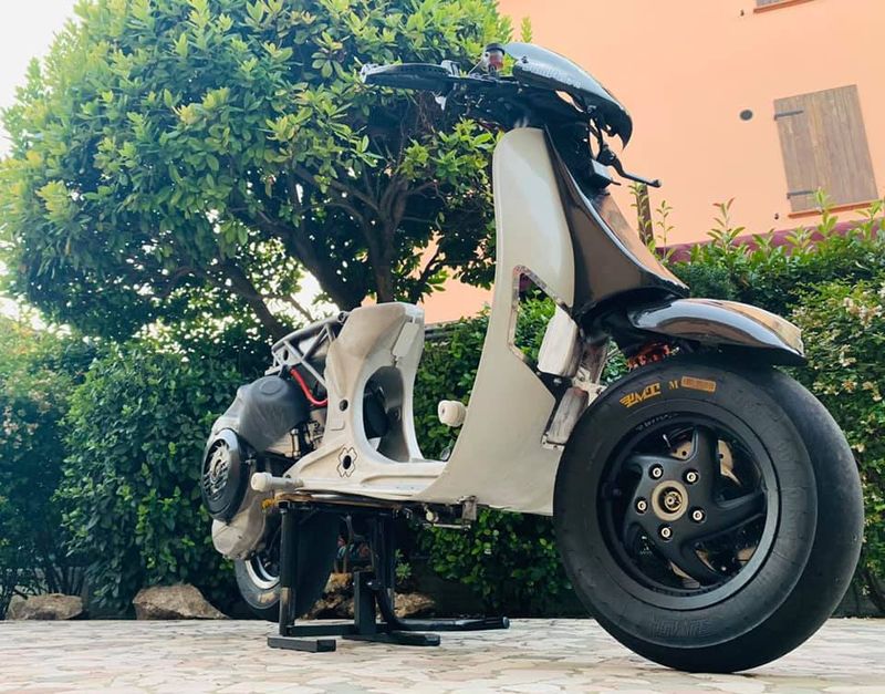

Found two more photos. Terry, apparently you can do anything with it. They run it with fiber glass panels though to save weight for racing...

Where did you see this? Add the fibreglass Crimaz panels and a lump for a crazy racing SS 90.
Or go nuts and make anything? So cool.
Not so keen on the zip fork. Maybe good for racing?

I 100% agree with the frame flex! With the amount of horsepower that's available for smallframes, weight really isn't an issue anymore.
I'd like to see someone spend the time to polish that rough casting up and then anodized it their favorite color.

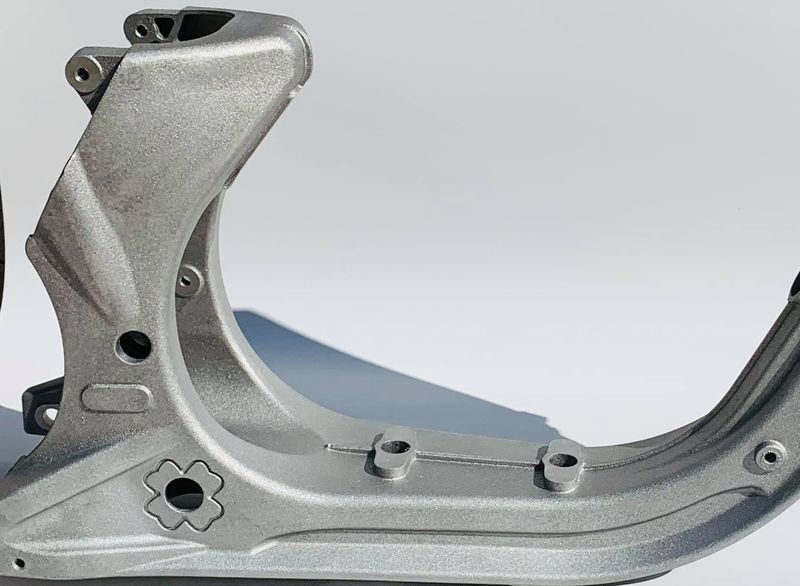

I'd guess it's the same weight as a steel frame or maybe a little more. Steel weighs .26 lb per cubic inch and aluminum comes in at .10 lb. So if the cast frame was on average two and a half times as thick as a steel frame, the weight would be about the same, but the casting will be far stiffer.
Yeah, I'd start polishing some parts of that I think, but just polish and maintain, no anodize.
Looks to be made by sand casting and this is half of the pattern with all the gates and risers on it that get the metal into it and are then cut off.

Here's what's going on. The arrows show where the molten metal will enter the mold cavity after it is poured down the sprue. Looks like it is rigged for a ceramic foam filter as soon as the metal arrives - that rectangular block in the plumbing just after the sprue. That will keep oxides and impurities out of the part.
The red X's are core prints that provide a place to support the several cores that make the frame hollow in some places.

I'm interested to know how it can work for both SF and LF.
The casting process - what can be seen anyway - looks extremely clean!

...and 100% amature welds on the trellis subframe.
