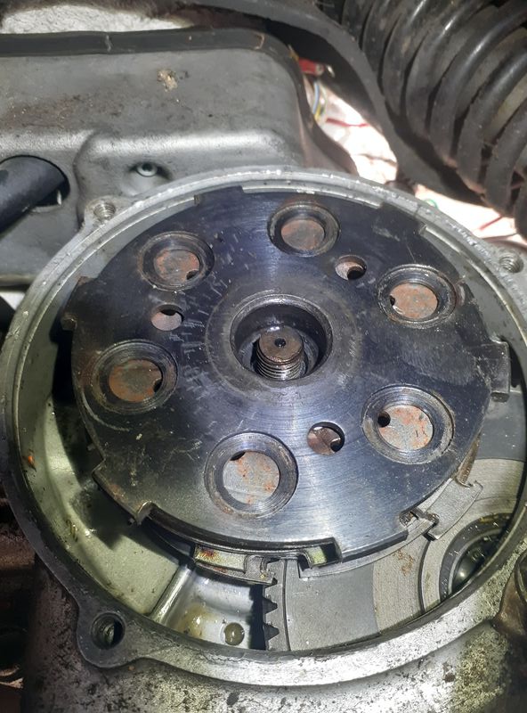

I'm about to throw the hammer..... actually already did. I've removed everything that was necessary and watch a few videos saying all I had to do is pry it out. This thing is not prying at all whatsoever. What gives? I might have already caused damage being so frustrated...

looks like you already removed the clutch basket, and left all the other clutch parts! It takes some skill to do that...
Possibly your woodruff key jammed half in/half out the slot for it in the clutch baseplate? Either that or the metal seized stuck together from being dry/rusty for too long? Penetrating oil and heat in that case?
I'm just taking wild guesses here though..

Isn't there a circlip that holds the entire unit together? That is impressive!

Know how you feel. Was this very situation when my clutch basket exploded. Took hours to pry off. Take a deep breath. Get two big screwdrivers and a can of PB Blaster and start leveraging, slow and steady, round and round.

Yeah I managed to pop the ring from the other side of the basket by prying so many different times/ways on the back side that it eventually just popped out on its own. I just cannot believe how one project could throw so many curveballs. I've had full car rebuilds be less painful than this! I guess more cussing and chaos will continue tomorrow. Only reason I even opened up the clutch was to see if the plates had become stuck together. The bike would lurch hard and die upon putting it into gear, lead me to believe something in the clutch itself was wrong and not something I could correct by using the adjuster. Let me know if that sounds right? Thanks for the responses so far!

Further confirming, there is no doubt Vespa's are female. That clutch is and old style 6 spring. Is the worst type and looks heavily worn. By the time you get it out, probably even worse. I would get a whole new Cosa clutch.
https://www.sip-scootershop.com/en/product/clutch-ferodo-cosa-2-standard_93030000
While buying a whole clutch you have the opportunity to change the cog size, which we all do.
Three leg puller will have that off in a minute.

Yeah I'd have a bearing puller on that... the plates will be scrap...

as said above, two big ass screwdrivers and just levering it out side to side slow and steady. maybe add a little heat to it for good measure.
or a three jaw puller would most likely grab and make short work.
you could also try some sharp blows with a hammer to the crank snout and it might free it up, or assist in getting it off.
either way, protect the thread on the end with the nut!
all that clutch stuff is trash. expect to get a new one, complete.
-g

I definitely own a three jaw puller and will give it the once over. Just wanted to ask again, so The bike would lurch hard and die upon putting it into gear even with the clutch lever pulled in. This lead me to believe something in the clutch itself was wrong and not something I could correct by using the adjuster. Let me know if that sounds right?

Sounds like the clutch has had it...
Had the same problem before... would lurch like it has a turbo...
The clutch basket, brass race and plates were all gone... no adjusting would save it... you need a new clutch... a stock cosa 2 is cheap enough...

BGM sells a nice little clutch puller ... small and simple and it works. You can make something similar by welding a thick washer to a nut and grinding it to shape. It won't help you this time because the basket's off, but it's a good little tool to have for stubborn clutches.

Put some kind of packing under all the clutch parts and tap tap tap on the crank (with its nut on)..there should be enough end float in the crank to get some movement.....other wise ..agree with SoCal..two big screw drivers oppposite each other and lever/wiggle/work your way slowly around. The main idea is to apply leverage to two sides evenly at the same time so the clutch parts are drawn off level

Wow so many great ideas here!! Thank you to all! I tried some big ol levers and I couldn't tell for sure if it had moved much. I'll try the 3 arm puller tomorrow as I didnt have access. If the puller fails will I then have to resort to cutting it off? Funny thing is I had the same issue on the other side of the engine with the flywheel and In that situation I had to cut it off but I went just a hair to deep into the crank itself; which opened another can of worms. Like i said I've never had a project test me on so many levels; truly insane!

if you've already cut the crank it's trash.
beat the ever loving fuck out of it to get the drive plate off, then split the cases and replace all the bits.

Is the cut crank in another post where the woodruff key is shearing?
I'd replace the crank and save yourself some grief...
Removing the flywheel with the right tools and heat shouldn't be a problem... the construction is pretty basic and the torque values are pretty low...

two jaw puller i what i use when the clutch explodes like that and the thing is stuck fast

V oodoo solution
Since the clutch is going to be replaced anyway... weld a nut on, pull with a long bolt.
