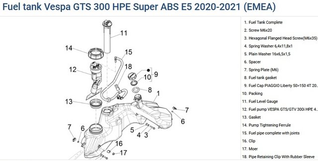

To see what kind of level detection system your Vespa uses, simply look at the exploded drawing in a spare parts list.
