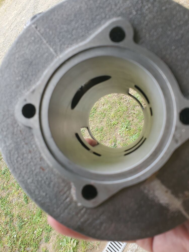

So I head home and take a look in the spark plug hole. Hmm, I think I see lines, so I pull the head. Yup, score marks. AAAARRRGGGGHHHHH
I took the cylinder and piston out and, yup, seize marks. Pinging must've been piston slapping. I've analyzed how I did this, and it's lasted longer than I could've had any right to last. Running without a CHT gauge, running way too lean for over 500 miles with the brass bushing, then letting it go to reserve, like, all-the-time, which is essentially starving the piston of lubrication briefly. But do this over time? Live and learn. And 68 on 8's? Not necessary
So my next course of action: I decided instead of dicking around with just putting rings in, I ordered a new piston, rings, and I have a new wrist pin bearing. Once I get the new setup, It's heat cycle mania for a while, then ride it with a fat main jet, or drop the AC to 140.
20/20 Spaco on the left, 24/24 Dellorto on the right. Yeah, I did a bit of flowing the carb to box...
Dangit, but not too bad looking....
OK, here is the issue. Bummer....

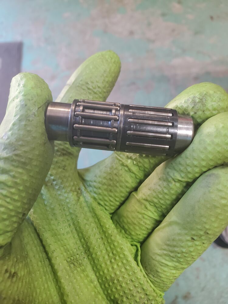

I honed out the cylinder scratches with one of those three legged stones hooked to a drill at slow speed and WD-40 for a lubricant
The score marks are pretty much gone...Now for a new piston and rings, and wrist pin bearing.

qas - just catching up.
Oh no!
And by that - I mean I am devastated about the elephant mug.
Tragedy.
As for the cylinder - hey - it could be worse.
Couple observations/questions
1. Normally with an iron cylinder - when you overheat - you get the 4 corners scraped where piston expands and squeezes against studs. With yours - it looks like it was more dead center on the exhaust port.
2. This piston design has some big holes there - so it probably deforms under heat worse in that area. Maybe a few extra steps of precaution could be in order.
3. Specifically - I'd look at the chamfers on your exhaust port. Pics a little tough to tell - but they look pretty bleak in photos. Might be fine - do you wanna post another shot?
4. Finally - is that carb float drilled? If no - MJ is in the danger zone of not really being effective (read - carb hole is acting as main jet).
Fire back and let us know.
Glad it was relatively minor - at least the cylinder.
-CM

Wed, 07 Jul 2021 05:40:44 +0000 quote
charlieman22 wrote:
Oh no!
Tragedy.
I know man, I miss that mug every morning, and the replacement doesn't hold near enough coffee...sigh....
I chamfered all the ports, but may run the file on them a bit more. No rough edges or anything happening. I did file the inside of the exhaust port - it had an interesting shape to it, so I made it more rounded off.
I'll take a pic tomorrow, but Chris and I are going for a ride up to Yachats, or maybe Waldport, up some beautiful, curvy coastal highway, so I might not get to it.
And all the carbs I got have the float bowl passage drilled out to 2mm. FMP says to go to 2.5mm. What do you think?
But more importantly than any of this - what's up with the Orange Unicorn not being on the road? And why doesn't KITT have it's brain yet? And what's up poking a stick at the Aussies? - Heh heh...

Wed, 07 Jul 2021 07:15:52 +0000 quote
1. I'm glad you noticed it was actually BOTH Aussies. Took a wild swing and one of them didn't even notice! Was just making sure they were alive and well down there. They know I love them.
2. Assumed you had done a nice chamfer - pics were tough to see tho - but it clearly wasn't ring snag in any event. Piston definitely expanded where it is weakest - around those large holes. I was just thinking about trying to hedge against the weak spot now that you know how it will want to fail. Personally - I like my chamfers a bit taller on the cylinder wall than depth into the port, and I use a Dremel drum sand wheel to achieve.
2A. Best guess would be MJ related lubrication based on how it seemed to fail.
3. I've landed at 2.3 as my standard. As long as you can make it refuse to rev out with a main jet that is too large - you know it is feeding enough. Simple test is to whack a giant jet in there and see if it just doesn't wanna go past about 5500-6000 RPM. Means your drilled hole is large enough. I struggled to tune my 2.5mm drilled hole at one point - tho Im not sure that was the reason.
4. The unicorn and Kitt. I have been on the road for 2 weeks. Just back. Practiced using the mill today on the spare cases. No idea what I am doing - but trying to figure it out before I cut my actual cases. Miss it.
5. The mug. Heart breaking. I felt it. Keep an eye out on your rides for a proper replacement. Don't be shy about buying a few that just don't stack up. Give them to charity. And should you find a crawler and a cup of coffee so fine - that you know you must have that mug - I personally give you permission to quietly slip it in your jacket pocket when empty. Just sayin'

Wed, 07 Jul 2021 07:31:36 +0000 quote
Way too lean. They seize like that when way too lean. Run super smooth but just overheat.
Good job on the hone. Run the old piston. Nothing wrong with it. A few battle scars are expected.

So check this out. I put the new piston in and after about 50 miles I started to hear a tinging again, like the piston tapping, just like after the 2nd time it soft seized. This is with the new piston and new wrist pin bearing.
So I took off the cylinder to inspect. What I found was the wrist pin bearing was .20mm smaller than the original one that came with the Pinasco 177 kit. I also noticed some lateral play in the conrod that I don't remember being there when it was new. I even checked out the movement compared to the original 125cc crankshaft and there was a fair amount more movement. I didn't think much of it at the time, but it comes in to play. I'll explain shortly.
So I put the old bearing back in and reinstalled. Pressure test, etc. Put the engine back in and the ting seemed to be gone. I was all ready to celebrate but I noticed the engine getting louder and the ting came back today. Dangit!
I went back through my mental notes of what was what, and I'm beginning to think that the big bearing on the conrod was the real damage, and not the wrist pin bearing.
BUMMER!!!!
So I'm going to pull the engine and see just how much play is in that conrod at the big end. It's gotta be what's causing the piston to be slapping like it is.
I'll dig into it later this upcoming week. I want to just ignore it, but it's not going to fix itself....
The bearings, Pinasco on left and new on right
