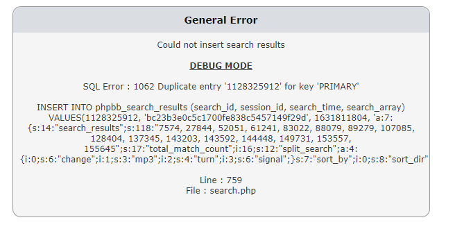

My search function doesn't work on the forum... (see attached).

I spoke to the website owner. The search issue you encountered is a known issue and once your session ends search should work for you.
