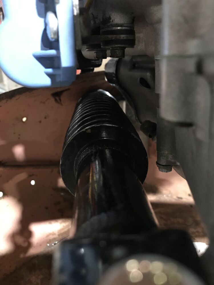

how did you cut that off the cylindrical portion without making a horrible mess of it? it's so clean
Thu, 31 Mar 2022 17:38:54 +0000
parallelogramerist
Joined: Mon, 26 Oct 2015 23:20:12 +0000
Posts: 4154
parallelogramerist
Posts: 4154
Thu, 31 Mar 2022 17:38:54 +0000 quote
SIP's "grade A perfect repair" TIG welds only penetrated about 1/16" (if that?) into the material. And it was only welded on the outside, not the whole perimeter of where the two pieces joined. It was more or less a "score and snap" to remove the flat portion of the bracket from the cylindrical portion. SIP's welds were most likely strong enough for the intended purpose, but still...
I made some time this morning to reweld the bracket together where I wanted it to be...while opening up another can of worms. The cylinder head now fouls out against the frame...of course

For me a Tonya Harding (a hammer) would fix that head fouling the frame situation real quick.
You may have better plans.
Heat and Jeff Gillooly's hammer would probably have done the trick, but I ended up cutting yet another notch into the frame. The main benefit is that I now have socket and wrench access to the engine case's swingarm bolt. Without that access, the SIP engine mount adapter would have to also be unbolted from the frame, and the long bolt (that passes through the original VB1 swingarm bolt location) would have to be loosed up as well.
I now also lack any sort of clearance to fit the plastic cylinder shroud over the cylinder. But I'm going to try to use heat and a hammer to gain the little bit of clearance that I'm after. If that won't work, then I'll just try a larger hammer.

For the past week I've been wondering if the exhaust will fit up with no modifications. Well let me reassure you that it too will need to be "warmed over" a bit as well. I mocked up a random Sito+ on the engine, and it fouls out against the underside of the floorboard...of course.
I'll also have to come up with a solution for aligning the rear shock as well. Currently in order for the shock to line up with the engine mount, the upper shock mount would have to be relocated a full 1" out further than where it is now! I'm thinking about making a lower offset shock mount. I think that would be the least evasive option at this point.

Before I go any further, I really need to get a fuel tank. The scooter didn't come with one when I bought it, and if it had come with one, I'd venture to guess that it would have been rusted to death. Currently the T5 carb box cover sits so high up into the frame, that I might actually have to notch the fuel tank as well! Hopefully not, because if that happens to be the case, then it could also mean that I might have gravity fuel delivery problems too. So right now I'm contemplating on either buying one of those fancy oversized "Six Days" fuel tanks. I've done a few local ISDE (International Six Days Event) enduro races on my KTM dirtbike, so I'm all about building a sei giorni tribute, but at the same time I like the super clean round lines of just having a single saddle seat and no rear racks or anything. It's going to be a tough call for sure.
And it's a relief to know that the engine seems to fit fine under the cowl. What I did realize though, is that it will be a pain to fit the rear wheel over the rear disc brake assembly. I'll have to remove the lower shock bolt and swing down the engine in order to gain enough clearance to slip the rim on.
*i was just looking closer at my pics, and now I'm wondering if the kickstart lever will foul out against the floorboard. Answers on a postcard.

what kind of tank does that beast take?
man, talk about pound to fit and paint to match. what a doozy.
if you got the room to move the shock, that would be my first choice. but I don't see a relocation bracket as a problem to be honest.
do think some type (read anything tuned) of pipe might be a better fit and not foul out on the floor board because it kicks down a little further?
no kick start, just push start. problem solved!

The frame is a VB1T, but it looks like some of the early GS tanks fit as well?
https://www.sip-scootershop.com/en/product/tank-sei-giorni-style_752072L
https://www.sip-scootershop.com/en/product/tank-sei-giorni-sport_752072XL
https://www.sip-scootershop.com/en/product/tank-sip_75207200
https://www.sip-scootershop.com/en/product/tank_75207210
There doesn't seem to be any room to move the shock, but i'll definitely take a 4th looksee.
I tuned style pipe might fit better? But i'm guessing that pretty much whatever exhaust that's mounted up is going to rub.
No kickstart...that's how my T5 trackbike is setup. I removed the kickstart gear and used a dummy quadrant inside the case. It's not optimal for push starting up hills, but luckily it always started up very quickly.
The other difficult find will be a seat. I'd really like to find a used one, but new might be my only option. https://www.scooter-center.com/en/saddle-oem-quality-vespa-vl2-till-vl3-vb1-central-spring-7673342?number=7673342

I haven't decided yet if I'm going to use a stock PX shock or an aftermarket SIP shock. There's enough room to fit either shock in there (the SIP shock has a smaller diameter spring than the OEM PX shock). I did temporarily "borrow" the SIP rear shock off of my pink PK200 for mocking everything up today. As of this evening, the SIP shock is reinstalled back on the PK200.
The next step is to decide just which shock I'll be using. I'll then have to find out how much stroke the shock has so that I can figure out how much uptravel there will be. Once that is figured out I can start clearancing the frame so I can have room for the airbox assembly. I think I'll probably choose a SIP shock because if I remember correctly, they have less shock travel than an OEM PX shock. Normally limited shock travel is a bad thing, but it might work to my benefit in this application.
I spent the extra time to make sure that there will be zero binding or side load on the shock's shaft during the entire stroke of the piston's travel. I also now won't have to offset the lower shock mount inward. So a win win for me.
Plenty of room around the airbox with an OEM PX shock.
And plenty of room with a SIP shock.

I did some more work on the scooter this evening...
I ended up deciding to use the polished aluminum rear SIP shock that was on my Pink PK200 (which meant that i bought another SIP shock for the PK, but in a black color). I remove the spring coil from the shock body so that i could easily cycle the suspension in order to check for frame clearance. I decided to use the long upper rear shock spacer nut on the shock. It's going to raise the back end of the scooter up probably close to 1.5" higher than stock (plus factor in for the 10" conversion), but it will allow for less frame cutting and HOPEFULLY i'll have less of a chance of gravity fuel flow issues since the carb will be that much lower than the bottom of the fuel tank...we shall see.
The tie down strap is being used to compress the suspension to full bump.
