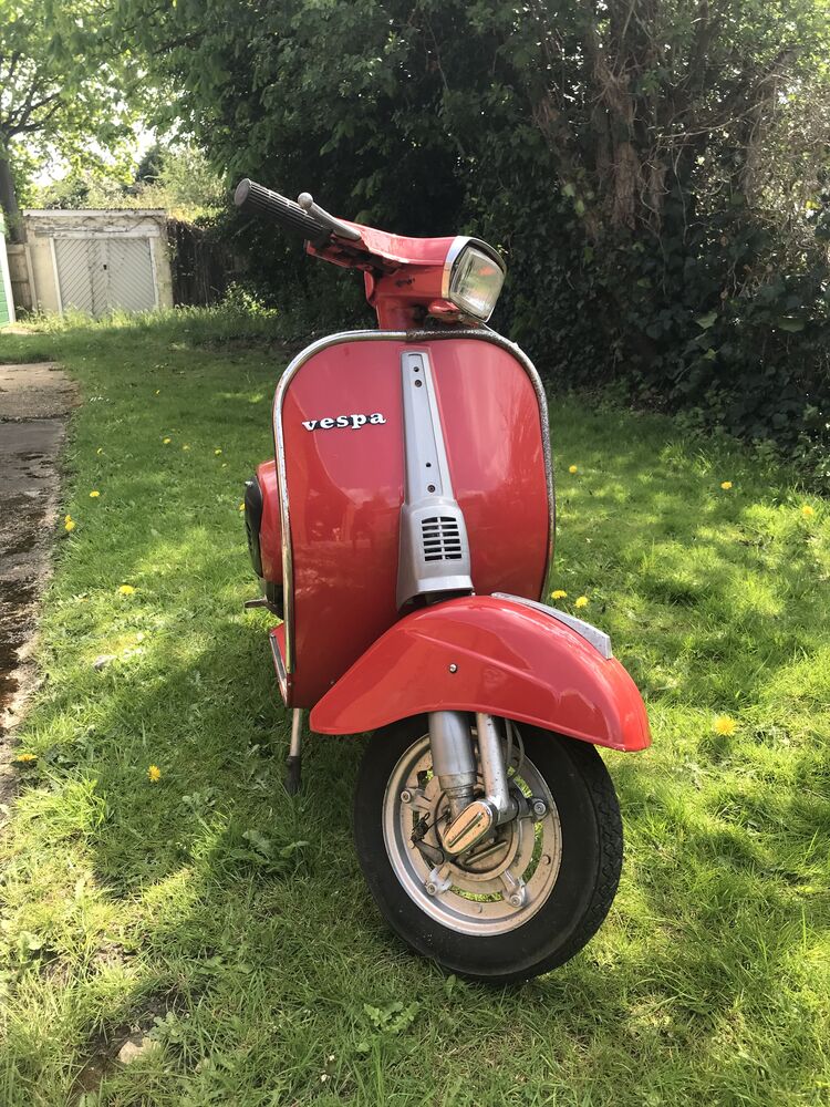

Picked up a new to me Vespa 50 Special today.
Been sitting a decade or so. Seals, a DR 85 kit and probably some tubeless rims are the plan along with a body tidy up and single seat for it.
My new toy.

Right on! Will make a great project.
More pics please!!

Here are some more photos. It's a uk delivered bike, it's frame and engine no's are quite different, the frame is probably from 1981 but wasn't registered here in the UK til 1983.
A few bits of rust under the paint in a few spots.
It missing things like the rubber and plastic buffers that go around the side panel which is why probably the original one looks like it fell off. The floor rails are screwed on rather than riveted.
I couldn't work out what was wrong with the look of the front end until I realised they had the wheel on backwards.
Clutch is sloppy so new corks, I have a sebac rear shock from my et3 goody bag so will probably install that.
It's certainly a smallframe.
Wheel on wrong way round
It's got an ET3 style rear light on it. Not sure if original.
A few rust spots. The paint polishes up well so will see if I can get away with treating the spots and blending new paint.

Hmm still thinking about it greasy.
The bike is now all pulled apart and I have degreased and cleaned the parts and body.
I think all the crud that's on the clutch was actually muck coming in via the breather. The petrol tank and carb were really leaky which covered the engine in crud.
The bike was definitely resprayed, unhelpfully they really only prepped the outer panels. The rear wheel arch has lots of surface rust under the paint and the under seat area paint all fell off to reveal the original grey undercoat and surface rust.
If the prep wasn't very good on most of the bike is there any point trying to keep the paint on the front of the legshield and rear tub?
The rear wheel arch. It looks like they sprayed over dirt they hadn't cleaned off.
Under the tank. Before I degreased this was red.

Update on progress
I have most of the parts I need for the engine delivered now and the engine cases have returned from the Vapour Blasters. Now the fun part begins putting the engine back together.
I was thinking of spraying the cases with ACF 50 to protect the cleaned cases from greasy marks while I build it. Is ACF 50 ok if it gets on some of the inside of the engine faces or should I use it only once the engine is closed up?
Cases after vapour blasting
Claus mounts are in and new bearings are in the feeezer.
