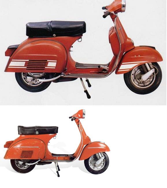

SaFiS wrote:
Is it the short one or the longer one found on Rallys?? If it's the short one, get one for a Rally 200. It's longer so gives a bigger leverage. I would avoid FA they're made of cheese…
Oh no! I was just going to buy one of those.
The FA Italia ones are the ones I see that are the same shape as the original. Looks like the GTR and Rally are the same.
Looks close.
Looks much different.
Rally and GTR are different. See where each one ends. SIP's kickstart is for a PX engine on an old chassis, so not compatible with original Rally engine...
FAs are OKish but tend to wear fast...

Tue, 10 May 2022 23:08:42 +0000 quote
It is shorter!
It's a shame. The original ones had that Piaggio shield badge. But mine is totally scraped away and worn at the end.

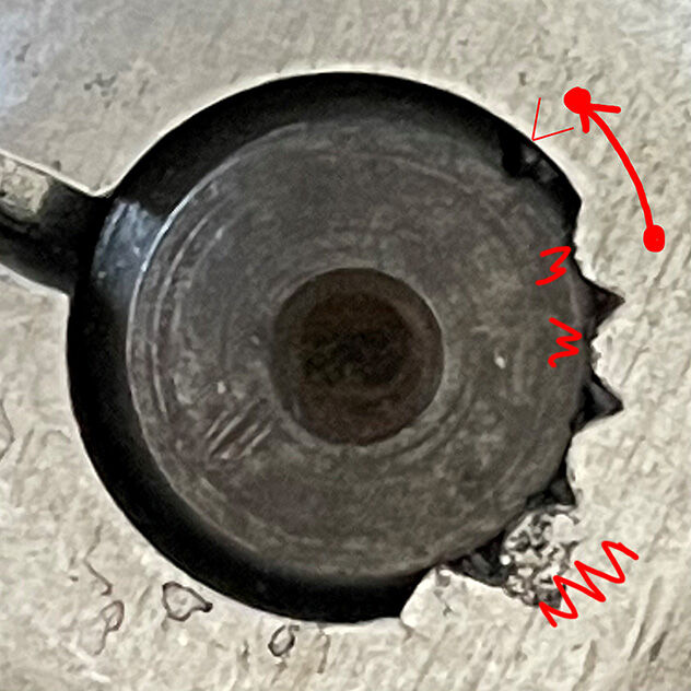

Sat, 21 May 2022 13:24:21 +0000 quote
Hi, opinions on the quadrant shaft condition please?
Doesn't look bad to me. Yet to receive the new kick start lever, meanwhile removed the old one, completely destroyed
