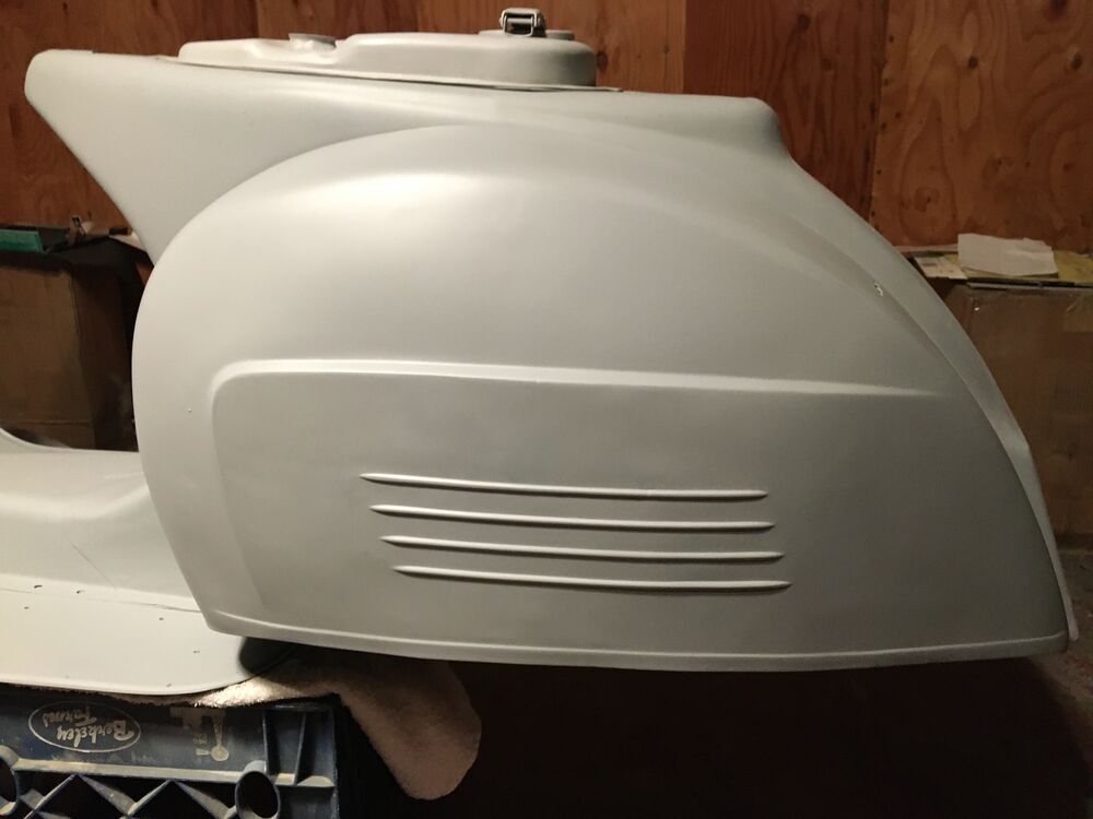

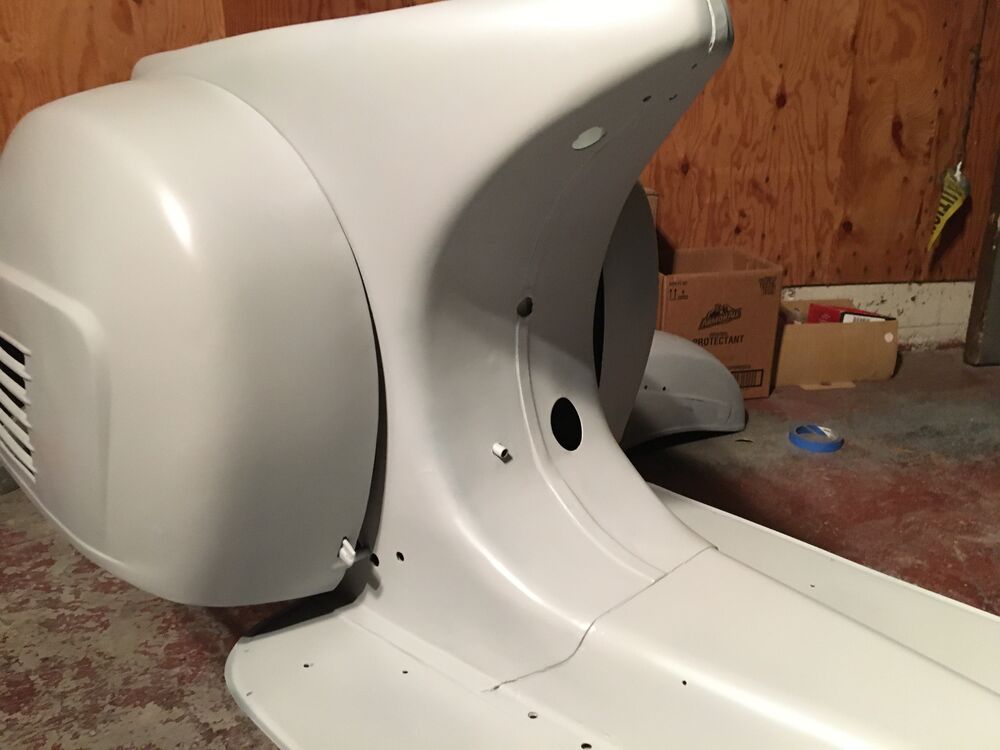

This is so much work.
Got it to the sanding primer phase, but in a light solid color, all the flaws come out. Lots of dings and dents I hadn't seen.
Getting closer.
Seam sealer
The seams need a little clean up. :)
The tail looks so wrong. I hate it! I will straighten out the metal, but it feels like it's too long, and not square.
I didn't even notice this dent in the horncast
The cowls have so many dents, I didn't even see until now.
The frame bridge is definitely not perfect. But the replacement part was a little different. The curve isn't exact.

I know you measured, that tail several times something still isn't right. Do you by chance have access to a self leveling laser level with a cross beam pattern? You could use vertical beam aligned to seam coming down rear fender, and adjust frame platform until those are aligned. Then align horizontal across bottom to see where you want to be.
Sun, 05 Jun 2022 11:45:53 +0000
Lucky
76 Sprint V, 63 GL, 62 VBB, 05 Stella, 66 Smallstate
Joined: Thu, 16 Jun 2011 14:59:35 +0000
Posts: 8745
Location: Nashville
Lucky
Posts: 8745
Location: Nashville
Sun, 05 Jun 2022 11:45:53 +0000 quote
Getting all those little too-small-to-see dents is always tricky. I have a multitude of them on my VBB, in particular, that I never noticed until I was past the point of doing anything about them.
Your scoot is going to be gorgeous, and you're the only one who's going to notice any of that. I can't even tell where you repaired the tunnel bridge now that it's in primer, for instance.
Keep on pushing forward. You're on the home stretch now!

Scratch coat reveals all defects. I am assuming that's your next step.
Sun, 05 Jun 2022 15:58:14 +0000
Joined: Fri, 14 Oct 2016 21:32:14 +0000
Posts: 2492
Location: northern New York
Posts: 2492
Sun, 05 Jun 2022 15:58:14 +0000 quote
Agreed. You knocked that tunnel repair out of the park. I can't see it either and fudged joints and body lines really irk me.
Sanding a guide coat will probably reveal a handful of minor imperfections, but do it. It feels like the last and hardest mile, but totally worth it with the quality of work you have done. This is why projects like yours can look better than a professional resto.
Really makes me smile to see someone dive in, learn new skills, struggle, stick with it and make something beautiful.

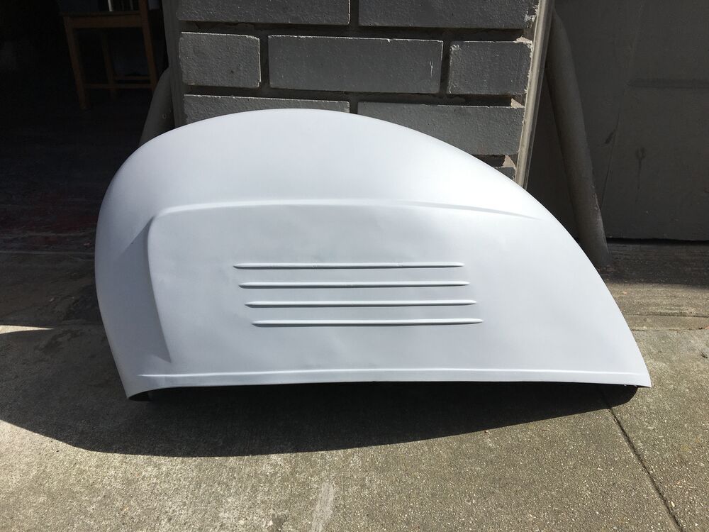

Another round of hammering on these things.
I might take a few days and not think about this. It's painful.
In direct light, they look better.
Light/shadow still reveals lots of flaws. But I didn't skim coat or anything.
Replacing them is tempting. Though I'm sure the original ones fit better.

Some of those rally cowl repops fit really well. I had a pair and fit was 8/10. The stamping is Very slightly different than the originals, with less definition in the louvers and the sharpness of lines. That said, after paint and once on a scooter; they are only distinguishable to a discerning eye.
Your cowls aren't that bad. Keep up the good work, it will be worth the effort to use the originals.
You are discovering first hand why good paint and body work is so expensive.

Yep. You can see that the stamping is different. I'll try some more work on these. I have the ones from the other Rally, but I think they're worse. There's a hole rusted through, and one needs the peg welded back on.

And thanks again Birdsnest for the paint! I got another quart mixed. The Glasurit paint shop said it's the best quality single stage paint.
The Glasurit shop is like 40 miles outside the city.
Guide coat.
One of their paint jobs.
Piaggio Biancospino 715. It's amazing you can just tell them the code.
Getting closer
The dent on this one is the whole center of the cowl. but it seems to be coming out. It's much better.

Wed, 08 Jun 2022 10:42:39 +0000 quote
Those cowls look like hard shapes to work with.

Wed, 08 Jun 2022 12:04:16 +0000 quote
Those cowls look like hard shapes to work with. The transition from curved to flat is tough. Similar to vbb cowls in that they are flat across the middle.
Keep at it. You still have some wavy in it. It's the high spots that end up giving the most trouble. You want to get them level or slightly lower. The hardest part is finding all the things like this. They don't smack you in the face until the colour is on.
It's still gonna look smashing. I find this forum really helpful and supportive. No one seems overly invested in claiming their way as the right way.

Wed, 08 Jun 2022 15:28:08 +0000 quote
The righthand cowl is looking pretty darn close to finished. Only unwanted shadows I see in that picture are on the flat just in front of the louvers.
The lefthand cowl has a lot more work to do, though. At least you don't have to basically work inside a bowl b/c of of the glovebox floor hamming out like the VBB or GL cowls.
Are you using a metal rule to assess flat areas (with the edge) and curves (by laying it flat?). That's a great technique I learned from the RestoLad videos (which I think Ginch first pointed me to) if you haven't watched them.

Fri, 10 Jun 2022 04:44:18 +0000 quote
Closer and closer.
I almost have the cowls. Spent hours mostly tapping on them. And the shape really comes back. You can get it to where there are just tiny highs and lows in spots.
This has been fun to learn.
And it's amazing. Like building and refining layers. And everything beneath them is as it should be. No rust. No damage.
And it's all so workable.
I was watching a repair video where the person said "Don't worry, everything always works out in the end. Because you keep fixing and working until it does."
There are visible highs and lows, but they are really slight.
I got the shape on this one. It was really damaged. Like pushed more flat everywhere.
I had thought this cowl was almost perfect, but the patina and dull paint hid a lot.
I just see one dent in the sun now.
The spots to fix and glaze are getting smaller.
This one is closer.
It's not quite there, but just some small spots. The shape looks right, too.

Fri, 10 Jun 2022 12:35:31 +0000 quote
Much better.

Fri, 10 Jun 2022 13:28:21 +0000 quote
There's something immensely satisfying about watching the dents melt away under the tapping of the hammer.
It's also amazing to me how little force is required when you're doing it right.
It's looking great! Much better in the sun now.
