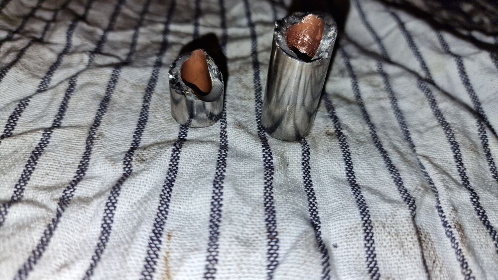

Well today I finally managed to get the piston pin loose. Luckily I don't see any damage to the crankshaft. I don't trust the piston anymore because it has 2 impact points in the corners, probably because the piston has risen further and bumped into something.
Piaggio has crazy prices. A piston costs 198 euros and a complete set is 258 euros. Always thought that the cylinder is more expensive than the piston. So I buy a complete set because then I get rid of the bad feeling.
For now thanks everyone for the help and advice. I'll be back when I'm ready, and will Then make an overview for someone who may also have this problem.

Have you checked to see if Malossi sells a piston kit?

Yes, it is also available for the HPE. But I don't know if the original cylinder head will fit, I certainly don't want to buy it. And I have read that it does not provide extra power, but it does last longer, and possibly also less oil consumption. But the amounts differ between 340 and 550 euros, so I'll stick to the original.

I think if you install new rings and a new jug, and perform 5K oil services (with the proper recommended oil) then it should cut down on the oil burn. Keep in mind that the oil rings need to be installed 120 apart, kinda of like the Mercedes star if that makes sense
These newer bikes can only pass emissions by not burning oil.

So I don't know whether the oil consumption will be less after a new cylinder and piston. It should of course, but because the engine already consumes oil from new. Robot from youtube the vespa specialist has also said more often that they consume too much oil My previous mp3 really didn't consume any oil and after 5000km it was still up to standard.Yes thanks for your advice,I've experienced that mistake once with a 50cc haha.The piston and cylinder weren't happy with it.I also first put the piston in the cylinder to the last ring and then I put it on the crankshaft, then I have not messed with those rings. I will order it all next week and then assemble it.

Well the worst has happened. When loosening the bleed nipple, the torx broke off in the bolt. There is no way to get it out because it is completely flat. The only solution is drilling, but if that goes wrong, it becomes a new cylinder head. Really everything about this stupid thing goes wrong. It's a miracle that it just runs well. So I can't go on without getting that bolt out.
Does anyone happen to know if the length of the nipple in the cylinder head is the same as that of the thermostat? They don't sell the cylinder head nipple on easyparts, but they do sell that of the thermostat.

before you start drilling have you tried a strong neo magnet, if you have any old computer hard disks floating around open them up some good strong magnets inside sometimes

That's certainly a smart idea. But I think I already ruined it by trying to loosen it with a pair of needle-nose pliers. I also put pressure first so it wouldn't spin, so it's firmly in place. But before I start drilling, I'm going to try it with a strong magnet, I still have a few of those. Really stupid that this happened, should have made sure I used the new bit.

Well, there is a another solution without needing to worry about bleeder screws, air pockets, etc or in your case removing the head & cylinder jug again.
The solution is to vacuum fill your cooling system, the same way they do at automotive factories.

That is a nice system. Especially because you then know that there is no more air in it. If you do this daily then it is very handy.
I continued today and unfortunately the drilling was not successful. The drill continues to shift next to the broken bit. I already ruined it by drilling 2 small holes. The bolt is still there and luckily no leaks.
But because I don't just give up, I continued to look at the system and tried again to bleed it. Strangely enough, the whole system is now warm. Coolant is also warm. Fan switches on and switches off again, the temperature also remains in the middle. If there were still air in the cylinder, the temperature would rise high and the fan would not have a function either. Drove a few rounds and everything remained good then. The air must be out by now, otherwise it would overheat.

well might as well get a small dremel disk on it now, and turn it into a flathead screwdriver if you can, or a drop ,of superglue on the broken end and see if it sticks enough to pull the broken part out

yes I know you have to drive in. But it's not fun haha. I also avoid highways for a while. I will now check oil much more often. Also be sure to check that it doesn't drop. I also keep an eye on coolant. This should stay the same now, if nothing is leaking. I can first hope that I can reach 1000km
I was thinking about this too, but I think I screwed up trying to get it off. It's really an annoying place to recover. And the bolt itself I did a lot of work on, it looks like a child has been working with a drill. But if I have the mp3 at home I have some more resources to work with, so maybe what you say will still work.

Good on you if you got the system bled without any remaining air pockets.
If I were in your shoes, now that the system is free of air, I would once a year only suck out the expansion tank and refill with fresh coolant, wait a week, and repeat the same cycle over a 4-5 week stretch.
That way, you'll never have to deal with this cumbersome bleeding procedure and you'll have fresh coolant in there year round without ever going through this painful route again.
Takes less than 5 minutes and is a sub 5 Euro investment (some aquarium tubing and some coolant)

Yes, not only the cylinder and piston were a burden to assemble, but nobody expects something like this to happen during venting.
That's a good idea not to let it drain but to suck it out. Coolant can last up to 5 years, but it is always recommended to replace it every 2 years.
I think I was lucky with the bleeding and that everything has disappeared through the expansion tank and bleed nipple. I drove another 20 km yesterday and everything remained as it once was. Then checked the oil and it still looked good. Coolant was also up to standard so it looks good. Can I call myself an MP3 mechanic now?

yeah i just hope i never have to vent again haha. I will eventually try to get the air screw out for the next time I change it.

Honestly, I really think you are looking for trouble if you're going to try to get that screw out.
You got away with murder once, don't expect to be that lucky again. Just remove the coolant from the expansion tank and replace only that portion over a period of a few weeks. It only costs a couple of Euro for some aquarium hose and a few minutes of your time.

Hahaha you give a text with a background. Nicely worded But you are right, if I choose that way as you say, little can happen. This is also best done when the cylinder head is off, and since it has just been put back on I'll leave it like that. Have already driven 110km and it still runs great. It is currently quite warm days here, and the fan has been on 1x during busy periods on the road. So the air is definitely out now.
