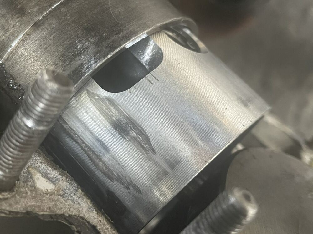

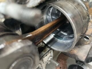

Hello!
I've decided to stop busting @Jim van Morrisey's and taking this discussion to a wider audience than our chat. Thanks for the help so far Sean!
I have a PX200e since a couple of years ago and I've been restoring it stock. It is important to mention I live in Quito, Ecuador (2,800m above sea level). This is my 3rd Vespa. I'll share some photos of the other ones later. (PX150e & VBC)
I installed a 2nd or 3rd OS Meteor piston (Scooter Center) to address 'lack of compression' from the previous one. At first I didn't realize the bike had a 94 main jet and one of the idle jets with the solid top. The bike had a very hard time going uphill, and it seemed to soft seize/stall in urban uphills.
I chatted with @jimvanmorrisey and followed his advice to install a 160/55 idle and a 110 main. (160/BE3/110~).
~. However, the local mechanic had to fit a small copper filament from a wire to make it somewhat smaller, as it was bogging BIG TIME and with flooding symptoms all over the place without it. It is not easy to find jets here so that is the local fix to make them smaller. Still larger than the previous 94. The bike is much more awake and powerful in flat rides and does small urban uphills in 3rd just fine. I was confident enough to try a longer ride today (1 hour, 300m altitude change) and things were fine flat and downhill. I checked the spark plug and saw the chocolate color for the first time (photo below) so I decided to keep going.
I had a couple of soft seizes that I controlled with a fast clutch action when going almost WOT or WOT in 3rd for a small period. 4th gear seems not as powerful but I think this may be because im still running in the new piston.
After a 30 minute stop at the lowest point of the ride, in the city suburbs, we took a faster road uphill and the bike seemed to struggle in 3rd and 4th gear,
or not be as powerful. As if it doesn't 'develop', we say here. Running in period?
The big issue came again when heading uphill towards the city. The bike stalled/soft seized at least 4 times and I was getting anxious. Clutch saved me every time! I saw the spark plug half way uphill and it seemed whiter than before, but not too much. still pretty chocolate. However, it was VERY HOT to the touch. I opened the mixture screw half a turn out of instinct, and managed to get the bike back up into the city after at least a couple more stalls/soft-what-nots.
Please share your thoughts! I've spent hours reading Aviator's posts and others I don't remember the names now but I've finally decided to ask for specific help!!! I'll be splitting that top end this week to see how is that piston doing. Probably check the rotary valve with a feeler too.

Thanks to all for your replies! I popped in a 114 (+ Cu wire - see photo) jet this morning and it was very boggy around the block. I then popped a 112 + Cu wire MJ and the bogging was gone for the ride around the block. The moment of truth will come when I try this setup uphill next week.
MJRally, I'm currently on that running in period. I haven't been able to ride without the soft seizes or the bike drowning/flooding when I had the 110 MJ + no copper wire, or even before, with the blocked-on-top idle jet. I've probably done 40 miles since the piston change. Probably, there's been 10 stall/soft seize events in that period. I'll take out the cylinder head to check for damages. How to know if this new piston and cylinder heads are still in good shape?
The only mod I have done is the drilled air filter, ~5mm and 7mm separate holes. The exhaust pipe is stock. This is a new piston. Do you mean I need to replace the piston again?
Could it be an air leak? A faulty rotary valve? I don't know where to look for the damage and it has kept me from being able to use the bike. Very frustrating if it weren't for you guys, and Jim van Morrisey, haha.
FINYoshi, thanks! I'll look up for your previous posts on pressure testing the engine as I haven't heard of this before. Is it the same as compression tests for the piston?

I opened the case and the cylinder today. There weren't any signs of deformation in the cylinder. The piston has these marks but they aren't sensible to the touch. There was a gas scent in the gearbox oil so we'll be replacing seals crank side and clutch side too. The gasket between cases is also gone, but didn't show evident leaks on the thinnest part, however that gasket will also be new.
How do you guys see the piston?

It should be ok. Show some better pictures when it's completely off. It was running very lean. Top of the piston should be generally black with a wash pattern when running well.
Pressure test the crankcase before putting the clutch on.
The lighting was very bad that day at Quito's Vespa Servizio! The piston had an even thin black layer. Those spots were done by my fingers at a very gentle touch.
The best I could do that day!

I expected the piston and cylinder to look way worse given all the soft seizes you described. Worse than finding a problem like an air leak is not finding a problem and dealing with an endless mystery. Glad you are getting it buttoned up.
