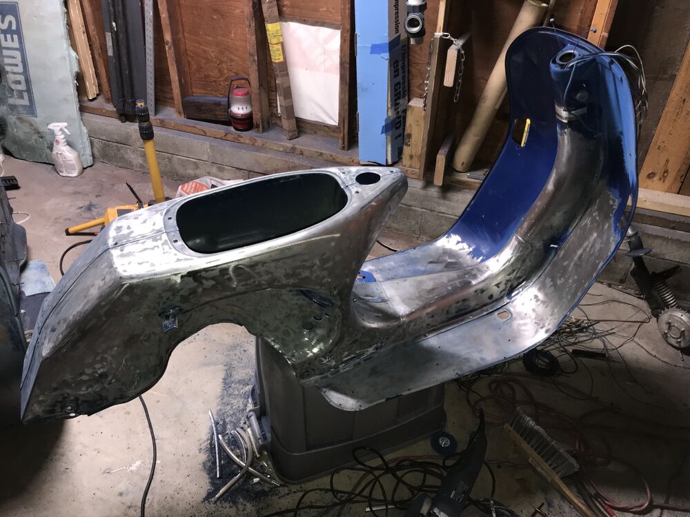

Went for a nice ride on Friday. Tried 140/BE5/115. Had spluttering in upper range so threw in a 112 main which mostly cleared it up, but may be too lean. I definitely need more jets. I haven't been doing plug chops as I am hoping to get in the neighborhood of the correct range before I go through all my new plugs. I was also running an undrilled air filter as I misplaced the drilled filter when last swapping carbs. I will need more jets. The weather has since turned to shit and will pretty much stay that way until April.
Back to the 200. Bottom has minimal surface rust. Might give it the same treatment as the tunnel.
Tempted to just respray the whole bike.

eastwood fast etch and owatrol oil will protect that

Yes, it's not real rust. This may end up more of a restoration, though. The paint is the same color, but not original, so repainting it would not end up as patina destruction. The respray is chipping/peeling in places where prep was not as good. A 77 P200e is not a typical candidate for this, but I have wanted one since the late 80's. Will see how it goes. I got all winter and one rideable scoot so no pressure either way.

yeah you have choices - the underside need not match. you can go with the simple I proposed or paint it or treat / prime / paint / truck bed liner or whatever catches your fancy. but if you're going to paint the rest of the bike then i think it's pretty clear what will happen on the bottom

I will probably use the same Master Series stuff I used on the underside of my bus. It's nearly bulletproof and meant to be applied with a brush.
I brought the VBB down over the weekend. I was surprised to find that the P series is almost exactly the same size. The VBB actually slightly wider at he legshield and the tail slightly longer. The P series bikes always seemed larger, even taking into account the 8 vs 10" wheels.

Stripping the 200. At first, I was only going to do touch ups, but got to the point where a respray made more sense. The previous respray was laid down thick…too thick for just scuffing and painting over it. I'm using a grinder with a fibrous plastic stripping disc. It removes paint without damaging metal.
I use a number of techniques to mechanically strip paint. I reserve sandblasting for rust. There is not much rust left and only a small dent on the legshield to work out. No bondo on it.
Also stripping the VBB as I work on the metal finishing. I'm hoping to complete all the prep, then bring them to a shop near where I work for the topcoat.
Jets are on the way for the Stella. If we get the odd warm day, I will try them out.
Really pleased with how the legshield is coming out.

Paint stripping has to be one of my least favorite jobs. It seems to take a long time but I only have a few hours in. Now that I'm in a groove, it's going faster.
Wondering what type of paint people have used when restoring Vespas and how it has held up. My first choice is 2k urethane but 2k acrylic enamel is less toxic. I'm still on the fence about top coating it myself.
Also wondering igniting is possible to replace the stamp sticker at the top of the tunnel tube.
Thanks

Tue, 29 Nov 2022 14:05:51 +0000 quote
SoCalGuy wrote:
Urethane.
Yeah…single stage urethane would be best.
Making decent progress. In some places, the respray on this is really thick…other places quite thin and peels off with masking tape.
The VBB should be easier as it just has a layer of awful rattle can over everything…including the cowl rubbers. A lot of the original paint is in good condition, but sadly not enough to preserve. One of the side cowls and the mudguard are also from different colored bikes.
Getting there…

Wed, 30 Nov 2022 13:37:28 +0000 quote
More stripping and blasting. This bike shouldn't need any filler work.

Watching paint come off is slightly more exciting than watching paint dry, but I'm pleased with the progress. It would be great if I could have both bikes ready for paint by the end of January. That would give me enough time to assemble both of them in time for the start of riding season. Around here, that's like mid May.
