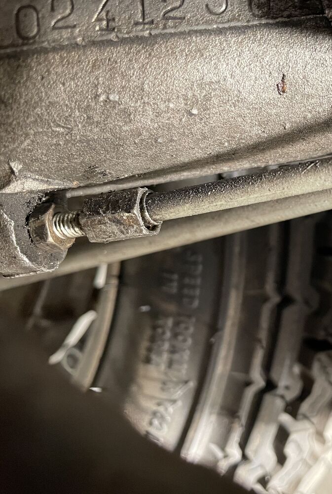

Good new gents, stud seems to be fine. The old nut was stripped. Seems like a PO might have had some hardware store bits on there. I preemptively ordered a new stud so at least I'll have a spare on hand.
Luck smiled on you! While it's not the worst job in the world, replacing a broken hub stud can be a bit of a kick in the nut.
I order nuts and washers in bulk so I'll never hesitate to throw one out if I don't think it's up to the job. Also, you'll find that quality parts in bulk are significantly cheaper than the hardware store, too.

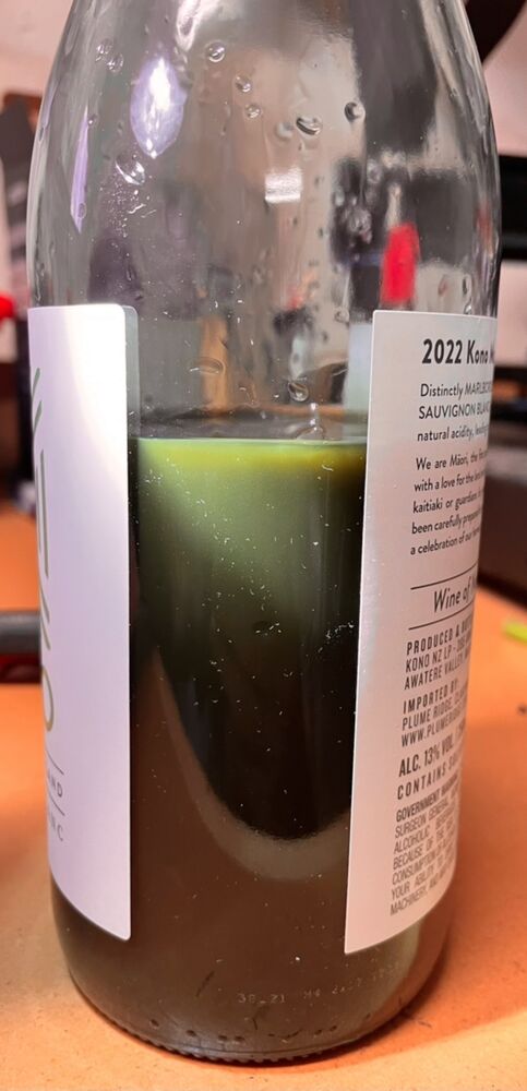

I changed the gear oil today and it was a bit…greenish. Who knows when the last time this was done but I'm assuming the green tinge is from 2-stroke oil mixing in with the gear oil via a failing seal somewhere? Would love input on what you guys and gals think from the pics.
Quite a few spiky bits on the drain plug
This little magnet was on the end of the plug. I assumed that was by design to attract the shavings so I put it back that way.
Slight green-ish tinge to the drained oil
Another look. Cabernet Motulblanc, Pacific Northwest Vintage, 2000?

are you running auto lube or no? I like to pull the clutch in and give a few blips of the throttle as I coast, brakes are cheap and easy to replace.
anyway, how much gear oil came out? it doesn't look that bad TBH. how's it smell? however, that looks like an excessive amount. the fuzz on the magnet is pretty standard. somebody put the magnet there, but no harm in that.

About 350ml came out. I forget when it took the photo, but I also squirted some extra new oil through there and let it drain to kinda "wash things out" so there might be a little extra. I did undo the fill bolt first so it would drain smoother and oil started draining from the fill hole before I got the drain plug off. Maybe PO overfilled it a bit. I just filled it up until it started coming out the fill hole and called it a day. Smelled like…old oil I guess? Not too dissimilar from when I'd do other bikes in the past.

if a significant amount came out of the fill and overall the consistency felt thin and smelled gassy I'd be concerned.
otherwise, don't pet the sweaty stuff and carry on.

So I adjusted the cable using using the barrel adjuster to where the harder pull starts around 4mm out front where the lever meets the headset and took it for a ride. It started out smooth, jerked on me once, then continued to be smooth. I checked again after my 10 min ride and ended up tightening it a bit more. I'll ride again tomorrow and see how it does. I have two dumb questions:
Firstly, after adjusting the cable I did what Ray and Greasy said, run the carb dry, then kick the kick starter with the clutch pulled all the way in. When I was in neutral, it kicked through with no resistance. When I was in 1st gear the kick starter wanted to drive the bike forward. Does this mean that the clutch isn't full disengaging or is that normal?
Secondly, when I went to use the barrel adjuster, the lock nut was up against the adjuster part, not where it mounts in the engine case. This is incorrect, isn't it? When I was done I snugged it up like this. Is this correct? (Barrel adjusters are black magic to me, I can't wrap my head around how they physically work…)
when you kick it over in neutral, don't touch the clutch lever. you want to see if it kicks through cleanly and smoothly, and turning over the engine-- ie. the cable isn't too tight and causing it to slip.
in 1st gear if you kick it over with the clutch engaged it may grab/slip a little bit on the first kick or two and try and move forward. that's fairly normal in that the plates don't immediately separate. as long as it doesn't drag when you're riding it then you should be fine.
you are right, the lock nut should be right against the engine on adjuster threads.
how it works: the end of the inner cable is at a fixed point, the outer is in a stop (the barrel) as you adjust the barrel is creates or diminishes the amount of tension on the cable by moving the outer cable in or out. think of it like the draw string on a pair of sweats.

Backing the nut out a number of turns allow you adjust the threaded portion. Screwing the nut back toward the case puts tension on the threaded portion and prevents it from moving. It prevents it from going out of adjustment. Otherwise, engine vibrations might cause it to spin out of adjustment.
