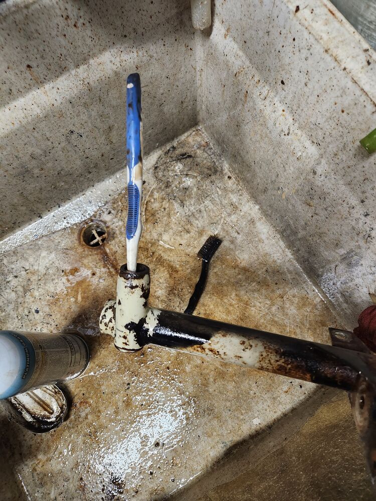

Wed, 16 Nov 2022 00:08:21 +0000 quote
What a crack up!
I managed to pull the parts out of the Evaporust, rinse with water, then scrub down with steel wool and a wire brush, and WD-40, Then rinse with WD-40 and wipe down.
The headset is now ready to be reassembled with grease...
Wiping the parts down
Ready for reassembly

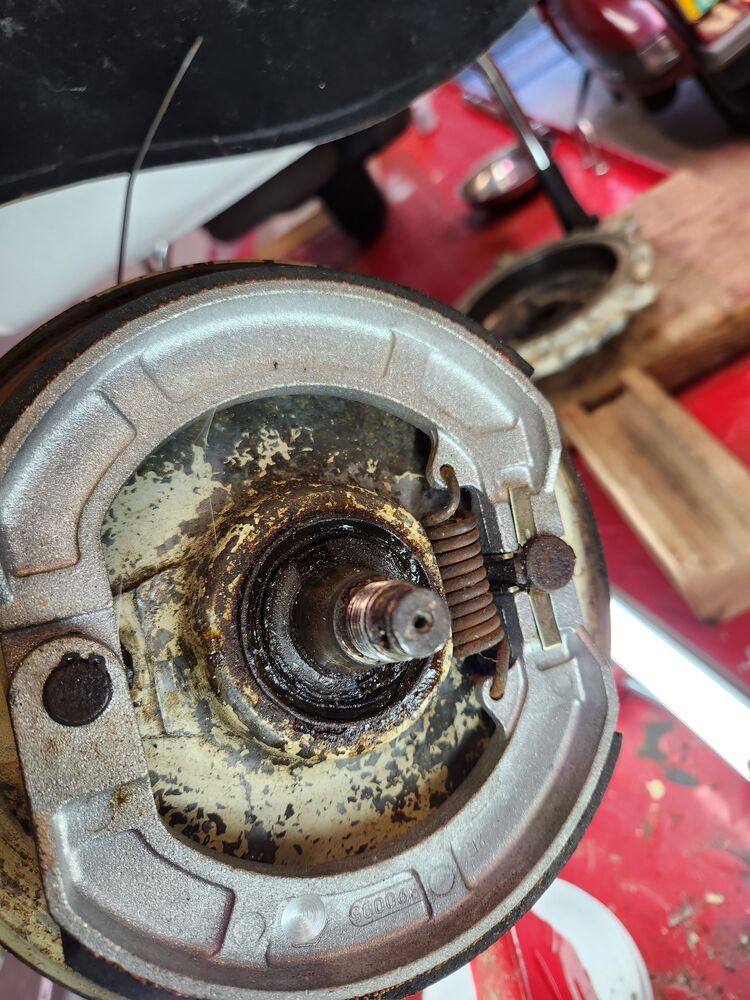

I downloaded the parts manual to see what parts we're missing in the headset. A number of parts, it turns out.
I did manage to put the shifter tube back together, and after 10 minutes of wrestling, got the aluminum cover off the fork. It was crusted on and probably hasn't been off in 48 years...
I'm going to pull the hub apart before placing another order...

Today was productive, and destructive....
I pulled the front hub apart, and it was a rusty, crusty mess, and removed the whole front steering column.
The shock bolt was frozen in the hub casting and the shock tube. I used penetrating oil, cleaner, and heat. I started by tapping, then escalated to pounding and still nothing. I put a wrench on the bolt and FINALLY got some moment, and the two prominent points on the shock tube promptly broke the casting of the swing arm. F$&k! Out came the pipe wrench.
Between the pipe wrench holding the shock tube, and the wrench turning the bolt, I managed to get the shock tube out, and pounded the bolt out of the swingarm.
So now I don't know if I can use this swingarm. I'm bummed ...
This thing is crusty and flattened out
Got the axle and bearings out
The brake lever barely turned! It was froze in the housing. I had to tap it out. Even with new shoes the brakes wouldn't work
Wrong nuts and bolts for the fender. I'm just gonna pull it
Snapped the spring mount off, it was so rusted
Clump of rusty bearings from the pivot
A block of rust in there
Swingarm with brake and pivot pins removed
Disaster. I finally got that dang bolt out, but look at the carnage. Do you think I could still use it?

e parts is the next order of business. I've been degreasing the bearings and scrubbing the 59 years of gunk off these parts.
I'm soaking some in Evaporust that have some rust, then wire brush. I'll break out the Dremel with the abrasive heads tomorrow to take the next layer off. I haven't found someone in town yet that does vapor blasting, but I'll keep looking.
Jeez, these parts are gunky
Cleaning up the steering tube
The speedo gear was frozen in the housing....
Lots of.parts soaking in Evaporust
