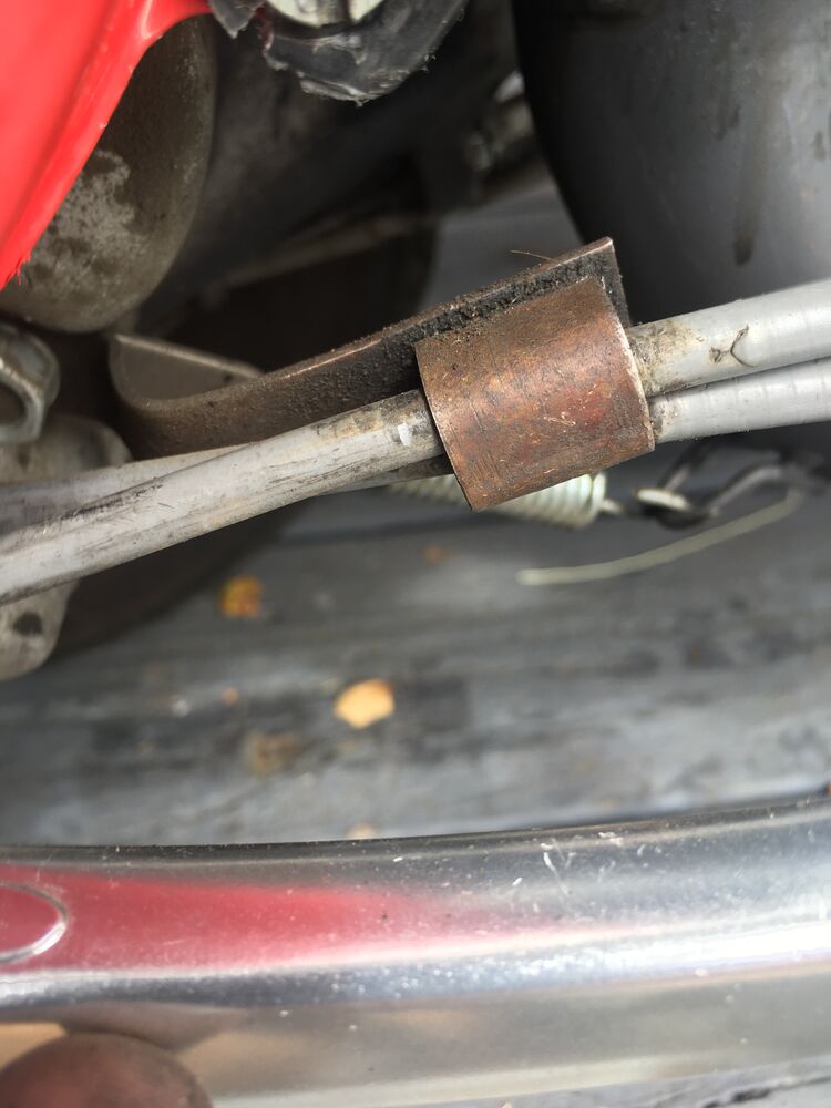

My shift housing on my VNB is touching on the exhaust and melting slightly.
Is my housing too long or did I route it incorrectly?
Thank for your help.

pull the locating bracket up and out a little and that should give you the clearance you need.

This thing?
Thank you Mr G

That did the trick.

No, that ain't right. The cables go behind the pipe. It should be more or less a straight shot from the frame. No big wavy bends in the cables.
oh duh! he said it was a small block! gah, I'll wake up here in a bit.
yeah, socal is right- behind the pipe on the small block.

Thanks SoCal.
It looks much better now.
