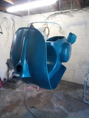

Hey everyone its been actually some years since I last posted anything on this forum, I hope everyone is okay and well
Since my last postings on this forum I have been building an SS90 Replica which has been fun and scary at the same time, I have always hated the idea of cutting any vehicle frame let alone a classic Vespa,
I know some of you will say I am stupid for cutting but its done now so no going back

I guess I'm in the never cut camp, but it's your scoot and it's nice work with excellent results. People often maul stuff when they modify it and you obviously didn't.

All my life I was a never cut person and even now with this cut job i felt that I did the bike a disservice but at the same time I really like the outcome so difficult situation for me.

I think it looks great. It's a scooter, not a monument to Italian engineering. Maybe if it was the last one on earth.

Nice scoot. What model frame did you start with?
I have pretty much that exact bike/setup. I bought it already cut down, so I didn't have to make that difficult decision. I also swapped out the VSP road for a banana pipe.
