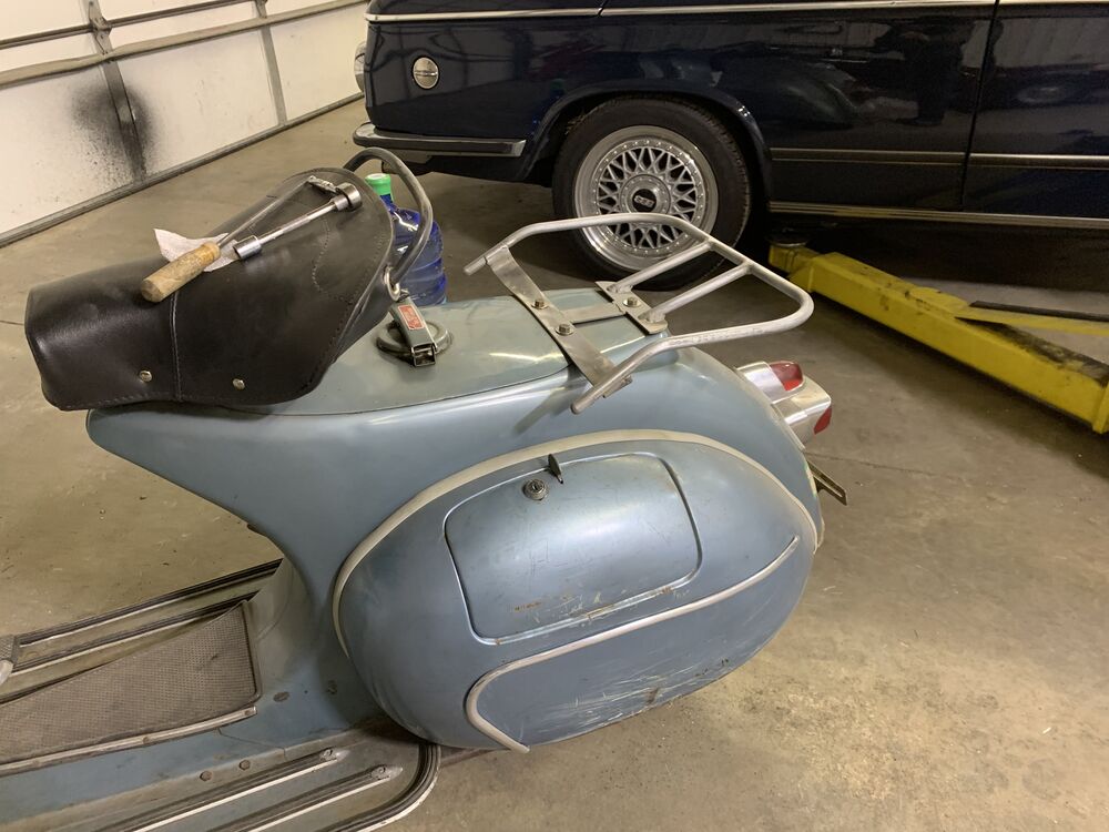

I'm brand new to the world of Vespas (and scooters in general) but I'm a veteran old German car restoration mechanic. I didn't like the "non-removable key" feature of the lock on my new 150 VBB either...so I harvested a same-style lock off one of my old tool boxes. Problem solved. These kinds of locks (with spring clip retainer) are super common. Mine has a slightly taller bezel, which is fine by me...and it was FREE, so...

Bezel is about 3-4mm tall vs 1-2mm... but it works great and looks "period correct"-ish.
