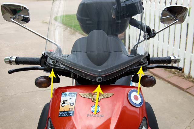

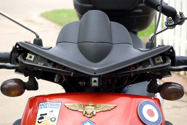

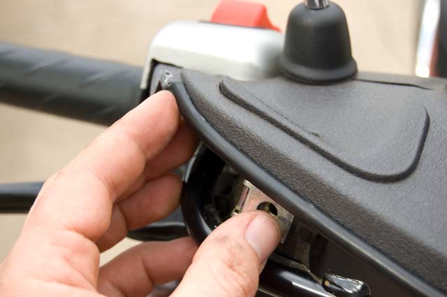

One of these on either side to remove in order to get the headset off.....

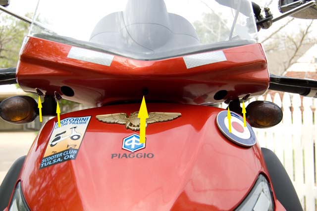

five screws on the front in order to get the headset off

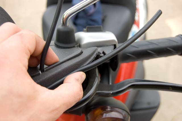

Givi provides a nice rubber strip to protect the area of the old shield....
It is longer than required, so I trimmed it.

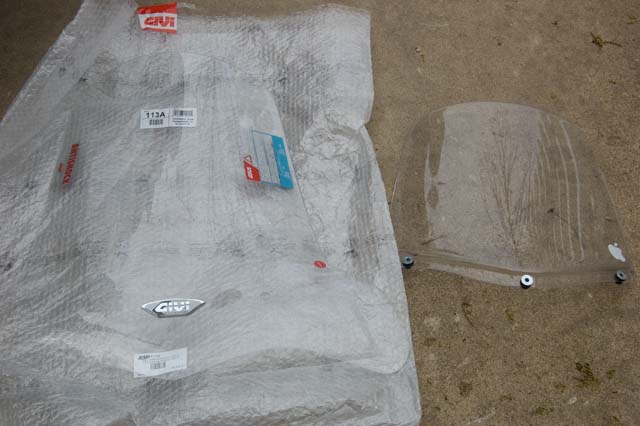

The old shield and new side by side...

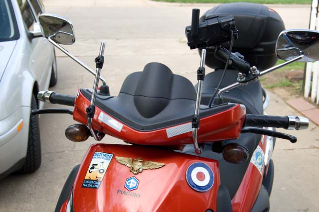

The instructions for the support bars and shield install were surprisingly good. Here are the bars installed....It is VERY important to ensure the bars are fully set into the receptacles before tightening....

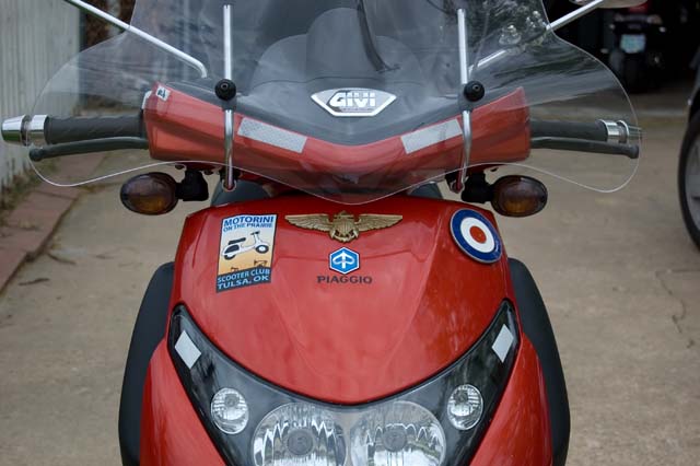

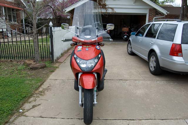

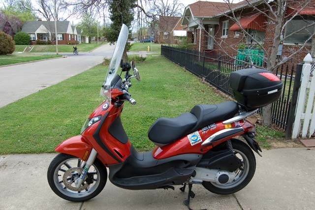

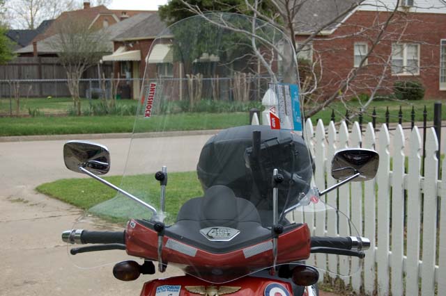

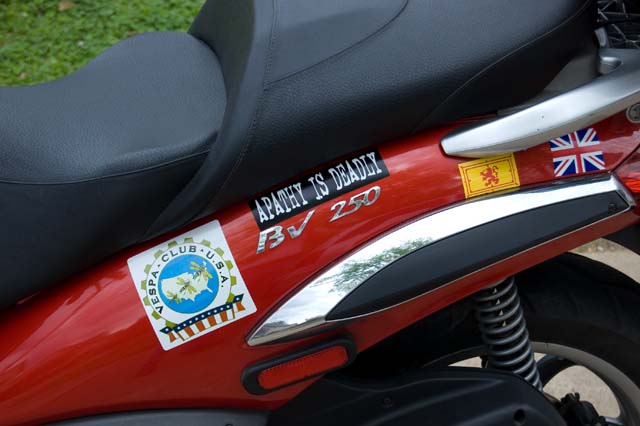

Full views of the scoot with shield :)
So here are some pics of the entire scoot - I am also attaching a shot of my view through the new shield - it is about four inches taller than I thought it would be - but riding was smooth AND QUIET - very nice! I hate the wind noise and this will make my rides quite peaceful - I noticed that I heard a great deal more of the traffic noise when I tested it.
Camera at my eye level.
Scoot now from the front
close up :)
close up :)
left side....
left side....
right side ;)
right side ;)
left close up :)
left close up :)
and right....
and right....
