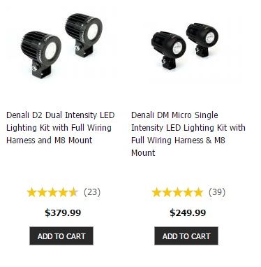

Sorry for the late reply...
As I stated earlier, or other threads I have done the Dual H4's (Both High / Low Beam are on), and had huge issues with power on the MP3/250, where I had to upgrade the Battery to the EarthX ETX-36C which gives you a lot of extra. I am back to running stock now... The EarthX Battery comes in handy to run Heated Gear.
I mentioned the Twisted Throttle Website, and see the picture for the LED's they sell. I would mount them probably using the two bolts holding the ABS to the bottom of the Radiator with some sort of Bracket where they would be upside down, pointing forward. It would be easy to wire them into existing wiring. I have friends using this on Honda's, and other Bikes, and they are very Bright.
They have some M8 Adapters that makes it easy to mount on other bikes, but I have not had the time to look at this yet.
Take a look at the other thread ".... Driving Lights" that kilovictor posted.
Keith

OK thanks for your reply, Keith. I did see the other thread by Kilovictor. It looks real good. But man! I didn't realize that those lights are that expensive.
At any rate, I already went ahead and did the headlight modulator option with the Kisan PathBlazer on my high beam light (in addition to removing the spring). I don't do much night time riding, so the headlight modulator during the day seems to serve my purpose well. I think I paid $75 for my Kisan PathBlazer on eBay.
Kilo got his off of amazon for a lot less money. I think he told me something like $35 each or for both.
I like the stuff from twisted throttle but boy the prices are sometimes way too much. I would never pay that for led driving lights myself.
OK, that's much more inline with what I'd expect. In fact, $35 for each is good, but $35 for both would be great!
