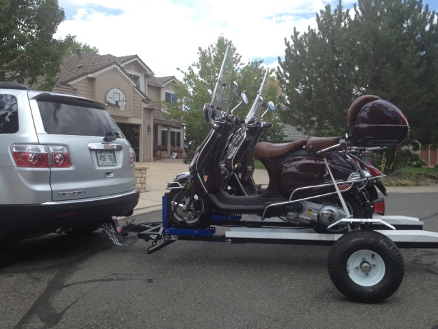

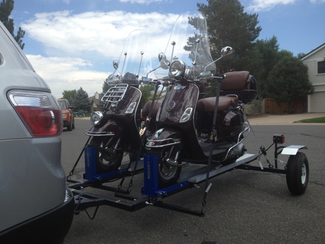

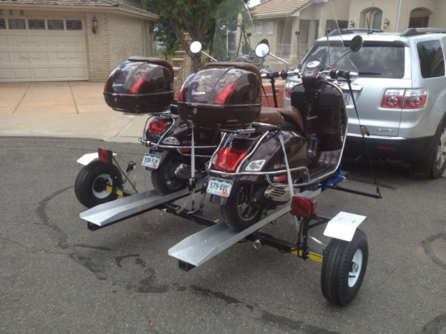

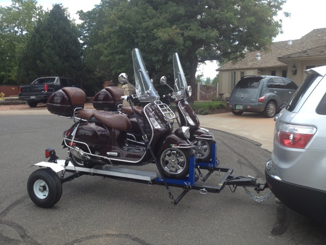

Here is the Trailer In A Bag Dual setup for transport of my GTV and LXV. Condor Scooter Chocks grab the bikes wonderfully. Comes with a ramp.
Plans are bring them to San Diego, Arizona, New Mexico and other warm-weather spots as Colorado cools. Will be inspected and licensed this week.

Nice! I love my TiaB. I have the single-rail model but there are times when a dual-rail might be handy. Have you tried just one bike on yours (with both rails) or is it fairly easy to convert back and forth?

Converts very easily to one. Pull 10 pins and put 6 back in a different configuration. Comes with a different head, too.

We have the dual TiaB and yes, I've used it with just one rail. Very easy to configure it for either one or two scoots.

For long trips like you suggest I would suggest the following:
Get one whee/tire for a spare, two would be good. Those tires are turning twice as fast as your car tires, and they are poor quality to start with (there are no high quality ones in those small sizes so don't look.) Harbor Freight has them, and I have never seen better ones.
Get two complete sets of wheel bearings plus the tools and jack to replace them on the road. And know how to do it (easy.)
Install Bearing Buddies and Bearing Buddy Bras and have a loaded grease gun with you.
Every time you stop feel both bearings. They should be the same temperature. If one is hot give it some grease, or swap it out. The third or forth time you do it it won't take as long.
Don't let this discourage you. Light trailers with little wheels are OK, you just have to live within their limitations.

With the axle so close to the back of the trailer I think you might be better off if both scooters had the back tire directly above the axle instead of one being in front. It might be fine the way it is; but that was my thought when I saw it.

I found it under trailerinabag.com apparently bags are better than boxes. I see it says that you just load the bikes and it will be set for tongue weight; but every single picture of the 100 listed under "Photos" showed the back tire above or behind the axle. But I also see in the dual photos that they have them staggered so one might be ahead of the axle.
It's probably fine; but if it feels squirelly I would check the tongue weight.

Interesting advice...
-- Spare tire is a good idea, but I got one more to deal with odd events that might require a tire remount.
-- Pack those bearings? This from TIB's FAQ: "These trailers do not come with any type of fittings on the wheels. Pack the bearings full of grease but the housing should not be packed full. Bearing manufacturers recommend that for bearings being used at sustained high speeds, the bearing housing should be packed with 30% to 50% air space in order for the heat to dissipate. Installation and use of a grease fitting may cause the bearings to overheat and will VOID the warranty."
"The bearings are tapered roller bearings similar to the bearings that are in your car or bike and are rated at 7500 RPM. This size tire at 7500 RPM is the equivalent of 360 MPH, certainly not recommended. However, this should answer any concerns there may be about the bearings or about the tires turning the bearings too fast. The trailer pictured on our web site with the black and white bike has over 150,000 miles on it in just the past five years and still has the original bearings in it. Most of those miles are highway miles."
-- Harbor Freight is not exactly my standard for quality.

Those trailers are of decent design and work well but I would definitely upgrade the wheels to at least 12 inchers before I hauled my scoots with it. No way I would ever get on the highway with those small wheels. They are meant for shorter, non highway distances. I can't say it enough to upgrade to larger tires for the distances you are planning to cover. Taller tires make a huge difference on the road, remaining a lot cooler than those tiny ones will be. The taller the better. A 4.80x12 is the absolute minimum I would use, A 5.30 x12 tire is even better and the size I use on my trailer. You can easily drill new holes and move the mudflaps up on your trailer to accommodate the larger wheel size.

Good tips, VEZPA. Glad you are experience, and care to share.
- Will get that easy jack
- Will upgrade tires from current 5.7 x 8

Re: Transporting GTV and LXV - Trailer In A Box Dual
sharpcolorado wrote:
Here is the Trailer In A Box Dual setup for transport of my GTV and LXV. Will be inspected and licensed this week.
In your photos the tail light with the license plate holder is on the right side of the trailer vice the left side. Was this just for photo purposes? Otherwise, and unless you switched the holder or re-did the wires, your trailer turn signals will be opposite the towing vehicle's.
Also, if you did the LED upgrade, your lights are probably not DOT legal and you won't get sufficient illumination onto the license plate. TIB seems to be a pretty well made product, but just sticking a couple of LED bulbs into the sockets doesn't answer the mail. If a person wants LEDs on their TIB, the best solution is to go to the auto parts store and look around. Companies sell DOT-approved LED trailer light sets in exactly the same form factor as the stock TIB lights.
(Side Note: Whoever made up my TIB wiring harness completely dorked up the connections. It was only when I installed the proper LED light set and connected the wires properly that things worked right.)
With regard to the tongue weight...You can check this with a bathroom scale if you have a reasonably flat surface -- no need to speculate (like, ahem, a few folks here). If your tongue weight is in the manufacturer's 120-160 lb range, you're good.

sharpcolorado,
It looks to me like your trailer has too much tongue weight and the axle should be a little more forward to divvy up the weight a little more.

Those are the factory mounted/welded chocks which are in the same place as mine which is over 4 years old. Never had a problem with tongue weight on a class 3 hitch.

Anyone know what the tongue weight is with two scoots? Like Richard, it looks weighted to the hitch to me.

No idea what the tongue weight it but I could easily move the trailer around by hand and I'd have problems if it weghted the 160lbs mentioned in the 120-160lb referenced earlier in this thread. Granted that was with a Burgman on it not two Vespas which is only slightly less than the two Vespas pictured combined.

Weighed the loaded configuration as shown in the OP before disassembling the trailer.
2012 GTV and 2012 LXV
Tongue weight 195 lbs loaded
Tongue weight 65 lbs empty
Trailer gross weight empty 315 lbs
